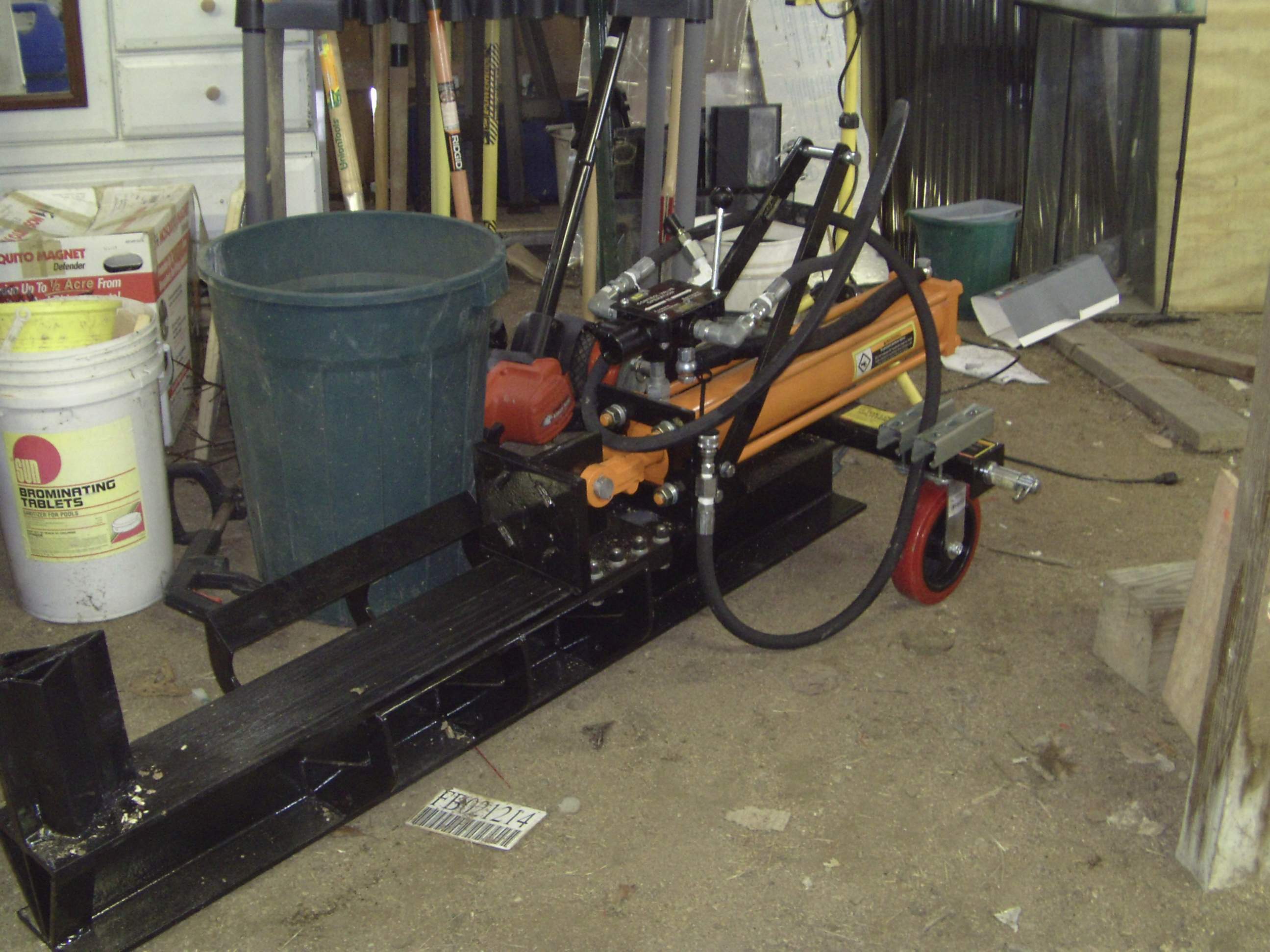

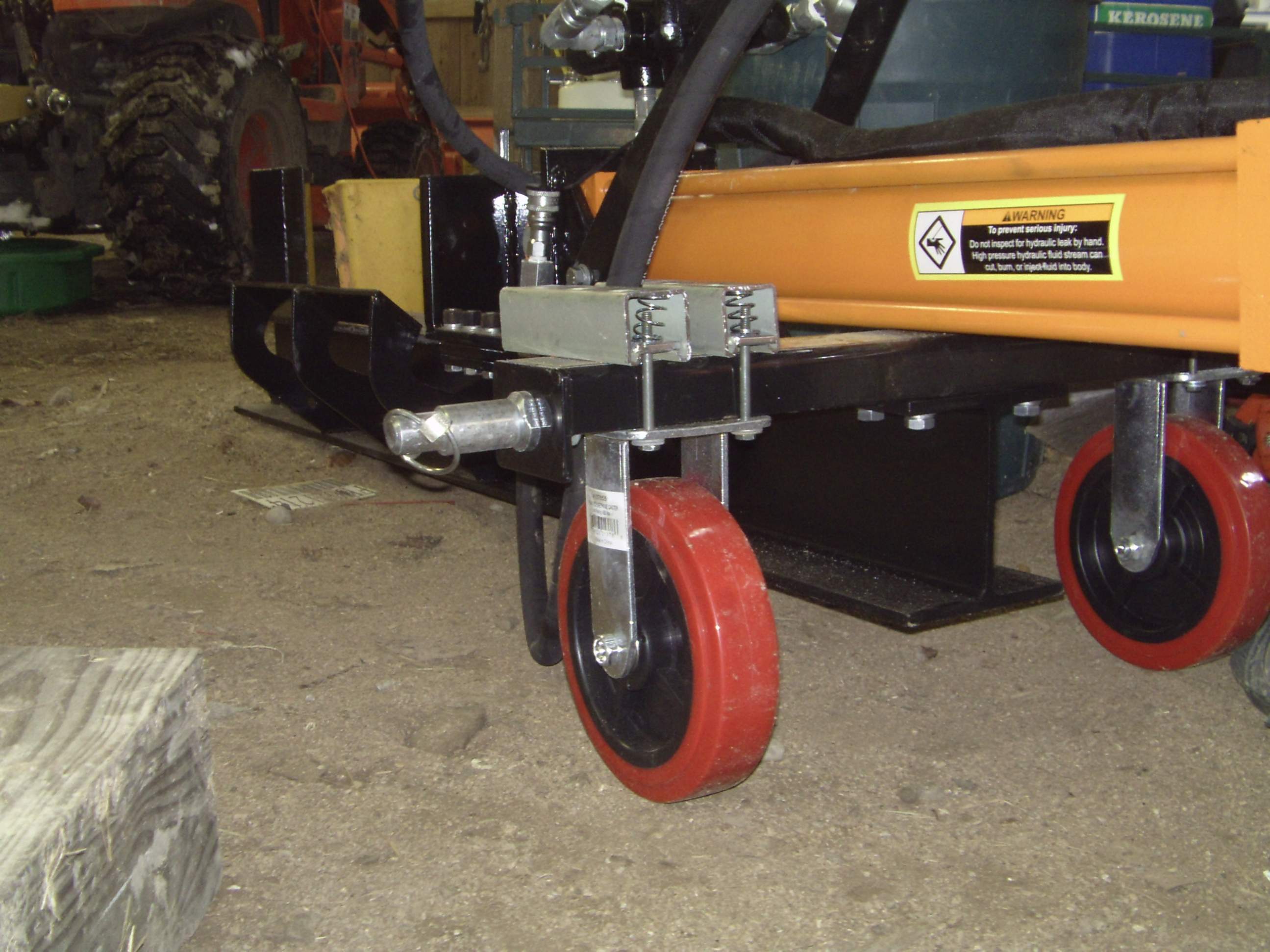

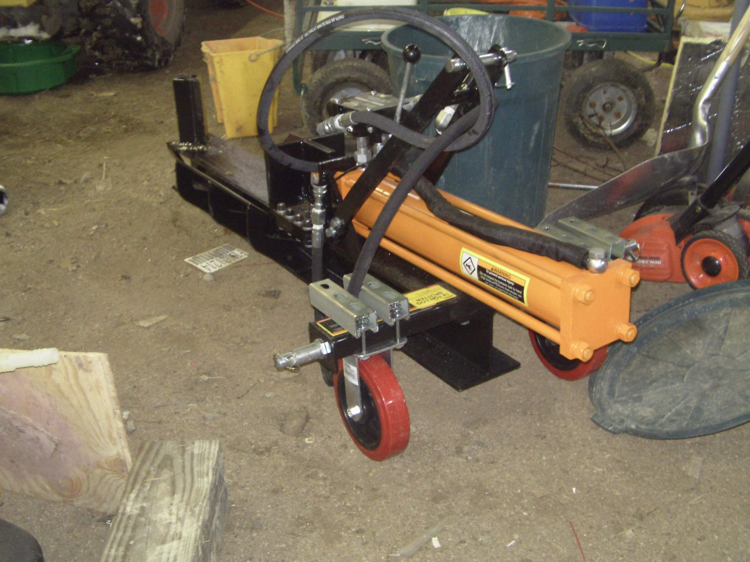

Here are some photos of the 8" wheels attached. I didn't want to tie up a hand truck for moving it around, so I attached wheels to the cross arms and can dolly it around the barn now.
I got the solid wheels from TSC on clearance, but Harbor Freight is also a good source, and usually cheaper. Get 8" wheels to ensure that you get enough clearance below the main splitter rail.
Each wheel assembly is held in place by four (4), grade-8, 3" x 1/4" bolts, fastened into Unistrut (AKA: Super Strut) channel that I got at Home Depot. You need about a foot of channel for each wheel, and four 1/4" fastener clips (they have the threaded holes in them.) I also put some washers in to size the bolts to the span.
The neighborhood is having a "cutting-bee" tomorrow for a neighbor that broke his leg in the woods and is out of firewood. I'll be out there with tractor, splitter, and chainsaw to give it all a test under fire!

Looks like you are set. I've been burning wood for a couple of weeks that I split with my new splitter. It's from trees that have been "standing firewood" for several years and don't require drying. It sure is nice to have your own splitter. I like your wheels. Since they are on the tractor end, you can still extend yor toplink and get the splitting saddle low enough to make loading big round easier.
   / Harbor Freight 3-point log splitter
#24
The splitter got a trial by fire on Saturday at a "splitting bee" for a neighbor. It really proved it worth since I could take the splitter to the tree, instead of having us having to drag large rollers to the splitter. You're right about having it low being easier too; some of the rollers to two sets of hands, and it was nice not to have to lift them high.
Hoses got warm, but nothing got hot. It was around 20 all day, so plenting of cooling. I'm not sure that I would work it that hard in the summer, but I don't plan to make wood in the summer. I'm a happy camper!
The wheels are working well. They don't touch ground when the 3-point is fully lowered, so they don't get in the way. I put a roller or wood block under the far end for support for when we drop a large piece on the splitter.
I lower the back end even further by lifting the front end by raising the front end with the FEL. That way I can just roll the splitter up to the hitch and hook it up. I comes right up when I raise the FEL and drop the front end. The BX looked so tiny compared to all the Ag tractors at the splitting bee, but she did what she was supposed to, and that's all that mattered.
