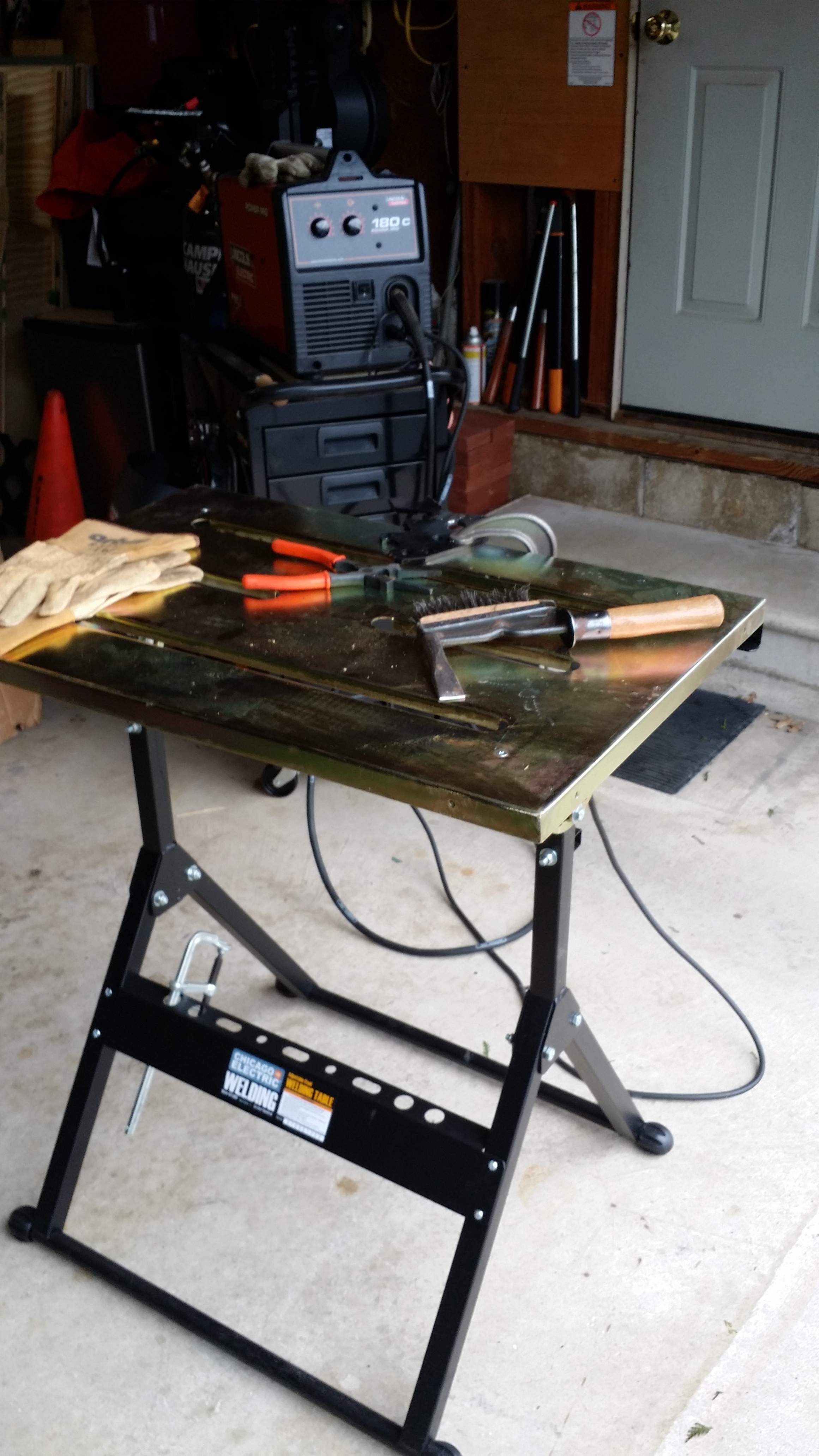

I just picked up the Welding Table. Seems like its pretty solid to me. The stupid plastic 'handles' will probably get replaced with HF 13mm wrenches welded on the bolts when the break :) (or even a piece of flat stock).
I did just find this that may prove to be useful with the table (although some minor modification may be needed for it to work right)
9" Drill Press Locking Clamp
As for the cabinet.... I sure wish they had that back in December/January when I was buying carts for my welder and plasma cutter :-( I would have got at least one....
One of my handles stripped the first time I used it. Took them both off and will either weld something to the bolt or replace with a handle from Reid Supply or McMaster-Carr.
Other than that the table seems pretty good. Used it for the first time today on a quick weld job.

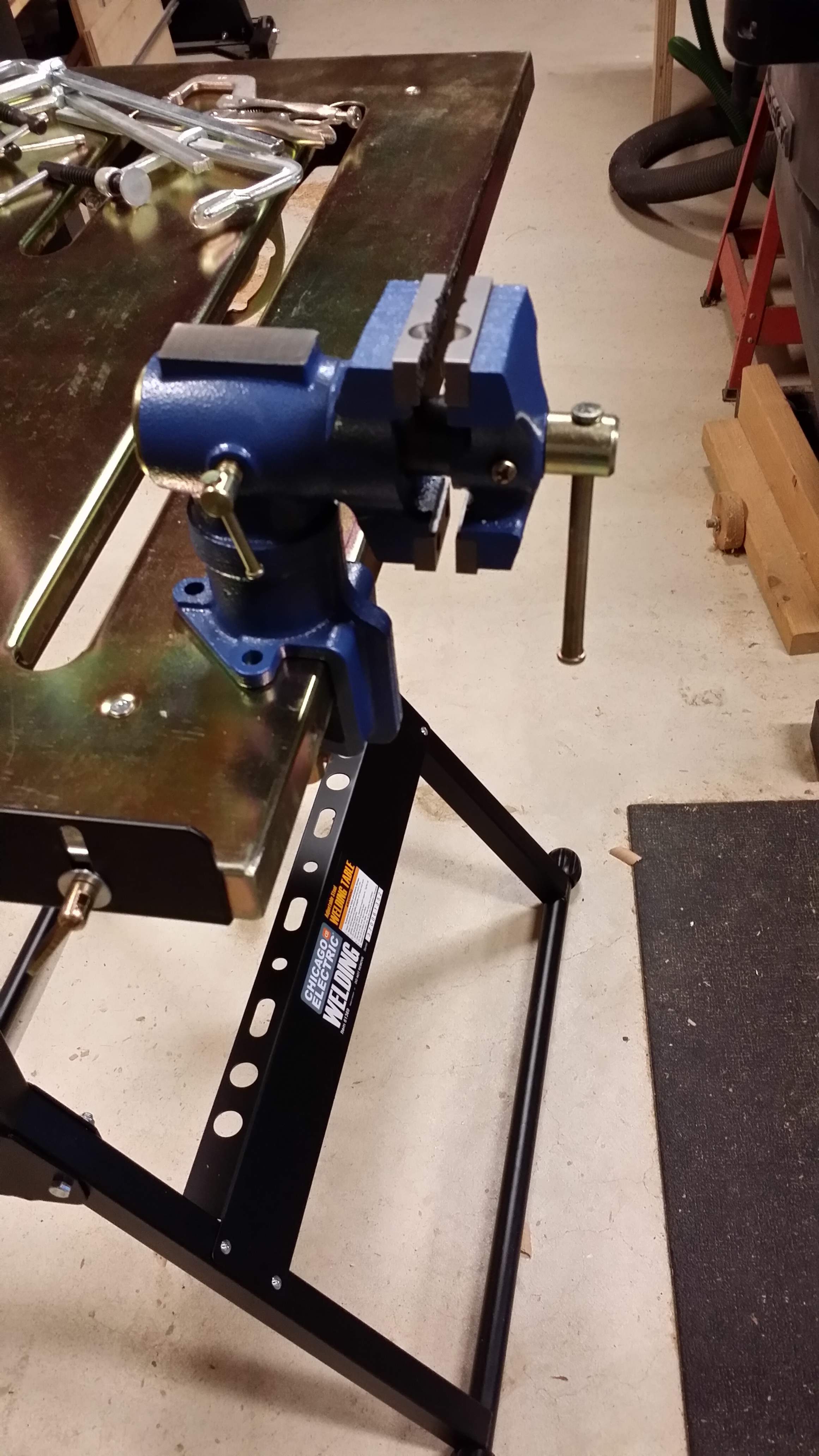

When I bought my table I also picked up this cheap vise for $17. It's great for holding small pieces for welding or grinding and since it rotates in both axis you can position the work where you want it. Its made to clamp to a thick table top but I used a 1-1/4 nut as a spacer under the table to make up for the thin metal top. Works well and very sturdy.
   / Harbor Freight copies StrongHand Nomad welding table...$59 #67
2-1/2" Table Swivel Vise
That's a good little vise. Well worth the money($18 w/coupon).
I bought one about 2 years ago and mounted it on a shelf in my garage. I never thought about putting it on the HF welding table I just got. But I can see where it would be very handy there.
Thanks for the suggestion. :thumbsup:
