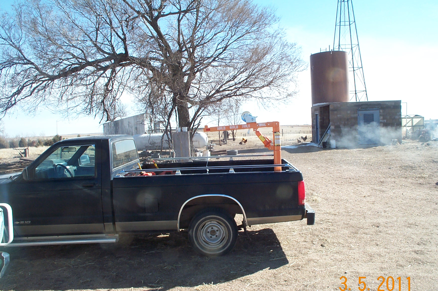

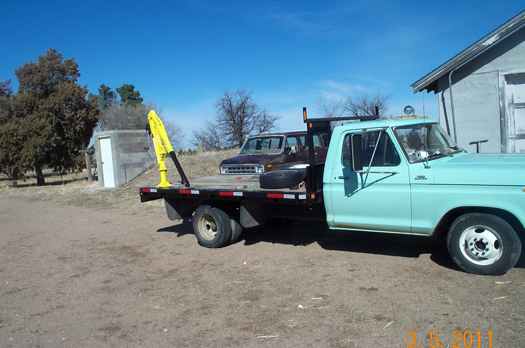

I replaced the winch on mine a few months after I bought it, and knew when I bought it that I most likely would be doing that by the reviews on the HF site, I replaced it with a Dutton & lainson there is not hardly a comparison between the two winches, my harbor freight is on the S10, (my other Hoist Vestil Winch Operated Truck Jib Crane on the one ton truck) has a US made winch that has built in brake if you let go of the handle it will tighten up and stop, the problem is you have uncrank the winch to let the cable out, and working by ones self is not normally the easiest thing or the most convenient thing to do, but item for item the Vestil hoist was worth the money difference and the extra shipping, but because the truck it is mounted on the HF gets used more,

I payed about $100 for shipping, on the Vestil, unit,
What I am saying is that the vestil unit is more than twice the machine, the jack is considerable better IMO, the steel is heaver, it has bearing in the pivoit, the winch is far superior, and apears to be American made, the hoist I think is American made, (there jack I do think is import tho), the cable is heaver, the sheves are real sheaves, and not jsut a small roller, and on my one tone truck I think I made the correct choice (I did add a longer cable on the unit tho as it only had a 10 or 12 foot cable on it),

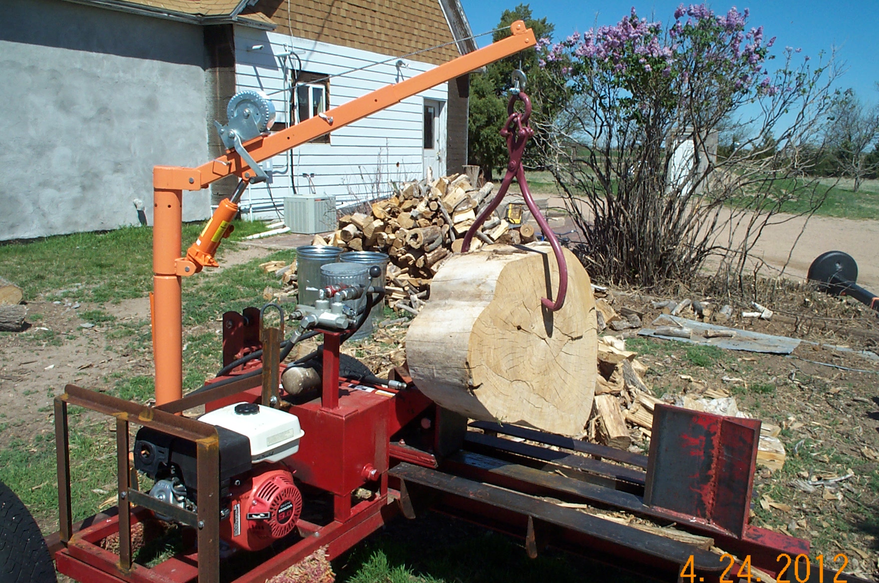

I personaly think the HF unit should be rated at halve of it given capacity, not really knocking the HF unit for the money, as I have two of them one on the S10 and one on the log spliter for lifting large rounds,
I built up the under of the S10 considerable for the mounting of the HF hoist and the vestil unit I added some 3/8" angle by 3x3 between two bed members,
one thing I would like add on both trucks is a "out rigger" that one could release easly so once some thing is loaded it could be released and put away, (maybe a trailer jack with the round piviot atached at the bummer) to help supprot if lifting off to the side of the S10, the one tone from time to time I have used it to pull posts with, and even tho the one tone is a lot stiffer than the S10 it could use some thing at times,
