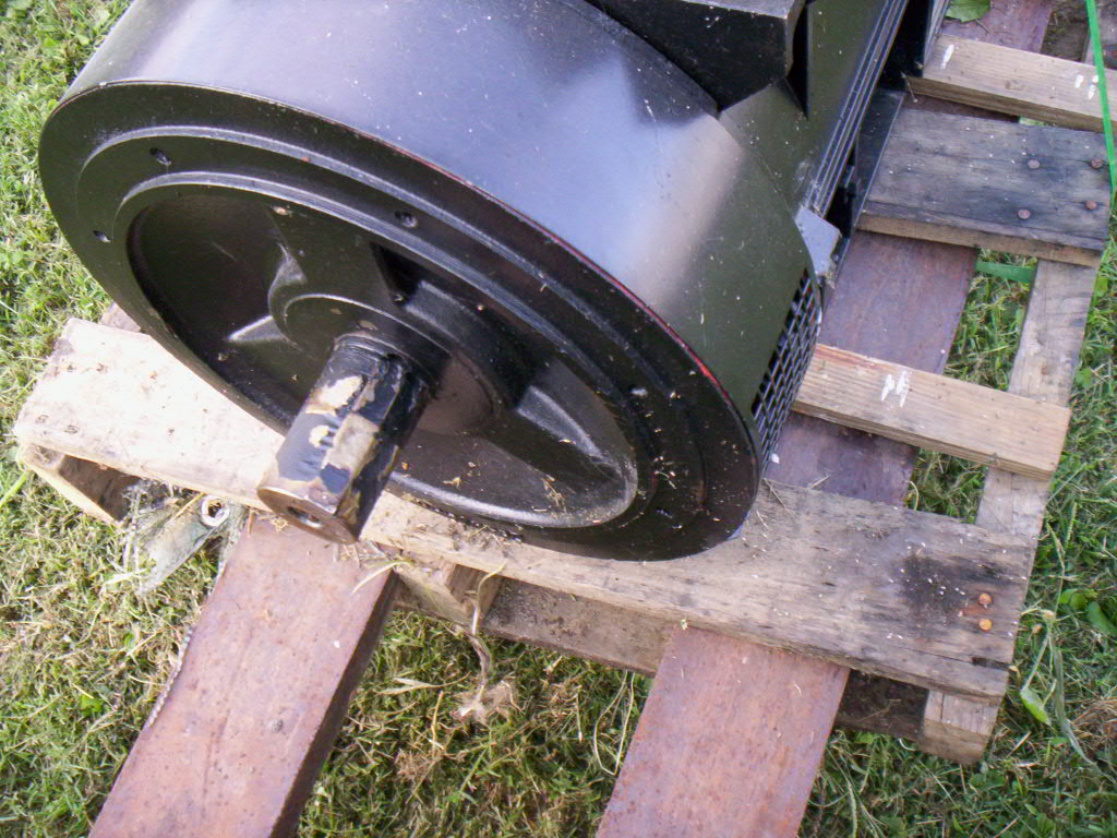

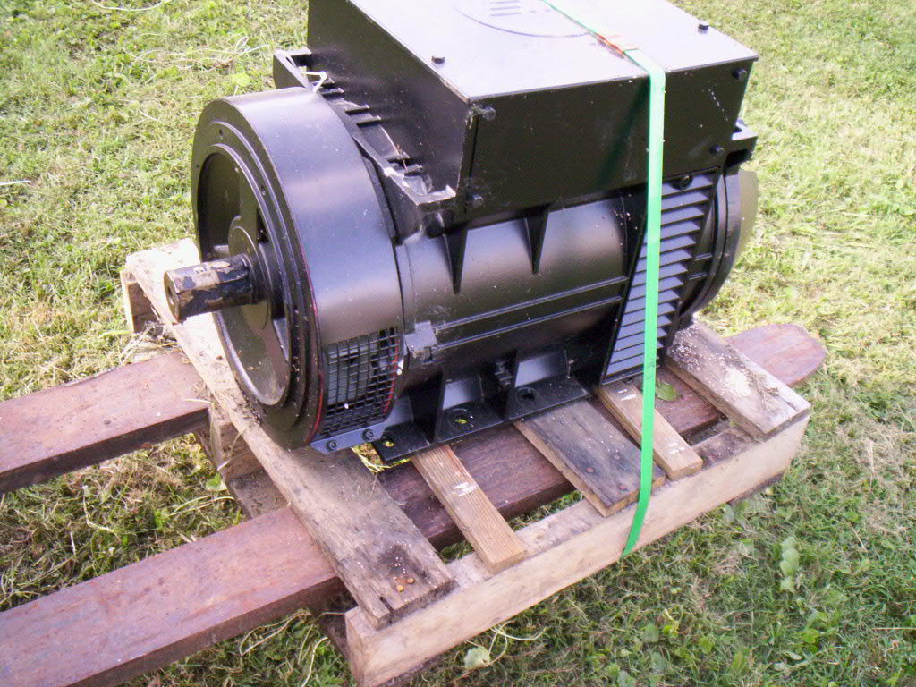

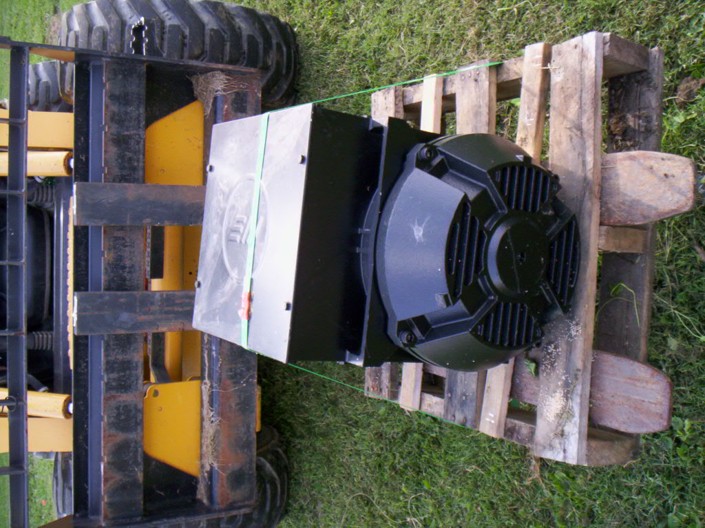

I have a 20 or 22 kw Marelli power head. It is brand new never used. If you are interested please contact me though the message boards here. It is a two bearing (timken) meant to run 24/7 365 for 30 plus years. It is one of the same outfits Carnival Cruise line uses. It is capable of producing 3 phase 480 / 240, single phase 220 / 120, or 3 phase 208 and 110 and the same time.
nice gen head but 3 times the output i want or need - i've got a little 2 cyl 13 hp honda engine that i'm rebuilding for this gen project
