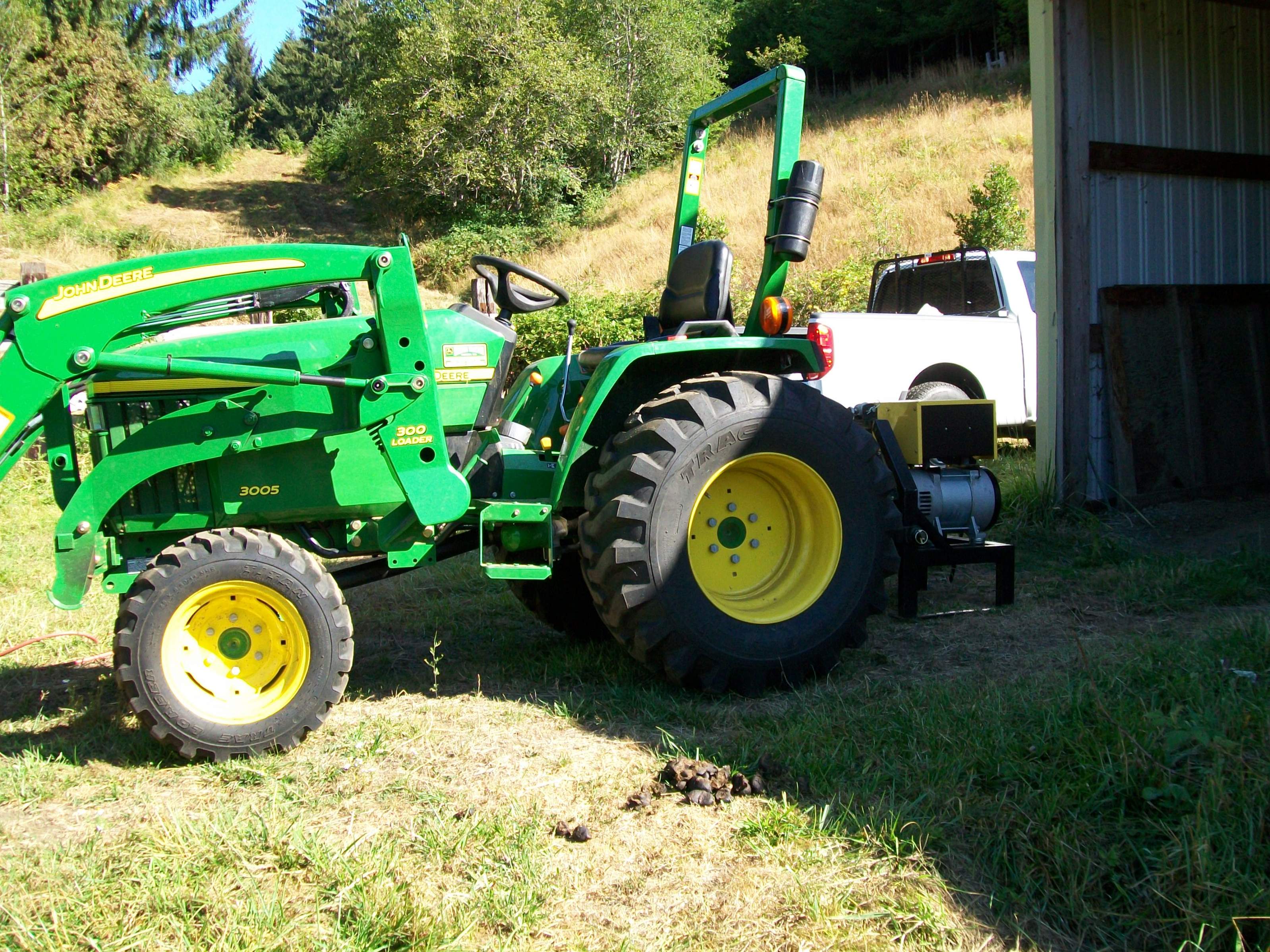

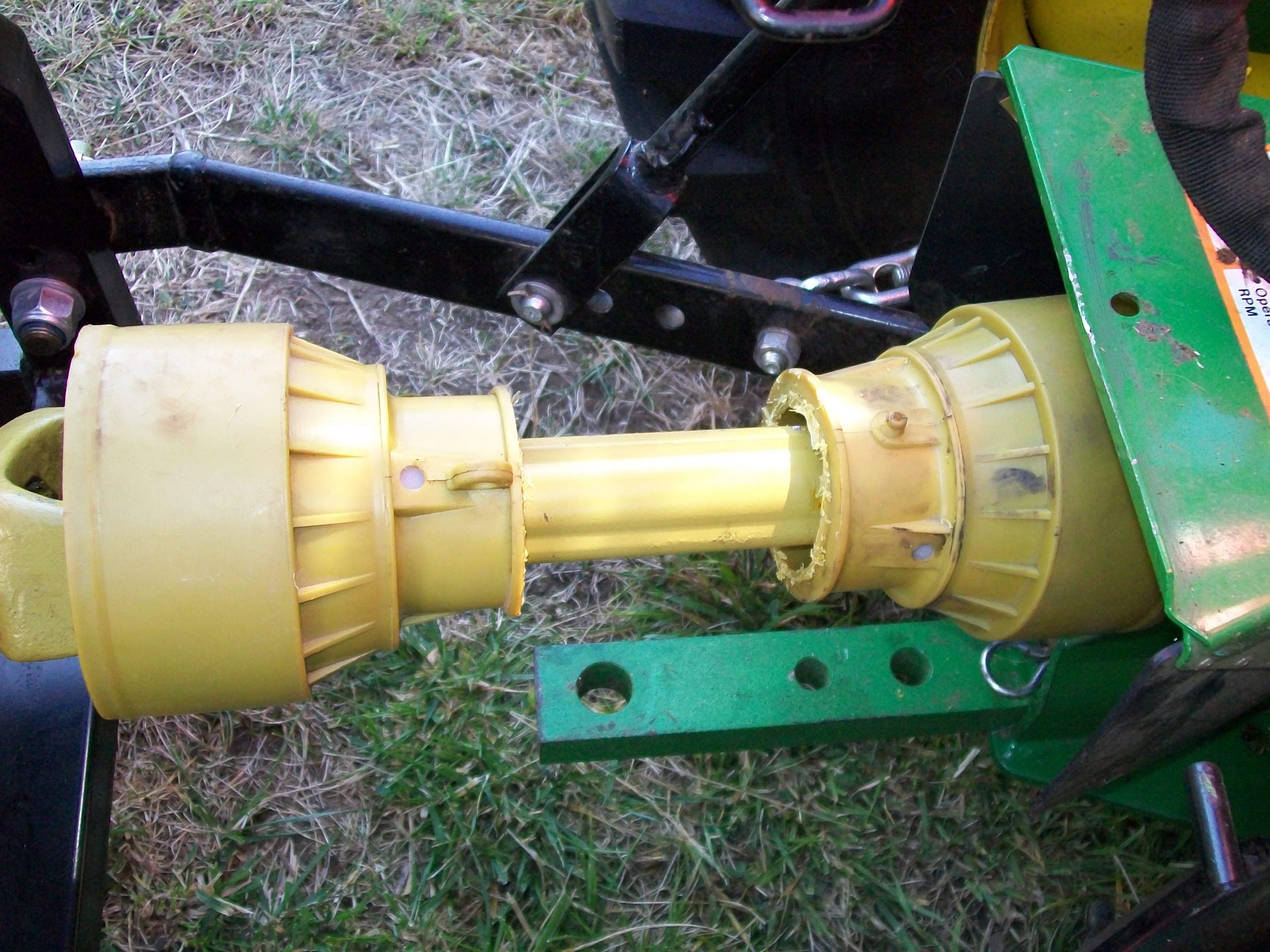

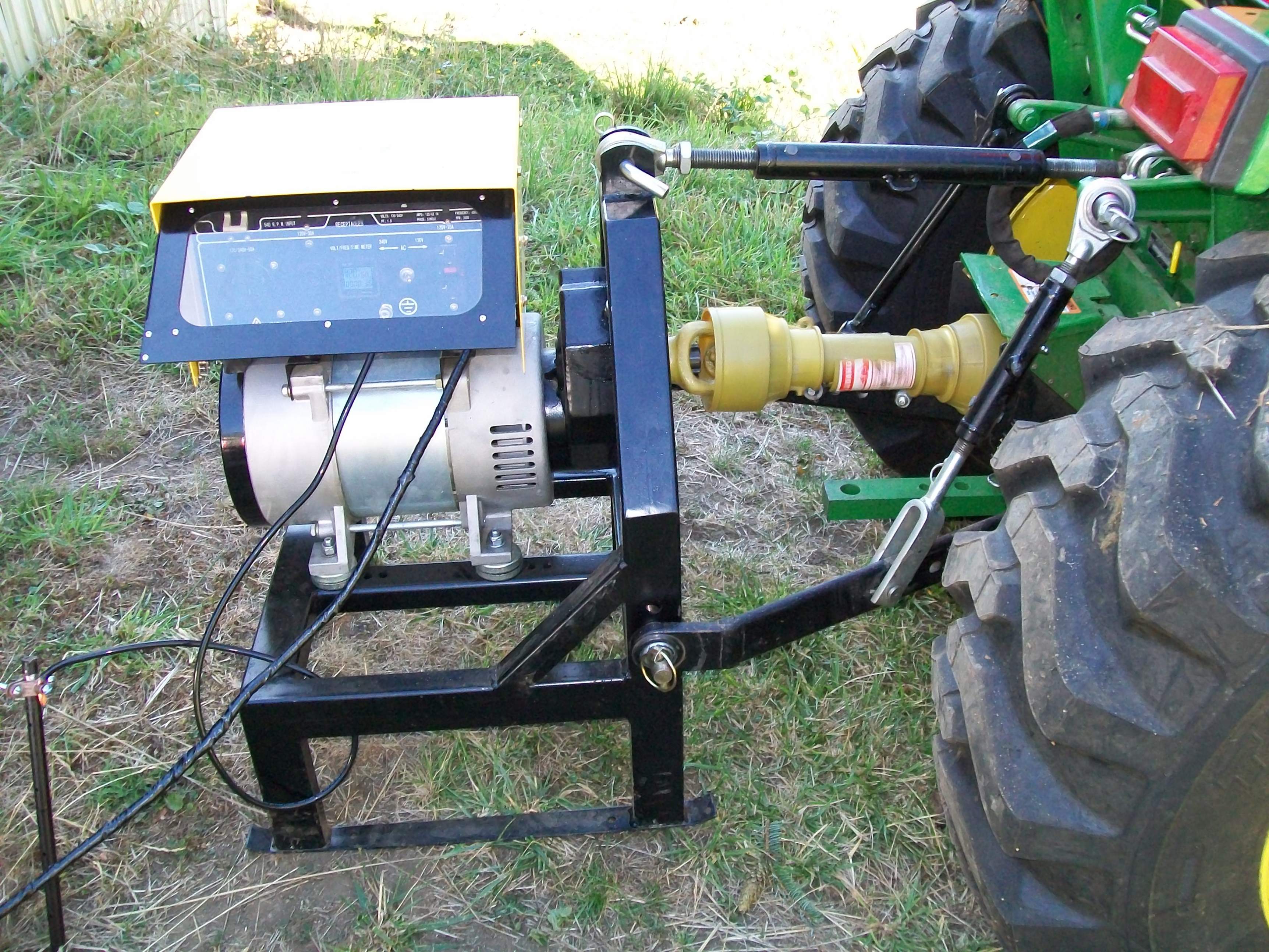

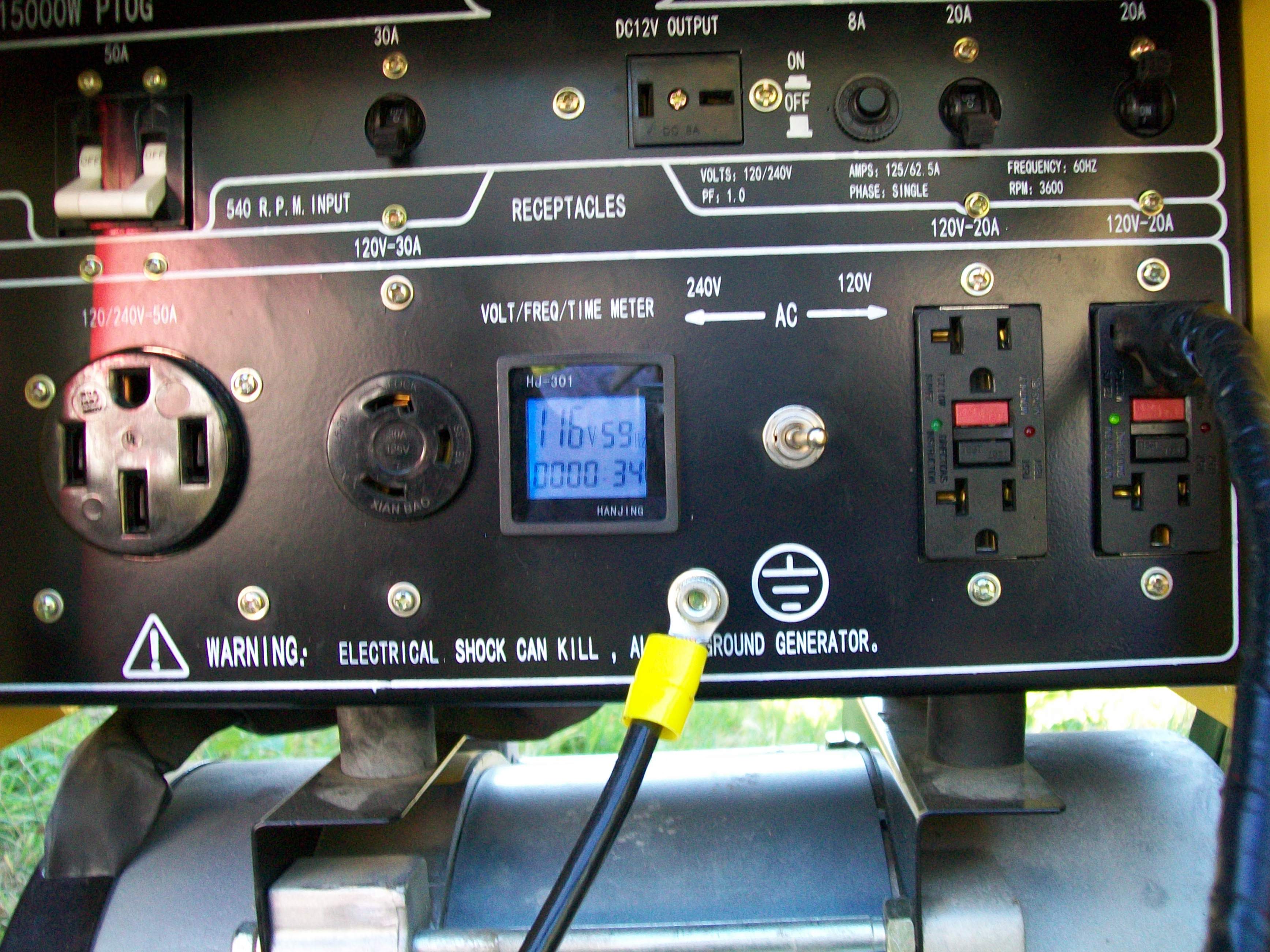

The Harbor PTO Generator works great. I now have electricity whenever i want it on the tree farm without having to maintain a small engine. Easy to move on the three point. I'm in it, including extended warranty, for $1063.28 (see my last post for the deal I got). The gear box for the generator sits pretty close to the tractor so the PTO shaft (comes included) is quite short. It takes a little jockeying to get it connected, since when leveled with the PTO there isn't enough clearance to get the female end of the shaft over the spline. Fortunately by putting it at full lift there is enough clearance. A bigger tractor with longer rocker arms would not have that problem. To use a smaller tractor one may have to cut the shaft down a little. It's a real solid unit. It's easy to adjust the the throttle since it has a cycle readout. It doesn't quite require the RPMs to produce 60 cycles that my tachometer rates as 540 out.. That is probably a good thing since less fuel and less wear and tear on the tractor. I have attached some photos.

From your pics, it appears there are multiple mounting holes to choose from, in the frame, for the generator to mount to. I wonder if it can be slid back to make your shaft space a bit more generous???
   / Harbor Freight PTO Generator #20
That generator looks exactly like the one I bought with "Torq" decals on it. They must be from the same manufacturer.
