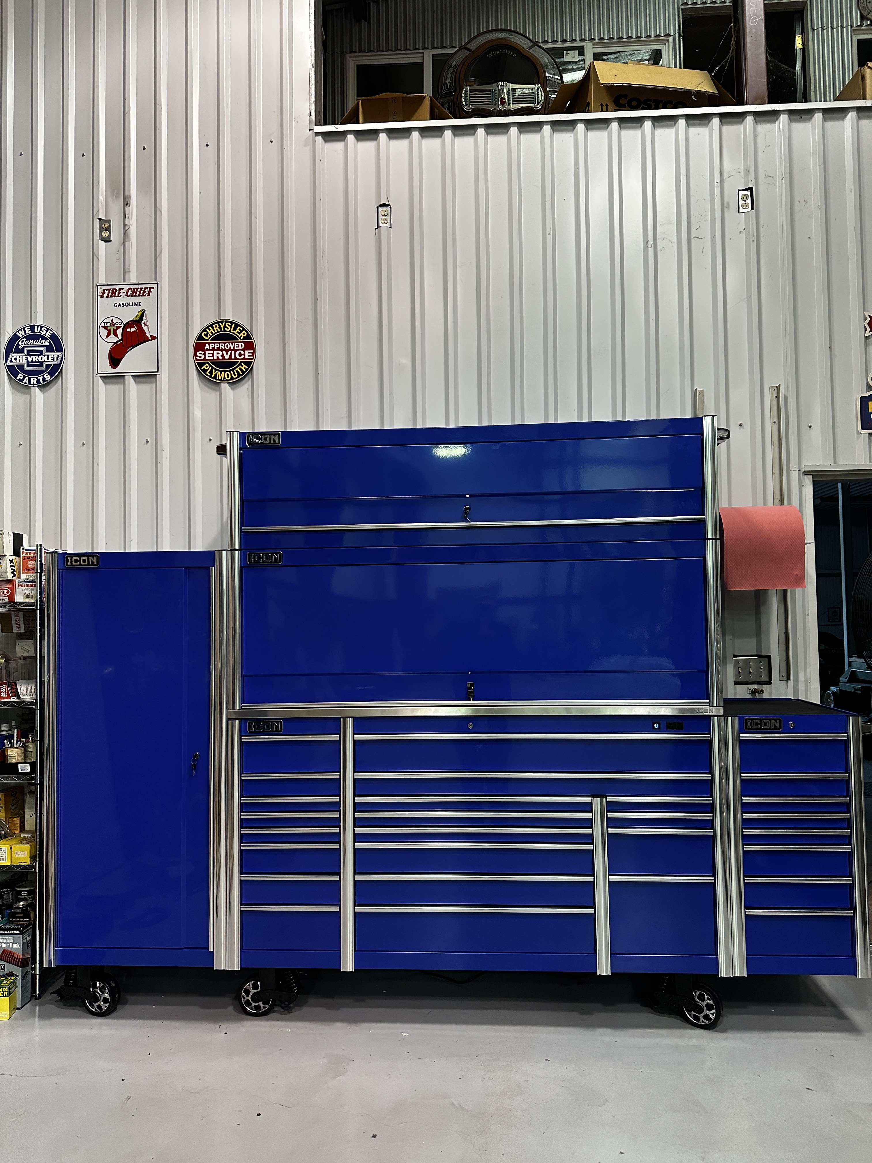

I went to harbor freight ro get a few throw away hammers, some nitrile gloves and a look thru the store. Still, the only things i see there that i really like are their line of rolling tool boxes. Those are built real nice. I will not buy anything with a cord or a motor from this place.
Like this?
