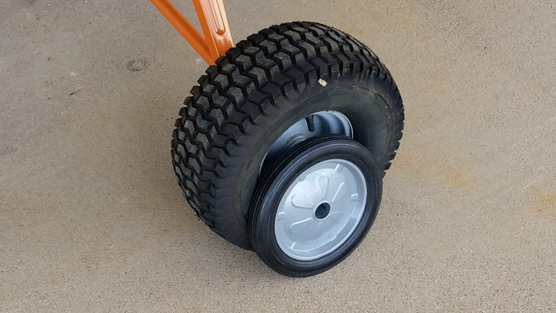

Resolved the crappy wheels issue with wheels salvaged from a tow type fertilizer spreader that frame had rusted out on.
Plan to do a thread on how I did this when I have time.

Note on things with tires, especially tires that hold, or are supposed to hold air. Forget about it because my experience is they will likely soon be rubber rotted and flat. Best thing to do is to figure out a replacement tire option as soon as you buy the item. I have had good luck substituting solid rubber tires that sell for around $8 each when on sale and with a 20% off coupon. Those are actually great tires and should be the OEM choice.
Just my personal opinion here.

I agree, and have been using "flat-free" tires for replacements, but haven't noticed any that cheep. Can you share the part number?
Also, for larger (riding mower, etc.) pneumatics, I add a tube and green Slime. This HF tire changer makes the job easier. Not easy, just easier.

Adding a better quality tube will absolutely help. For cart type things, here is the 10" rubber tire that works for me. It's on "sale" now for $6.99 and with a coupon it's 20% lower.
10" x 2-1/2" Solid Rubber Tire
The 8" same version is presently $6.99.
For bigger tires, changing the tube--or at least be prepared to--would be my plan.
