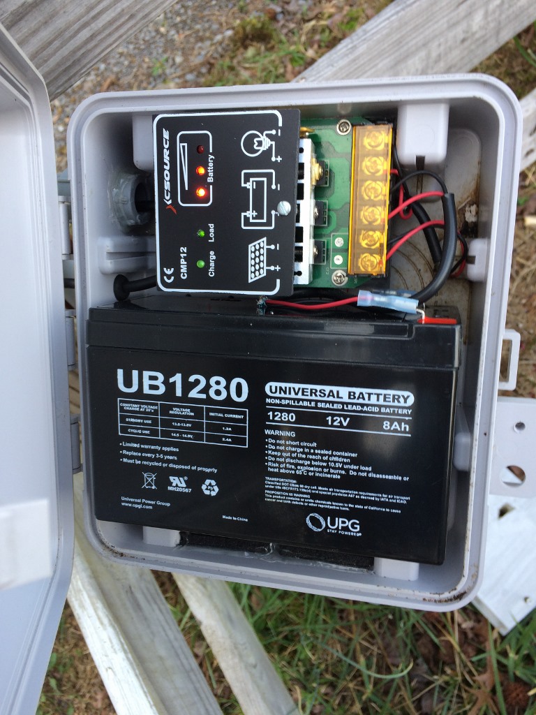

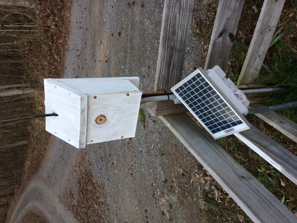

Drew, I built one that I think is what you'd like, quite inexpensively from some Amazon parts - a universal battery, a decent solar panel, a cheap charge controller and a nice sealed box. Maybe $60-$75 in the whole thing. I use mine to power a driveway alarm. You can select whatever size/capacity suits your need. Mine is 5w/8aH, mainly because that was the biggest battery that would fit in the box, and the panel was a nice size to mount on the box. It's been working perfectly for over 3 years now. I was quite surprised to find that almost no one is making "pre-assembled" little solar charging setups like this.
Amazon.com : Solar Panel 5 Watt 12V Poly Crystalline-Grade A Cells-Diode-5W Panels : Garden & Outdoor
Amazon.com: docooler 1A 12V/24V Solar Charge Controller Solar Panel Battery Regulator Safe Protection: Garden & Outdoor
Amazon.com: UPG UB128I Sealed Lead Acid Batteries: Home Audio & Theater
Amazon.com: ESPi EC-1 Outdoor Enclosure Outdoor PVC Enclosure, 8" W x 4" H: Home Audio & Theater
It looks like some of this stuff is rising in price and becoming less available. I wonder why?
thanks, nice set up. The charge controller isn't waterproof for sure, so it needs a watertight compartment.
I did find a few combo kits on Amazon. I really need to study the specs on the electric fence and find out what its daily
consumption will be, and then can size this sensibly without guessing.
Amazon.com : 35 Watt Solar Panel Kit, Build Your Solar Charger In One Stop (1A 35W Kit) : Garden & Outdoor
