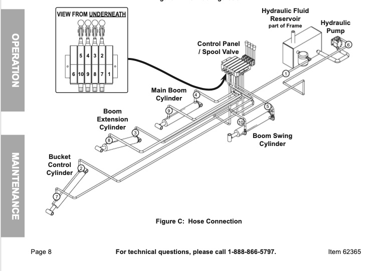

Bought a new harbor freight trencher got about 10 foot trench dug and hydrolics quit working. Fluid is full

If I get 10 feet out of anything from china freight I'm excited. Its really a lease program with the landfill being the final destination. I agree with TractorGuy sending it back if thats an option will save you time. If not I would drain it and search for a clog. Most of their stuff just lacks some prep after assembly so things that should be greased are not and then get hot and freeze up. I would also reverse the swing and main boom hoses to see if that makes a difference. Good luck and its the 4th so try it with a cold beer, that can fix a lot!

Check this
