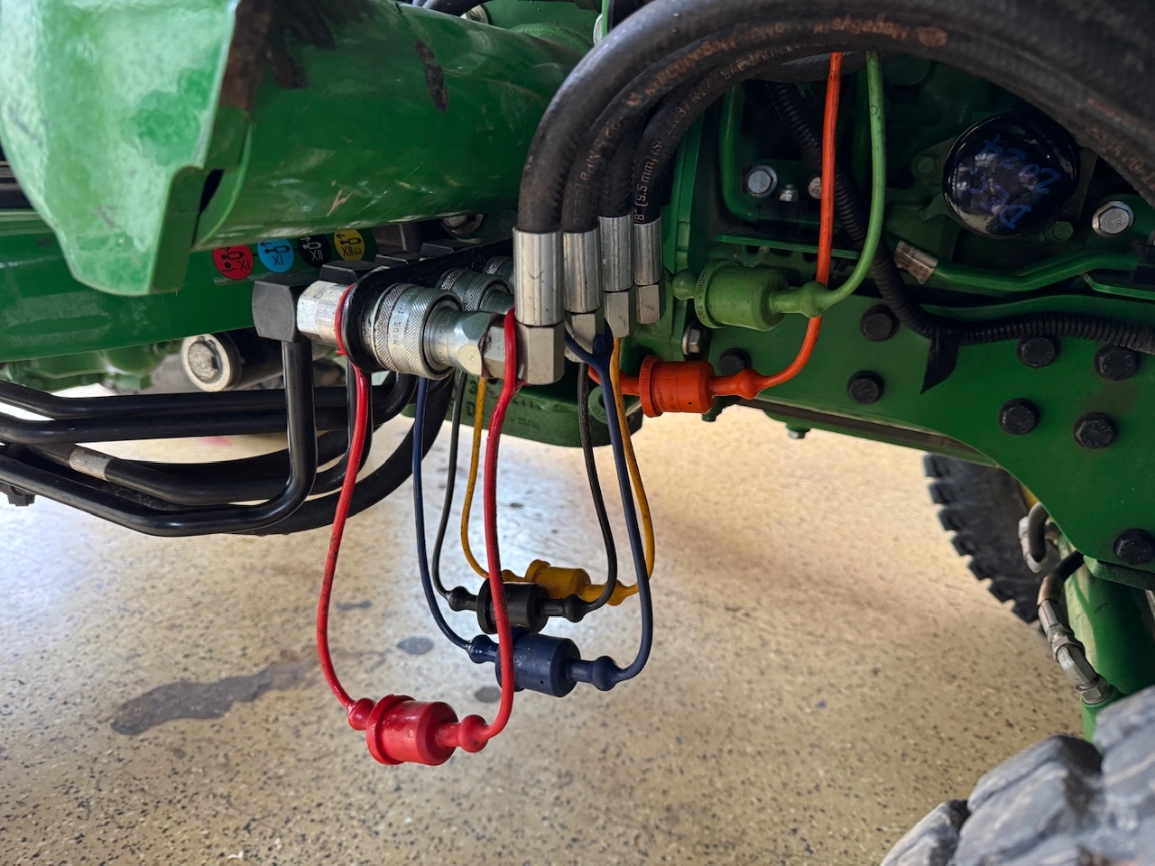

Just hooking mine back up, after spreading fertilizer this morning.
I do rinse the tractor off after spreading fertilizer, because it’s often corrosive, but otherswise just wipe the outside of these assembled pairs real quick with a paper towel, before pulling them apart. Hydro filter change every 400 hours takes care of the rest!
The only gripe I have with these boots is that they get stiff in winter, and occasionally don’t shrink back down enough after pulling them off the male coupling to stay together with the mating rubber plug. But I usually don’t have much dust when I’m plowing snow in winter.
I do rinse the tractor off after spreading fertilizer, because it’s often corrosive, but otherswise just wipe the outside of these assembled pairs real quick with ampere towel, before pulling them apart. Hydro filter change every 400 hours takes care of the rest!
My boots never seem to stay on their respective fittings when I have the loader off the tractor. I've just resigned myself to having to clean the fittings each time I put the loader back on.
Yeah, I had some crappy ones like that, at one point. Try the ones from Deere, they seem to work really well in any weather where you're likely to be seeing dust. The booties that cover the male couplings get too stiff to work nicely in very cold weather, but there's usually snow on the ground at that point, so no dust.
