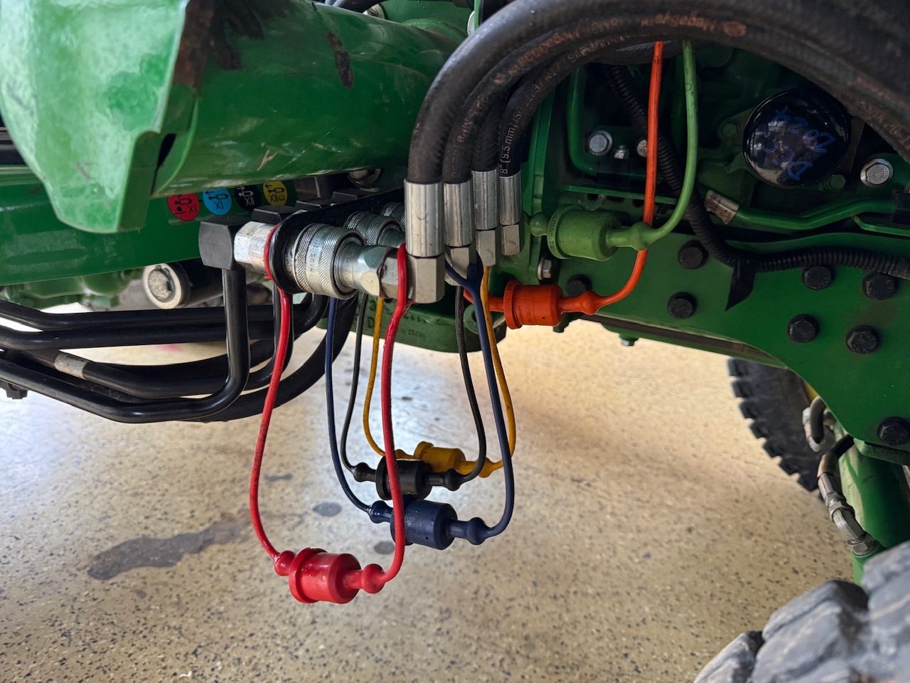

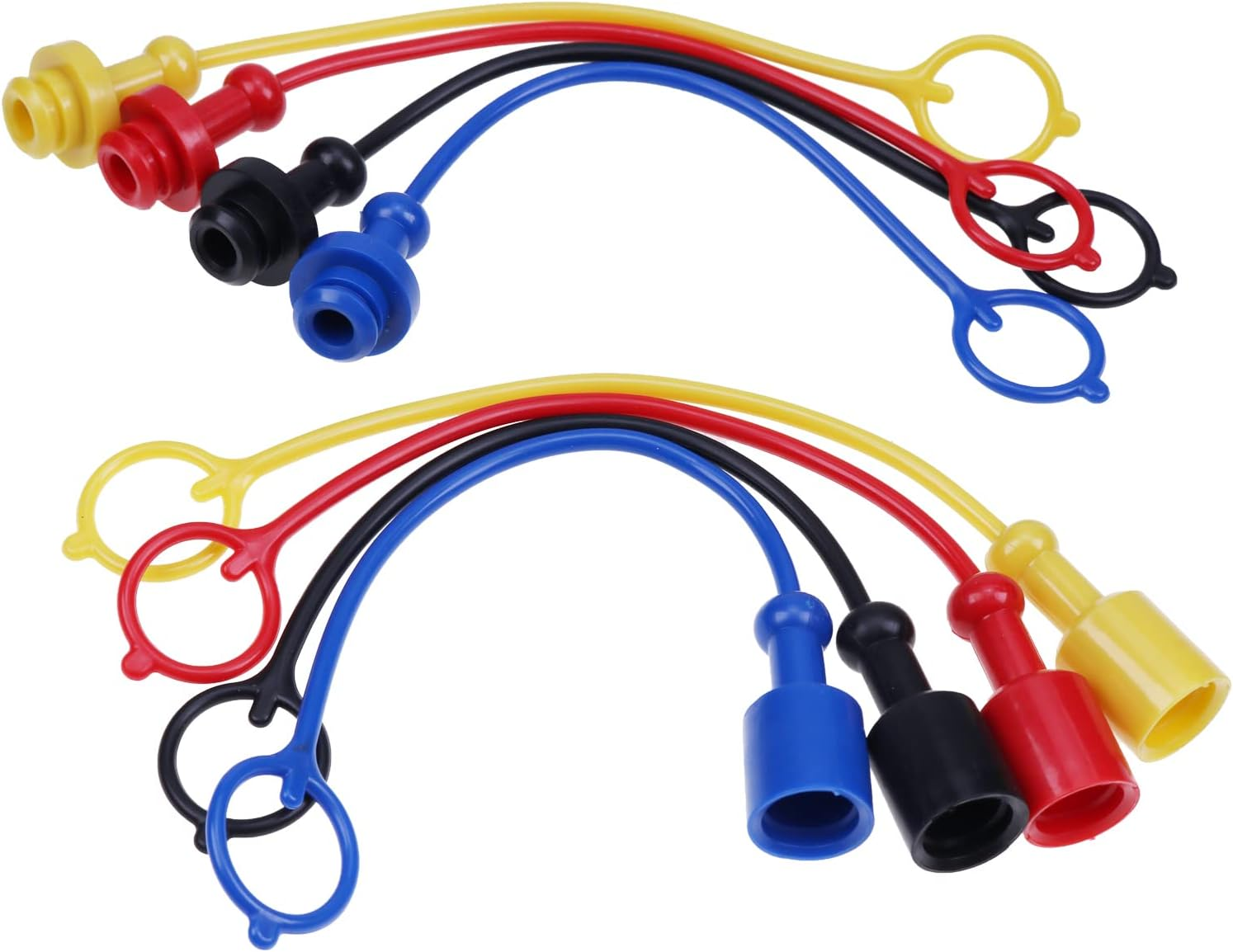

Both my Kubotas use color coded dust caps such as these on the FEL lines.

My Deere also came with the color-coded dust caps on all lines. Lots of them, given my rear remotes, power beyond, hydraulic top link, and third channel out to the loader. They work great, but can be a bear to get off the male coupling in cold weather.
   / Marking / taging / labeling hydraulic lines the cheap way. #20
I have those dust plugs but every time I went to use them they were grimy with dirt. I bought a box of tiny zip-loc bags, and now I just put one over each end and use a twist-tie to keep the ends clean when unused.
