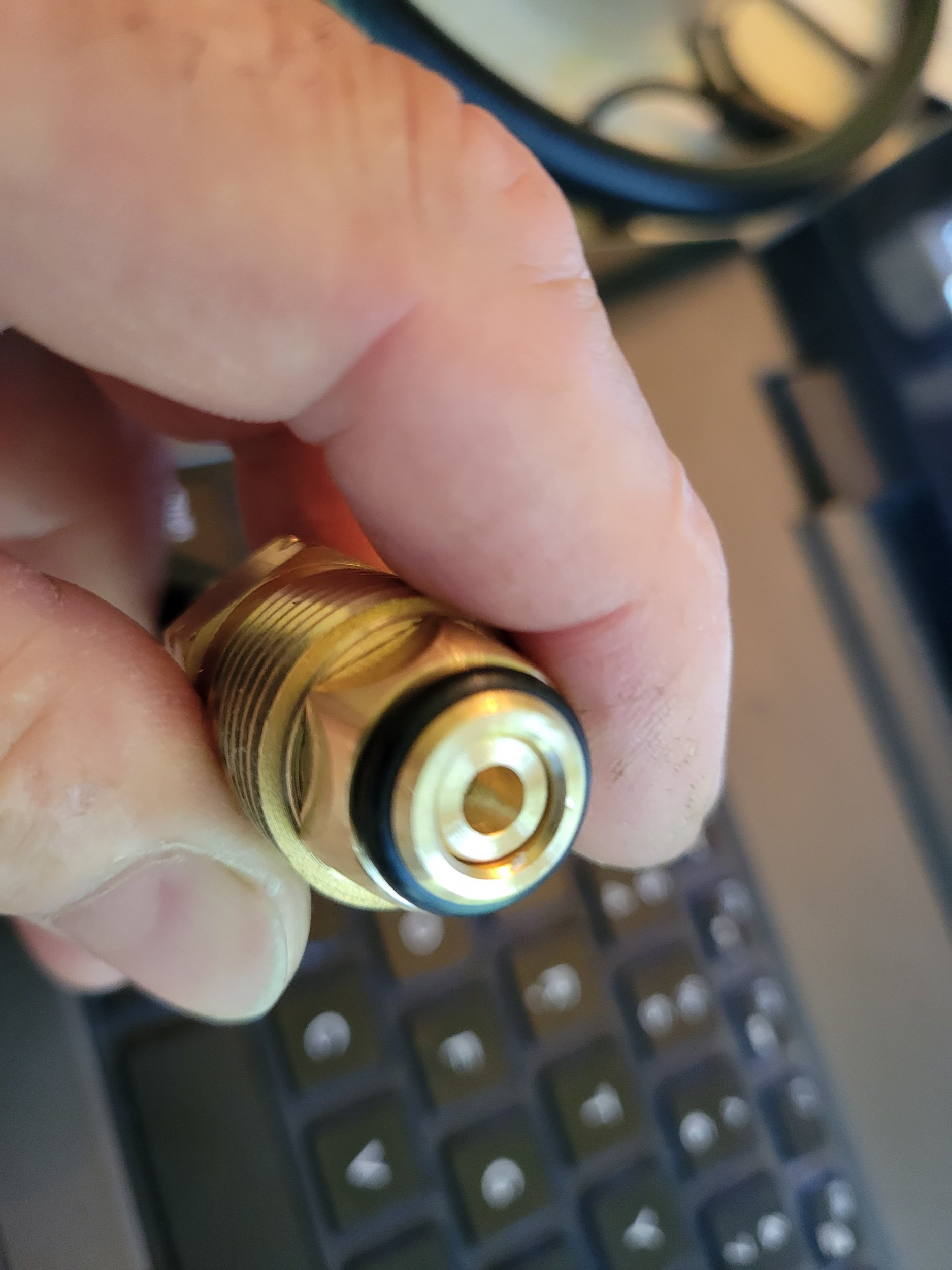

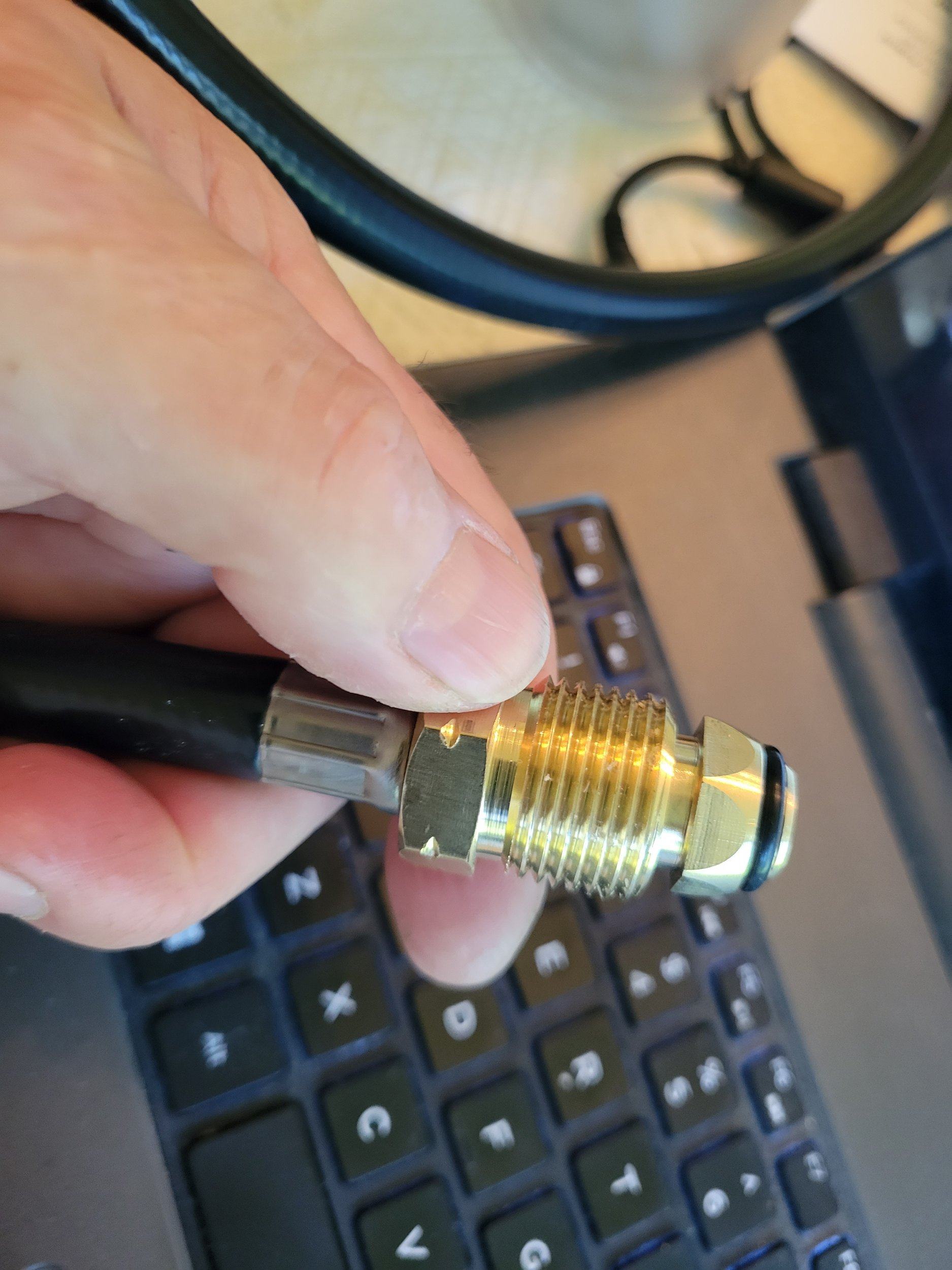

Got it hooked up & got propane in the tank, but when I pull the trigger it gives me a short instant of higher flow and then dies immediately

Many of the new valves still have the LH thread on the inside. At least on RV tanks.
/ harbor freight weed burner #3
sounds like wrong tank for the fitting. or wrong fitting for the tank.
Maybe a adapter is available

Weird, I use that fitting with propane bottles on my cutting torch.

"All propane tanks built in the last years have an excessive flow regulator. If it senses a leak in your system it dramatically reduces the flow out of the tank. This often happens if you have a burner in the on position when you open the propane tank.
Maybe try going slow to full burn? Just a thought

I have that torch in the manual ignition version. I close the valve on the torch. Open the valve on the tank fully. Get my sparker ready. Slightly turn the torch valve open and spark. If it doesn’t poof, open the torch valve a little more. Repeat until it lights.
If you open the torch valve too much when trying to light, it will go POOF and go out immediately.
So I’d suggest a less-is-more when lighting. Once it’s lit, then adjust per the owner’s manual.

You gotta ease into it on the new tanks. They will shut off with any quick increase in volume. I use the weed burner's handle on my old tanks and the knob on the newer ones. I use this same weed burner at least once a week for it's intended purpose and also cooking. Best steak sear and brisket bark anywhere.

as it turns out there is a sweet spot for the piot light setting too much and it's no good too little the samme
/ harbor freight weed burner #18
Yes. The same thing happens on small propane torches used for soldering pipe. Everyone cranks the valve and hits the sparker and nothing happens. Too much gas. Turn it off, and gradually open the valve while sparking until it lights. Then adjust for the flame that you want.
