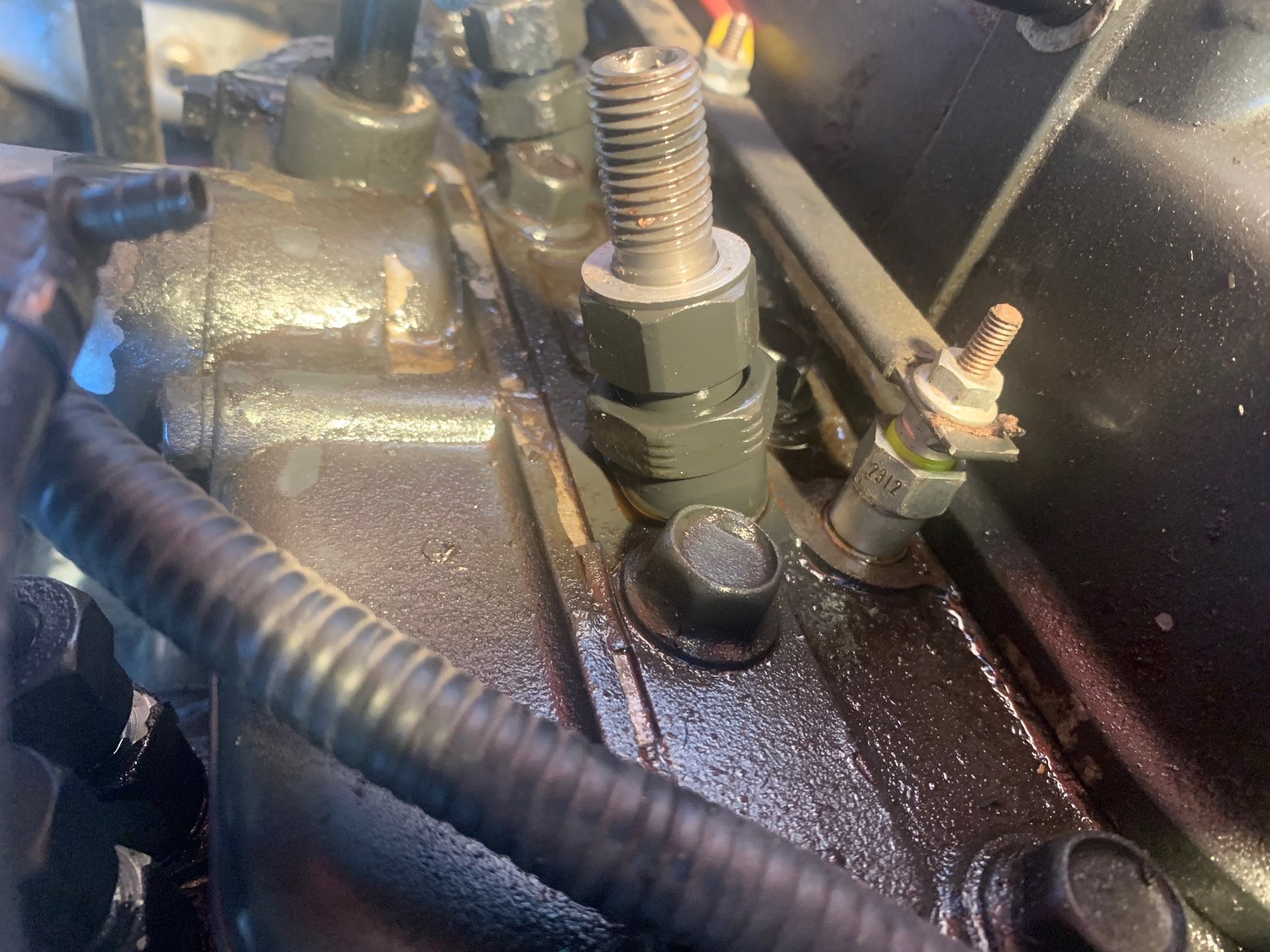

trying to remove injectors today and cannot get them out. Instructions say hold injector body while turning jam nut. I have tried this and the nut will not turn. I have applied penetration oil and still no luck. Have applied what I believe is borderline excessive force and just don't want to damage something by getting to strong armed.
any suggestions?
   / Hard starting 2400H - lift pump failing? #48
I am not sure but it looks as if the whole thing will unscrew as a unit. I don’t see that nut jamming anything.
#49
K5
You are correct the whole assembly unscrews. Either I misread instructions or Korean to English translation was misleading.
All 3 injectors are pulled now to test them.

I connected two of the injectors to injector pump lines and had them spraying into a container. Neither injector had what I would call a good mist spray pattern so took all three injectors to a local Diesel injector pump repair house. They took all three back on there injector tester and agreed that at normal flow rates the pattern was bad so they hit them with high flow to see if could flush them. All three then had good mist pattern so brough them home and installed them. First start as expected was rough from air. Let run for awhile last night and tried again this morning. Started much better so will see how it does for the next few days.
