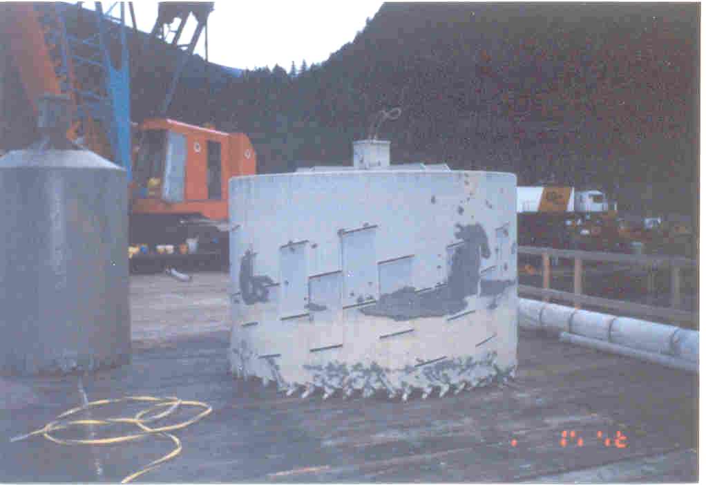

I was taught though, that the dirt that packs in between the rows of hardfacing is as important to the abrasion resistance, as the hardfacing itself.
That is what I was always told too. I always left it up to the equipment operator to tell me what pattern he felt was best.
