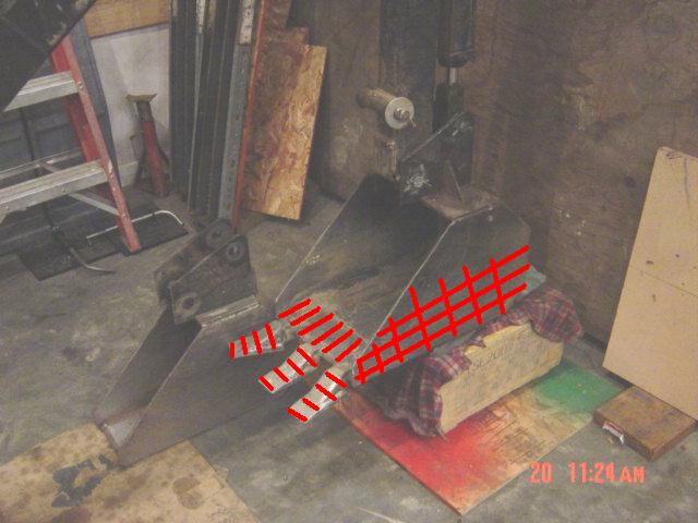

Here is how I hard faced the bucket for my backhoe. You will receive a multitude of opinions on technique for hard facing.:laughing:
You'll want to clean the bucket real good, hard facing rod doesn't like dirt / rust.
Stoody 31, is very good choice for sandy and abrasive soil.

I did a large Front end load blade once. THey wanted the full bevelled surface hardsurfaced. I preheated it to 200F and started to coat just the cutting edge, after about 4 feet of weld, the shrinkage busted the blade in the middle. Those welds are so hard and brittle that they will break off rather than bend. Just need to X X pattern them rather than try to make a solid weld like I was doing. I hear that there is a hardsurfacing process where they use a powder with an oxyacetylene flame to coat materials that works without overheating, but I have never seen it done.
