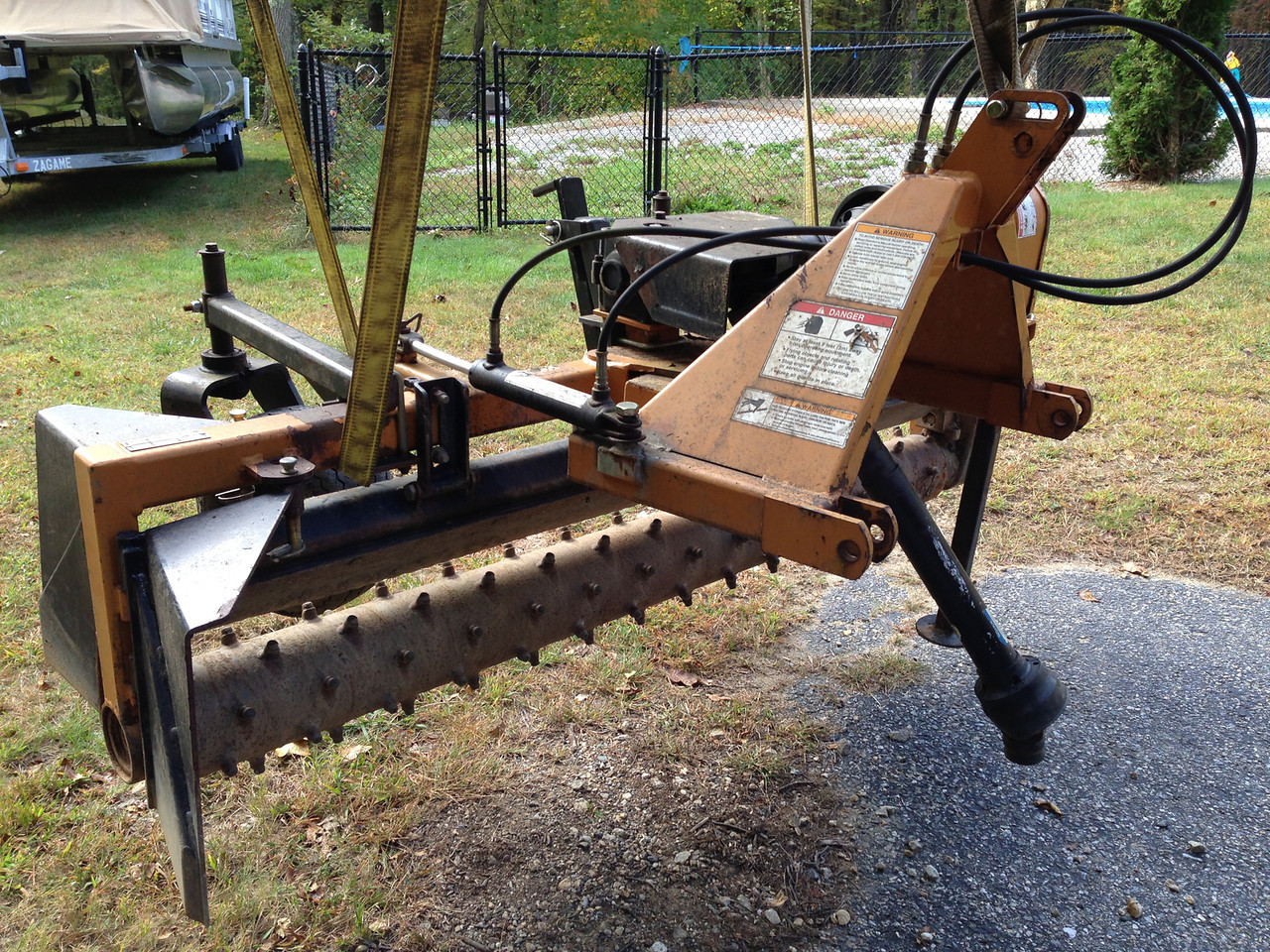

It sounds like it would work well for what you want to do with it. I had a Pro 6 years ago when I had my tractor and raked all sorts of nasty stuff with it without a problem, if you do run across something too big the slipper clutch will slip and protect the drivetrain of the rake and the tractor. After I wore out the bars on the roller i bought a roller with the carbide dimples and in my opinion it does a much better job at loosening the soil and kicking out rocks. I would regularly use it to grade compacted gravel/process driveways and the finished product was fantastic. I now use one on a tracked skid steer and it takes way more abuse than one on a tractor because it can be run forward or backward and the machine that runs it weighs 11,000lb. I have had it for 10 years or so without a problem, it is going to need bearings for the roller soon, but as far as I'm concerned thats quite acceptable for a piece of equipment that spends its life in horrible conditions.

Here is a picture of the roller on mine.

It will work just fine. My rake for the skid steer is 10 years old now and is missing a handful of the carbide tips, just the tips though, not the bases that are welded to the actual roller. I havent replaced any yet but really should think about doing it soon. I have run this current rake over ledge that was covered by an inch or so of soil and numerous unseen rocks/boulders. I have also seen it pluck stones out the size of bowling balls. I wouldnt recommend running it in areas that have rock like that every square foot, but it is made to work in the dirt and remove stone from the soil.

As I mentioned with the slip clutch properly adjusted the roller will hop over a large rock or slip. I've windrowed softball size rocks with that rake for years and you can see the lack of wear yourself.
