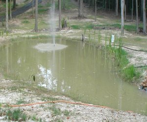

Sometimes, Yahoo isn't the best. I'll try attaching to here. Used a Case backhoe, an old 8n and my little 1220. 8N was pulling the grader box and used a rake on the other. Being lazy, easier than switching attachments.
   / Has anybody built a pond? #24
View of the pond (water feature?)

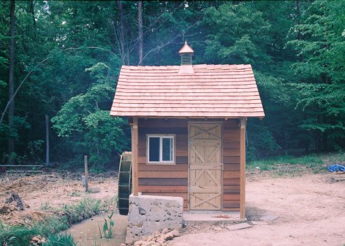

   / Has anybody built a pond? #27
Hopefully, will look better soon. Poured part of the foundation for my new millhouse last weekend. This site greg's pond has a lot of inspirational stuff on it (filters, ideas, etc.). Don't spend the extra money on pond pumps, a pool pump will work just as well and they are about 1/2 the price. Dollar wise right now, diesel fuel, beverages and concrete are the biggest expenses i've had.

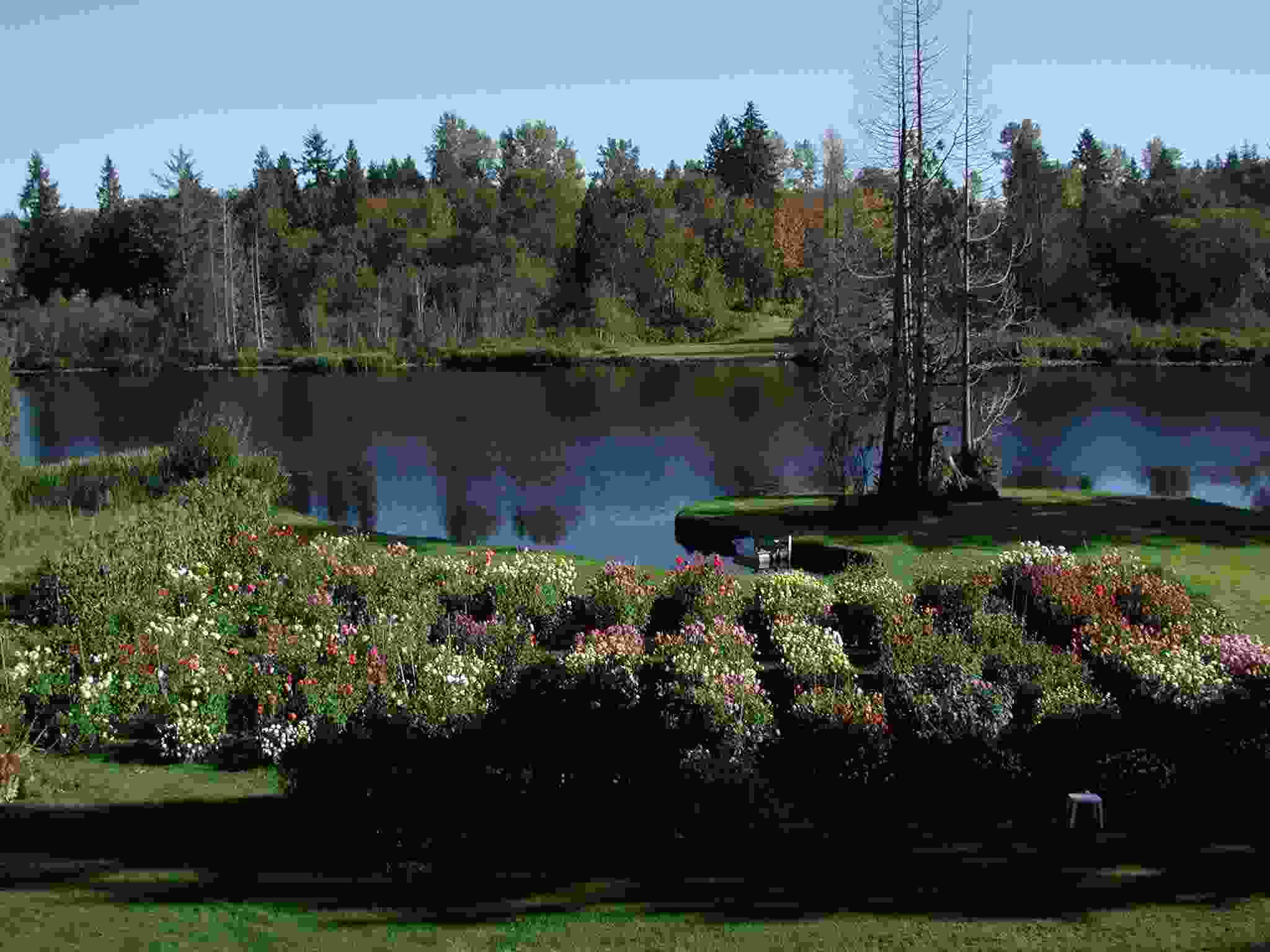

   / Has anybody built a pond? #29
"We had way too much water source so we had to put in a pond to control runoff. I have a 18" pipe coming into the pond and 3 12" going out.I use mine to irrigate the whole property with it, about 7 circuits now and growing".
Here is a picture of my pond. Sorry I can't get the resolution right. It started life as a huge file... I have about 2000' of Roberts Row-Drip tape on the flowers but I would like to irrigate the field and lawn. I like to hear more about how you have your circuits set up and pump info...

   / Has anybody built a pond? #30
Well Dave....
Have to ask the next question...when does a pond end and a LAKE begin???
Very nice!
