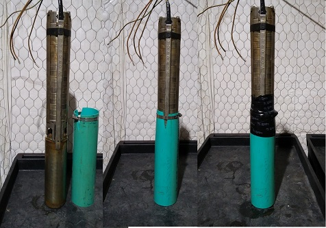

A lot of people irrigate from rivers, ponds, lakes, etc. With drip you have to filter it. With sprinklers the sediment will just be pumped out the sprinklers. Always better to push water than draw water with a pump. So, a submersible well pump would be best. You can use some PVC sell casing and screen installed at a angle into the lake. Sliding the submersible down the casing makes it easy to install, and the well screen at the bottom keeps out the turtles, small fish, and most of the lake trash. Install the pump above the well screen or use a flow inducer sleeve to keep the motor cool.

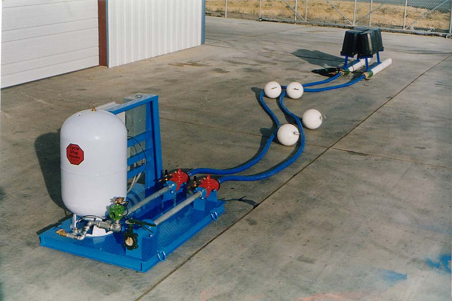

Here is a picture of some floating submersibles with a control system that sits on the shore.
