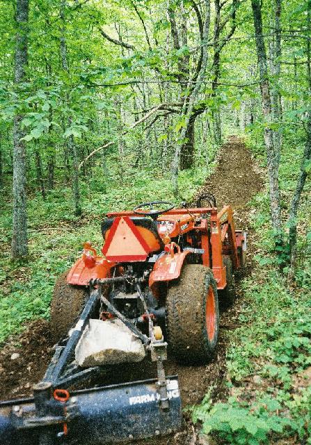

Has anyone ever added removable weight that isn't just ugly
It may not be pretty but its very cheap, readily attainable and does work. :D
I use a rock.:D
