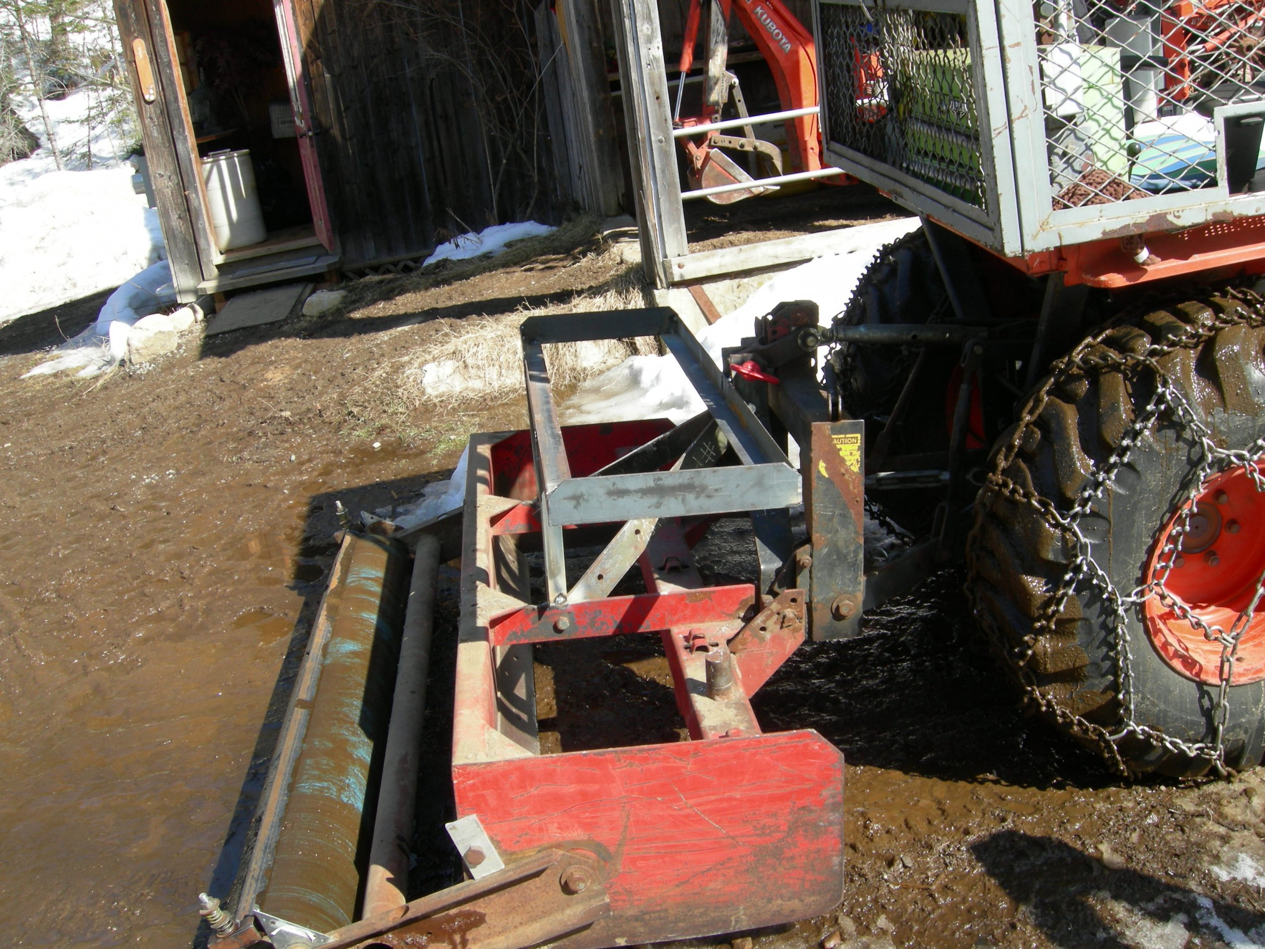

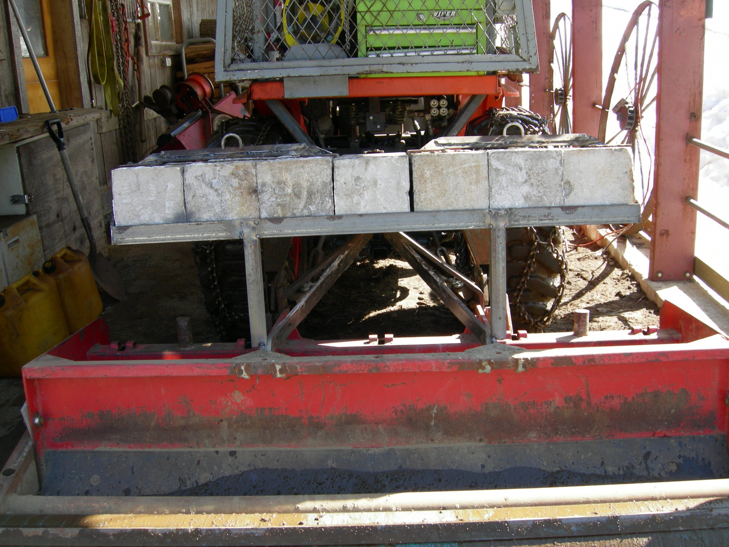

I use 9 ciment blocks and a drainage pipe to adjust the height.
