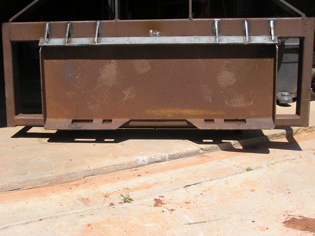

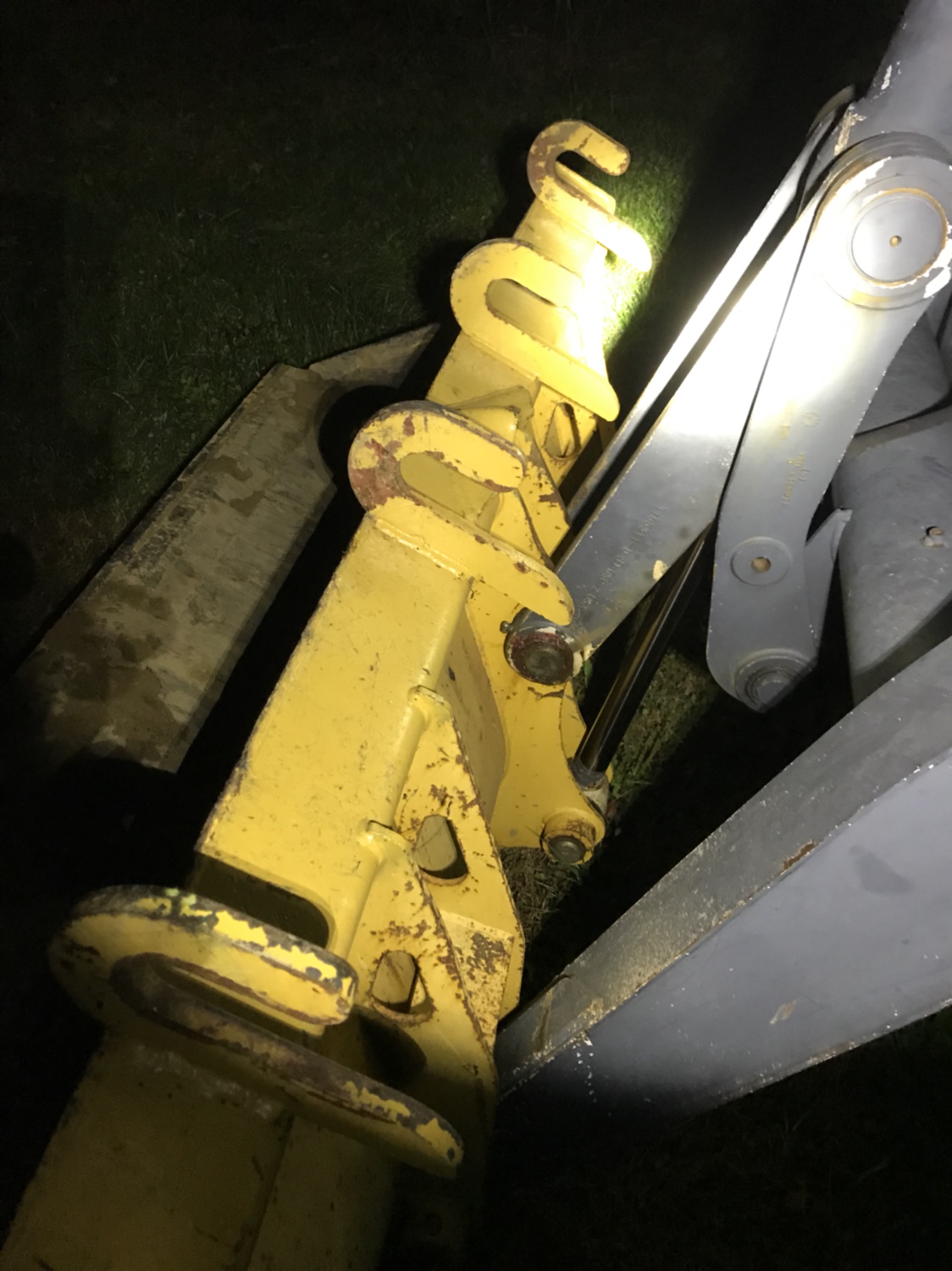

I have a 420 ford industrial backhoe, and I thought about putting a quick change for the bucket to forks or whatever, I changed my mind and just put 3 hooks,(similar to the 4 hooks on your bucket), and use a 1and 1/2 inch steel bar across the top and hung the forks on that, it hooks up quicker than a quick attach as I don't have to get off tractor to hook it up. the down side is I cant see the forks most of the time. they do hang down about 4 inches below the bottom of the bucket, but still cant see them if there on the ground, In any case they are very handy, just yester day neighbor had me load shingles on his roof, so his son didn't have to carry them up a ladder. We are both in our 70s so don't like ladders anyway.

I have had that same fork arrangement for the past 30 years.
Exceptionally handy to use, and I use the forks WAY more often than just the bucket.
The problem is: The forks (mine are from an old Clark lift) are heavy, and in front of the bucket, so lift capability is cut way down.
I could lift much more with my set of real Ford forks, but that would mean manually swapping with the bucket.
That ain't gonna happen,
Those Ford forks are somewhere in the barn, under a whole bunch of other stuff.

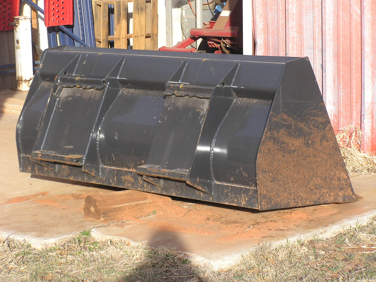

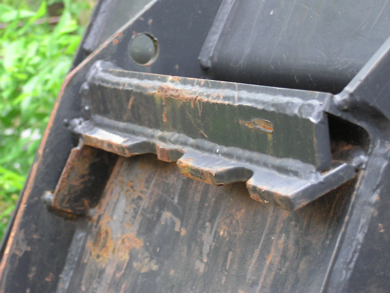

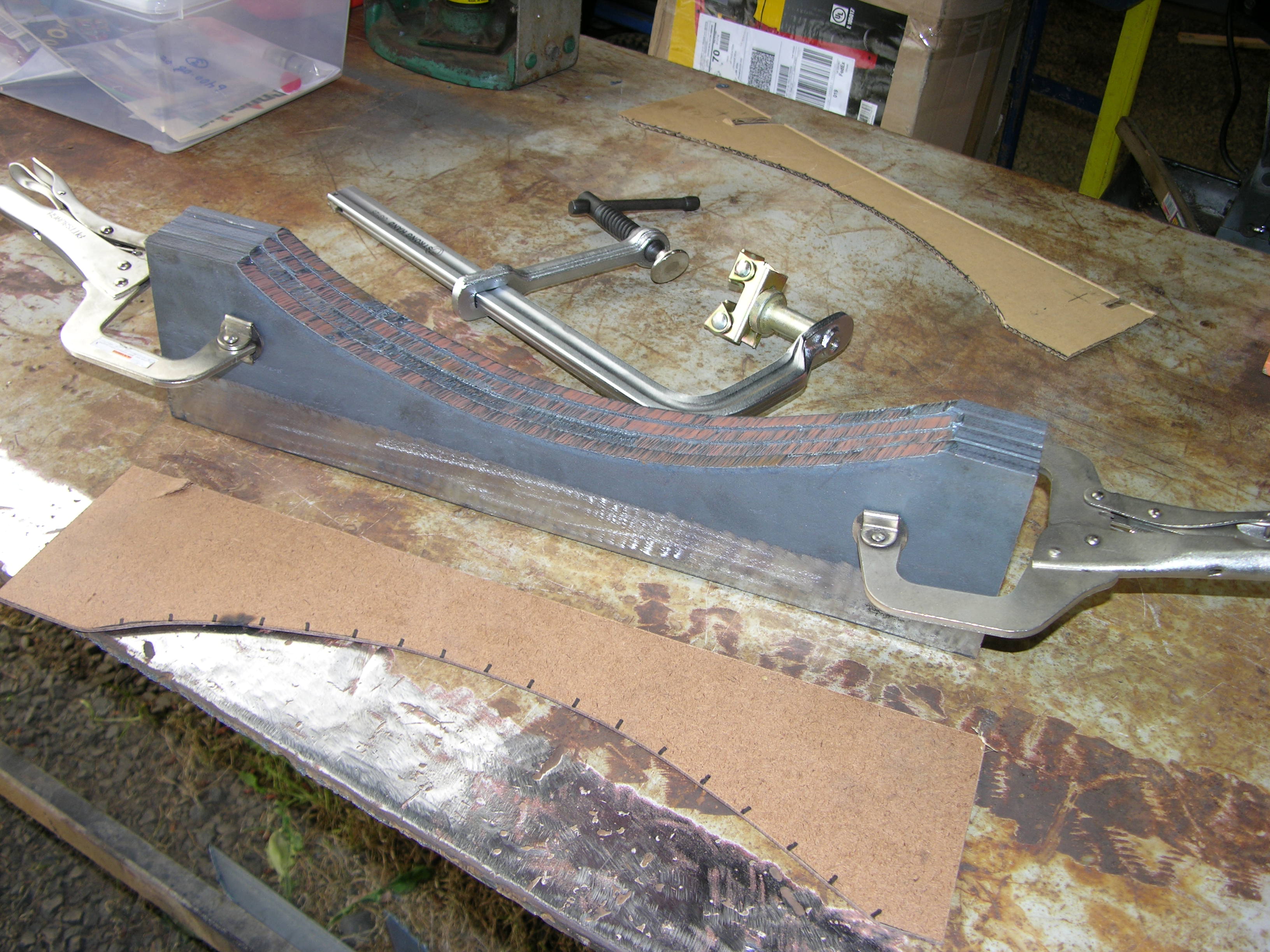

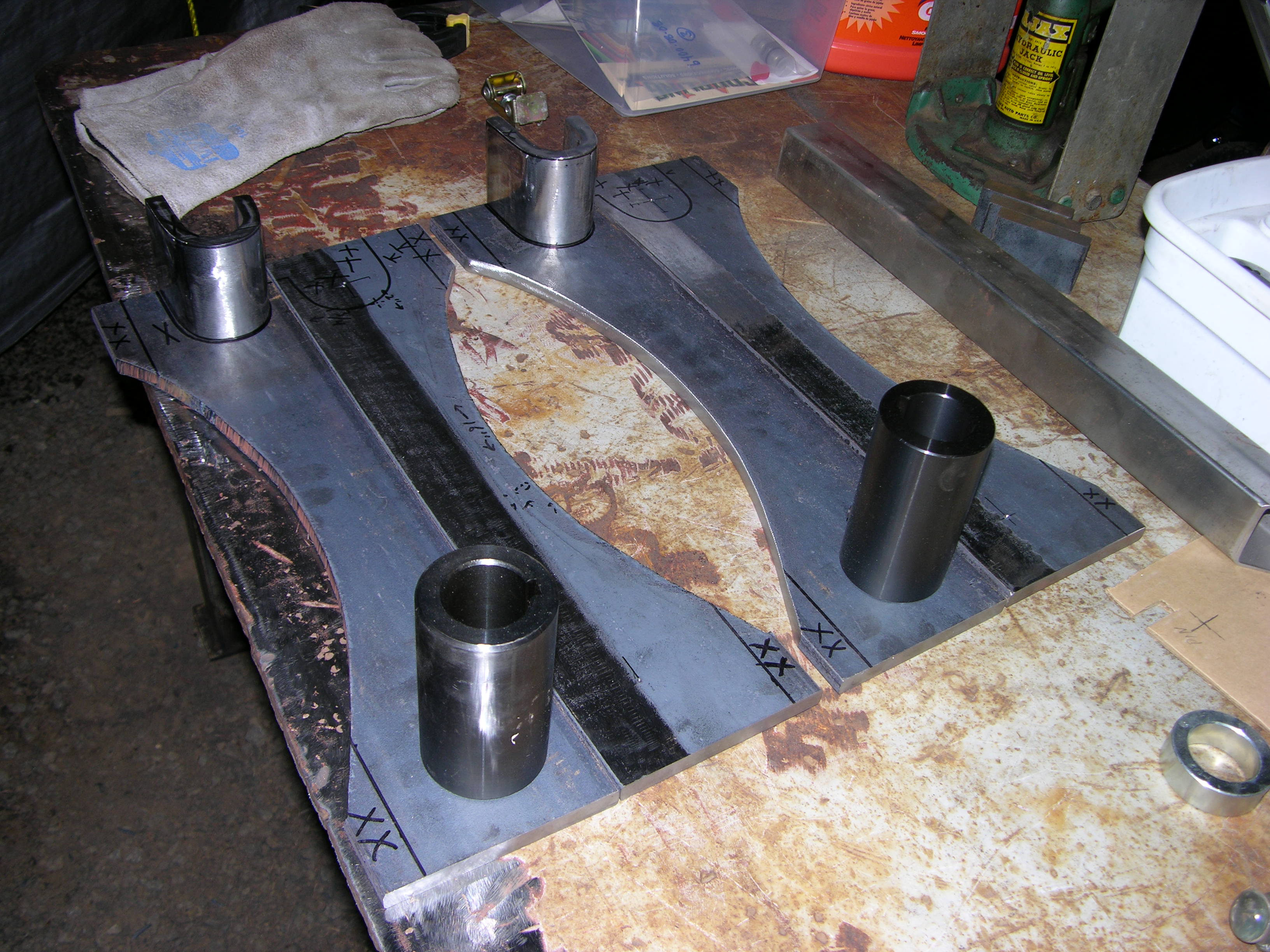

I could always do that, but visibility and lift capacity is cut way down and I loose the ability of using other implements. The backhoe loader isn’t a wimp to begin with with 6500 pound full height lift and 8500 bucket lip breakout force but I’d hate to cut it in half with lousy forks. I was really thinking about cutting the back of the bucket out, welding some ears on that plate for the 4 point QA and having the metal fab shop make a new piece for the back of the bucket. I’ll see what they say about that idea. Making a new back plate might be challenging since their roller can’t handle steel that heavy.

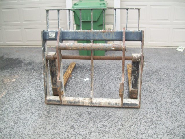

Yes the big loaders sometimes have QA. It’s a 4 pin system. It’s nearly identical to the Kubota backhoe subframe mounts except upside down.
