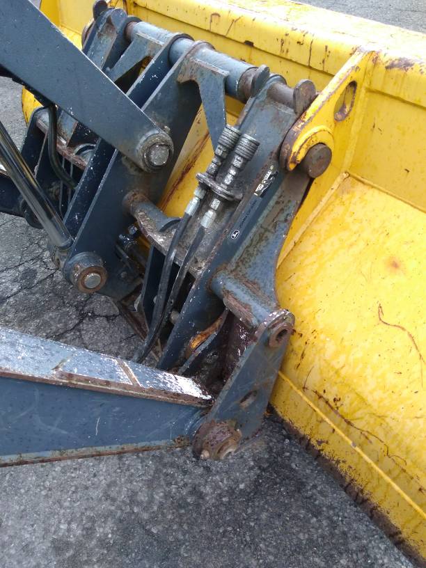

Deere makes a pin disconnect for these backhoes.

It’s a John Deere 310j. But 3 k or so is more than I want to spend.
What are you wanting a detach bucket for ? If it's forks only, I'd use the drive in forks like you have.

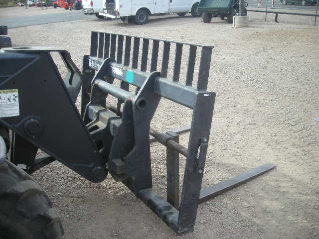

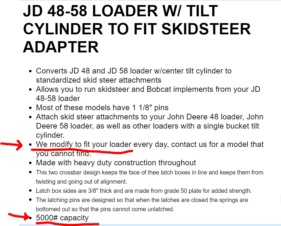

Would a JD 48-58 adapter work?
I had seen this style earlier, but with a 3,000 pound rating. This one is 5,000.
It can be made to fit a John Deere 310j.
5000 isn’t enough. It’s 9500 pound breakout strength and 6500 full height lift.

5000 is about as good as it gets in a ssqa.
I found one to fit my 575E but it looks pretty light and had no listed rating.
I talked to MTL a while back and they said they would convert one of their extreme grapples to pun on my machine.

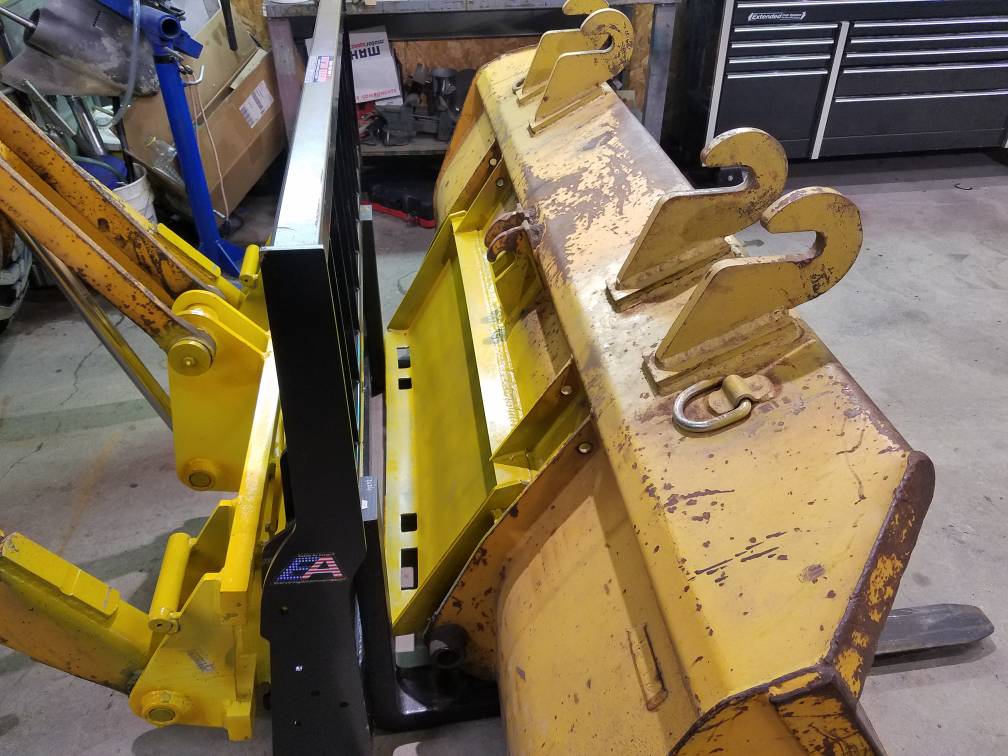

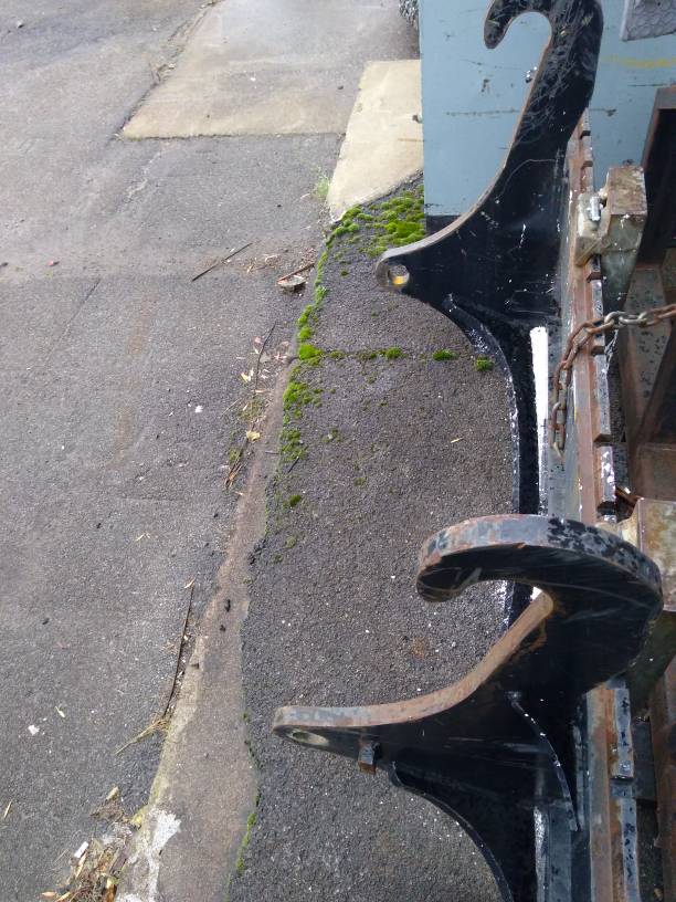

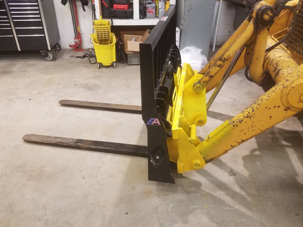

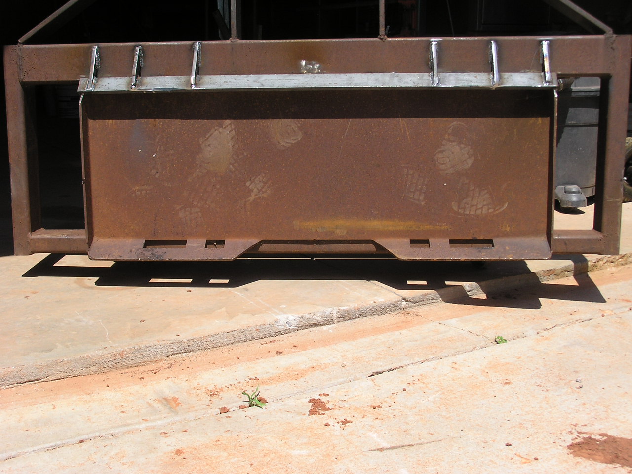

Unless you are planning on using other quick attach attachments I would stick with doing the hook design (as seen in posts 24 and 36 (the case backhoe)). You're not going to know for sure how much force is going to be on it. Just for safety reasons alone. If you can get a local machine shop to cut up the steel and you don't mind trading firewood then that sounds like a good option. Clearly the single cylinder Deere has made it more complicated.

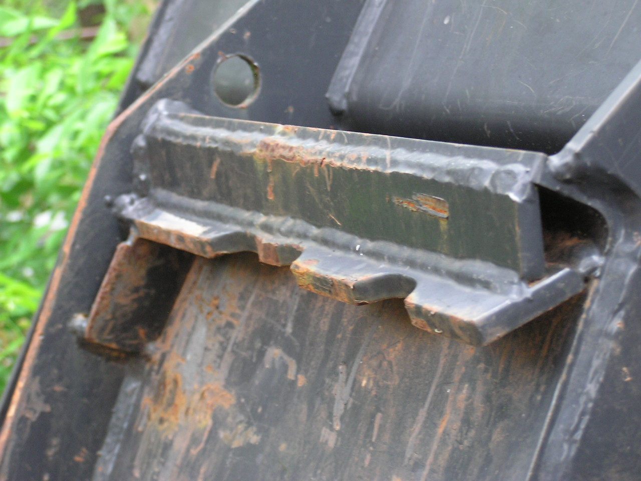

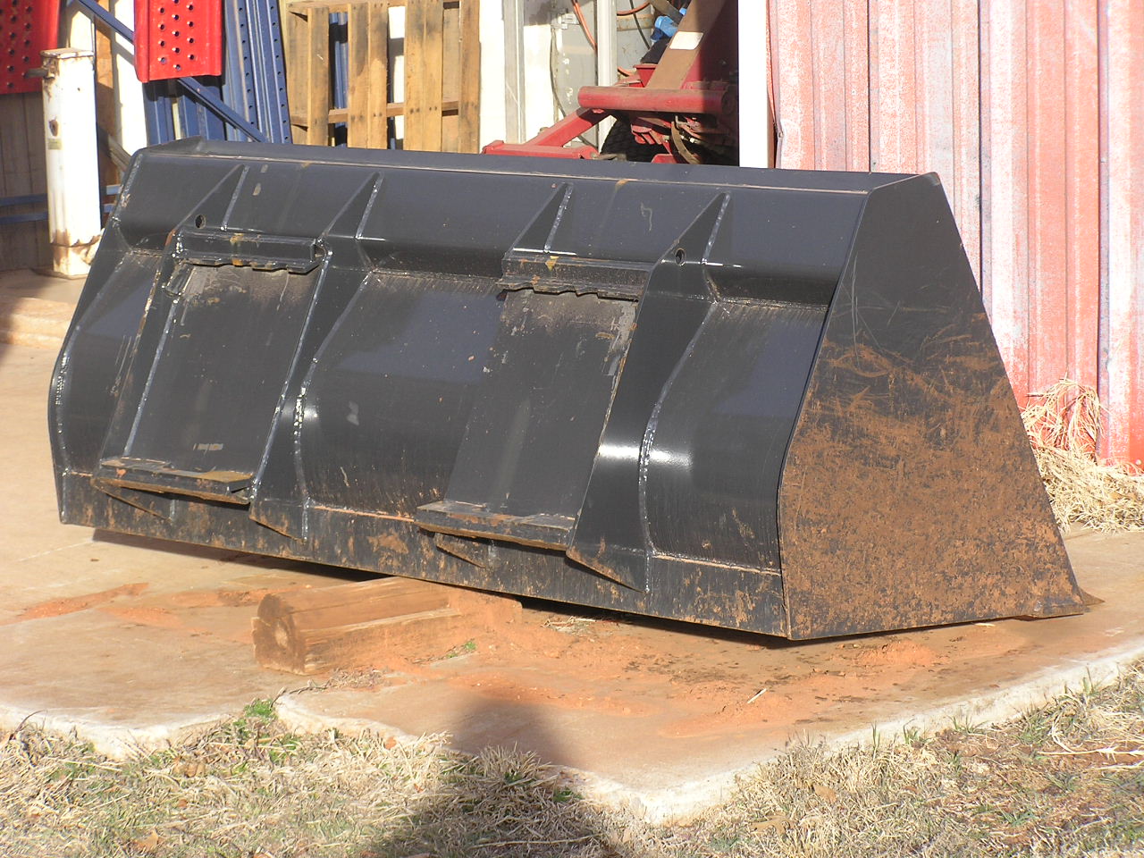

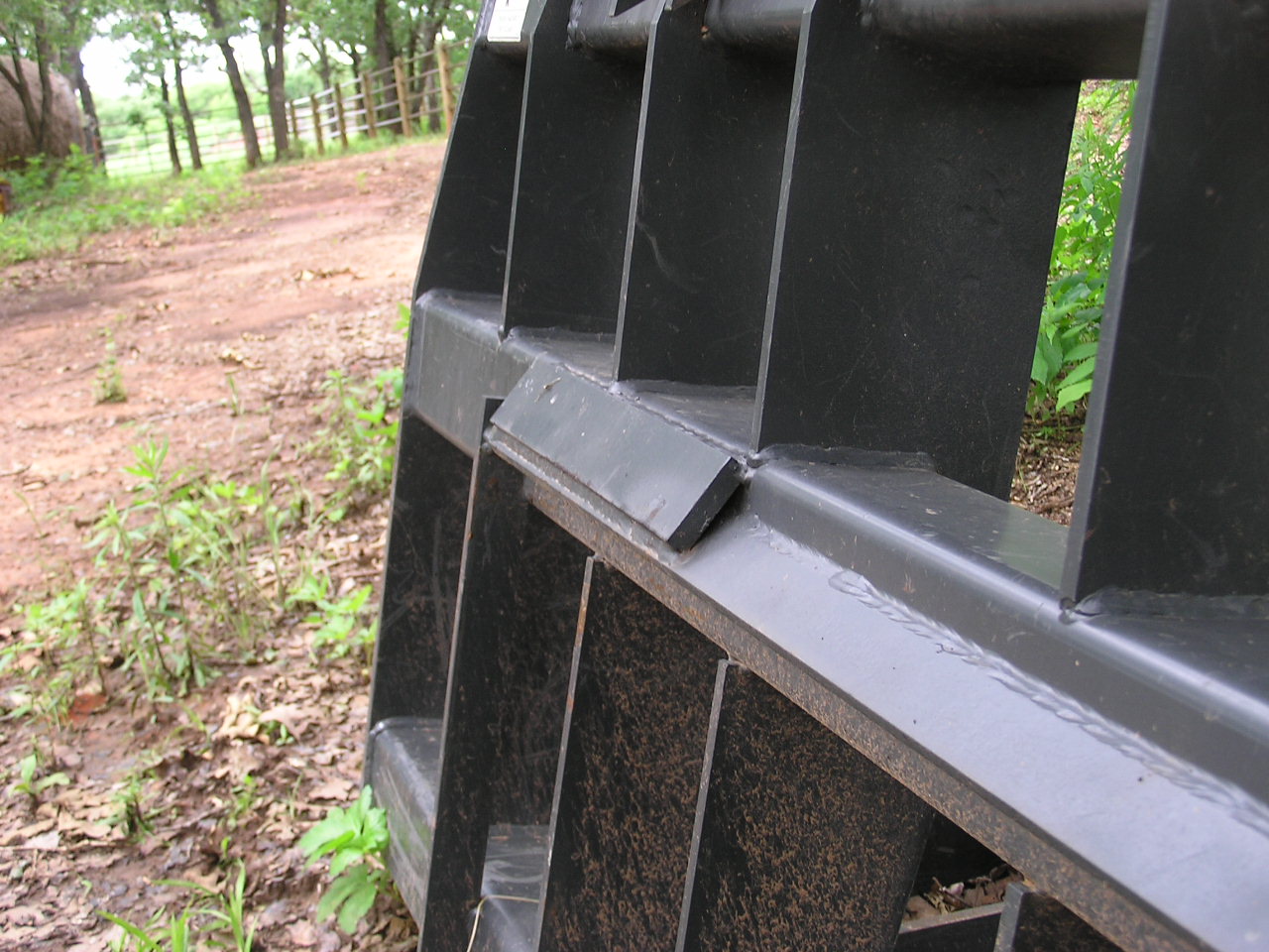

Both of our Bobcats are single cylinder and the SSQA plate is very strong:
The back side of a V417 plate:
Here it is with over 6,000 pounds of force on the plate, note that the rear wheels are off of the ground :thumbsup:

Call Washburn at 800-283-7107 and ask if they can build one strong enough for a John Deere 310j.
I did order mine from washburn. They claimed it should be good for 7000 lbs. I also bought two 7000 lb rated SSQA attachment blanks. The stuff seems like it it tough enough for my 210, but the 310 is like 60% more in every way. The washburn adapter that I received is a piss poor design, that can damage the curl cylinder, has very little roll back, and the lock pin handles are a nightmare to use. But hey, at least it was cheap! I just hope that they can do a better job on the drawing board for the next guy...
