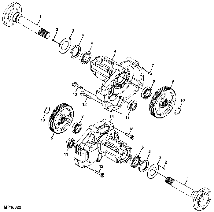

I hope you guys are right about the bad casting. I only said aluminum because it didn't have any weight to it. It didn't feel like cast iron. The pins that hold the upper link in place are all orginal JD pins. I didn't see any places on the lift arms where the pin could have contacted them. I'm calling my dealer first thing in the morning. He's been really good to me and I hope there isn't any problems. This could be one costly repair if not covered. I'll keep you guys updated.

I doubt this being cast aluminum. If it is John Deere needs a good spanking. It matters not how the pins were located. This is the use the casting was designed for. Tell me I put my pins in the wrong way? I think not.

Easy way to find out if it's iron or steel...use a magnet.
It looks like aluminum to me, but pictures aren't always worth a thousand words.

I see you have a 447 backhoe... I assume you have a subframe? Does the backhoe have a top link that hooks up to this part...
   / Has this happened to anyone else.. #18
i checked mine today, it's iron. but, i noticed the paint peeling off of the rear (final drive?) housing...#6, and it looked aluminum. magnet doesn't stick, so i guess it is.
seems like a bad place to not have iron?
The 3x20 series and the 447 hoe does not use a sub frame, it uses adapter plates that bolt to each side of the rear axle. The toplink is not used in any fashion to lift or support the hoe.

Called dealer yesterday morning. He said that it sounds like a warranty issue to him an he would get the part on order. I seem to still have time remaining on my factory warranty. He was going to check to make sure. I never heard back, so I'm guessing I did. I put a magnet on the bracket that broke and it stuck to it. Actually, it grabbed really strong. so I'm guessing cast iron or cast steel? I also have a 447 hoe. I'll check around the mounting plates for any cracks or paint chippage just to be safe.
