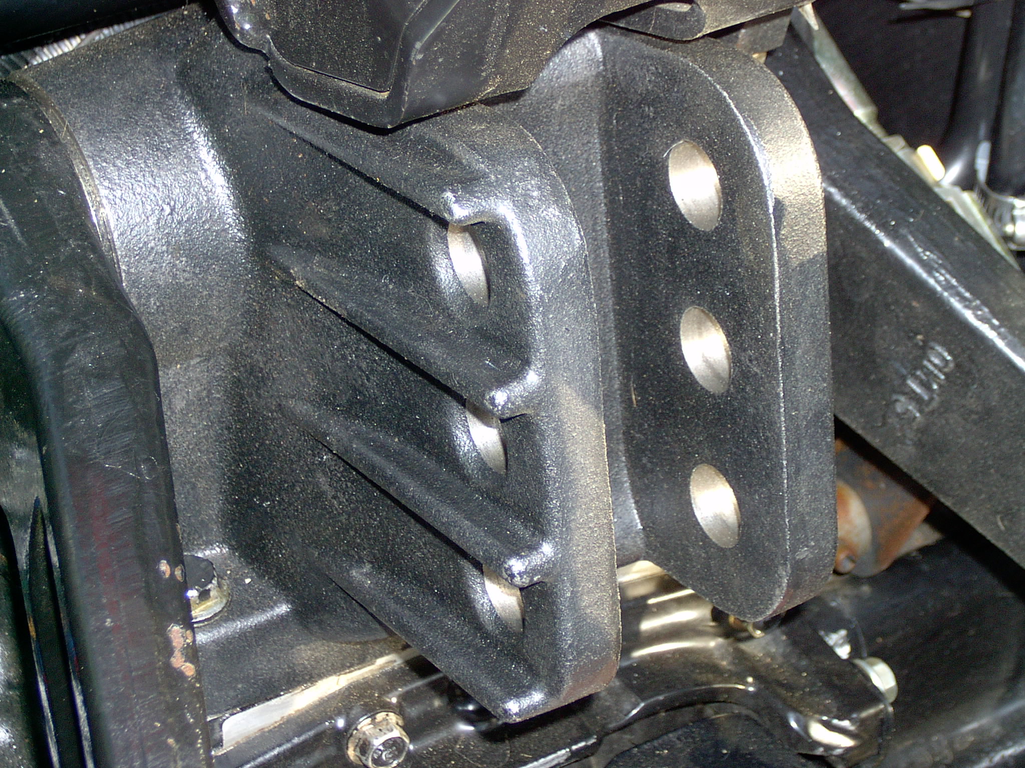

Just saw this thread, wow, this is the 1st time I've ever seen this on this board. I don't think the small inclusions had much to do with it. I'm focusing on the discolored ends, meaning this was cracked previously. I've learned to be careful with box blades and only "pull" them forward to upset undisturbed dirt. Only back up to push a pile of freshly moved dirt around. While pulling, the forces are primarily tension on the lower rockers and while backing up they are compression. This is how stuff likes to bend. Also, it is all to easy to put a side load that can break something with a box blade. Catch a tree, rock or stump on the edge and you'll probably break something.

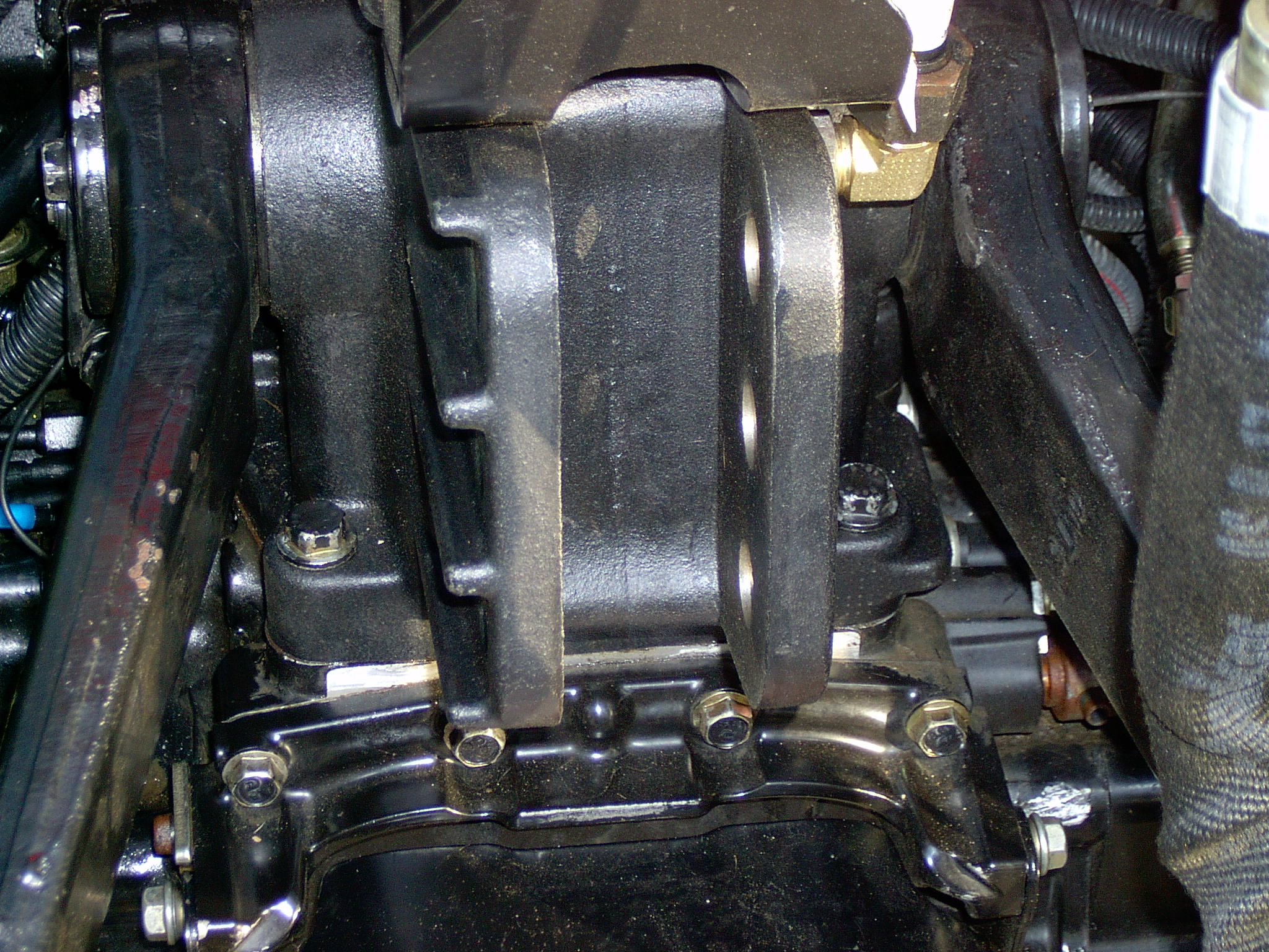

I'm glad JD is doing the right thing. I have a 2009 JD 3x20 and the housing is exactly the same as on your 2006 model (definitely iron). It is to be expected they did not have many failures or they would have modified the design.

Dealer told me today. The JD rep said that is was a bad casting and they would pay to replace it at no cost to me.
That is what they should do. All companies should do this too but often do not. One thing though, I do not like this idea of a warranty being some sort of 'gift' to the customer. What the warranty does is limits the manufacturer's responsibility for the product. Without the gift of warranty the company would have to repair defects forever.
Regardless of what the warranty limit is you can always sue if the item is not covered. In your case since the defect occurred at the factory it had be within the warranty period by definition.
What I am curious about is how this part ever passed inspection. Did the rep say where the part came from?

I'm glad to hear JD is coming thru with a replacement. HEMA of Turkey
is the maker of the 3-pt cyl housing, and it is all cast iron/steel as others
have said. For reasons unknown, JD has actually INCREASED the use
of cast aluminum on the rear of this tractor. Now the center gearcase
as well as the 2 axle housings are Al. I could not get any answers out
of the JD factory reps at the recent WorldAGExpo about that. They
DID wrap a bit of steel around the problematic 3-pt arm lower pivots to
make them stronger. The 4x10 tractors, which were replaced by the
3x20s used Al axle housings, but cast iron/steel gearcases.

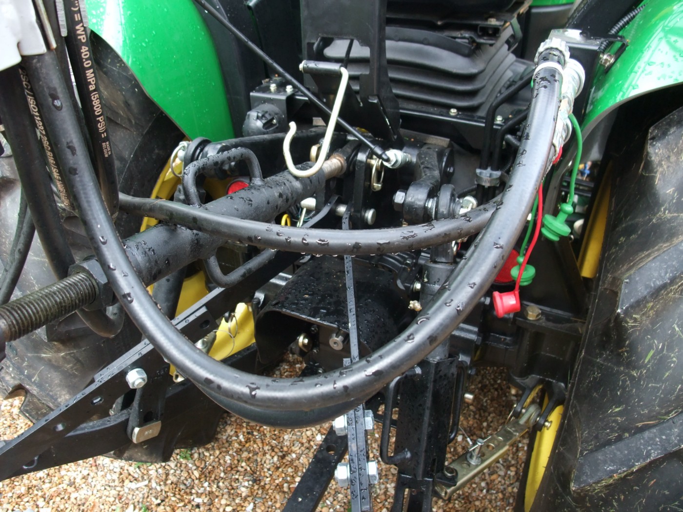

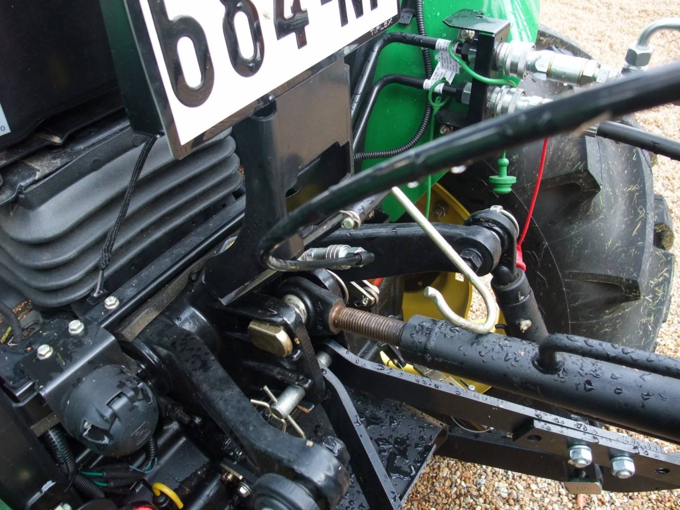

Got it back yesterday. All is well. I can say the finish on the new housing looks and feels smoother. It may actually be a little beefier. Not really sure.
