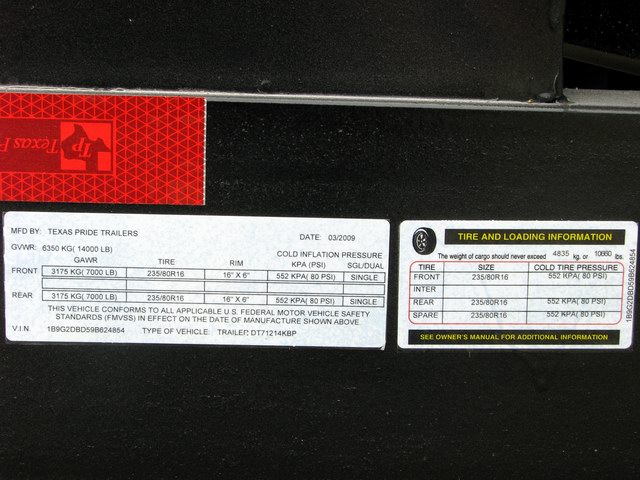

My new dump trailer came with D-ring tiedowns in each corner of the bed. Check out the load dataplates for hauling capacity. Also, the beds understructure is plenty strong for any hauling you might do. I think you'll be happy with your dump trailer even though they might cost over twice what the non-dumpbed trailers cost. The company that sold my dump trailer charges $1000 for each additional 2' length: 12' to 14' to 16'. . . .

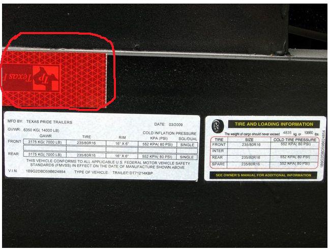

They need to take a little more Pride in their work
The DOT tape is upside down :D
