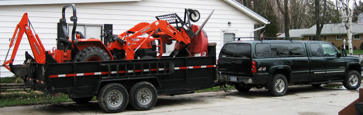

This is my 6'8"x16' trailer and 3/4 ton truck. With 7,000 lb axles I can carry about 10,000 lbs of payload. I upgraded the hitch receiver on the truck from the factory 2" unit to a 2-1/2" receiver (Titan hitch from Reese), and will be adding air helper springs and possibly a weight distributing hitch.
I highly recommend you check the load rating of your receiver, ball mount, and hitch ball; and make sure they are rated for the load you plan on pulling. My factory hitch was only rated at something like 7,500 lbs.
My tiller and post hole digger are in the bed of the truck. I have removed the SMV triangle placard from the backhoe so as not to lose it on the road. The picture was taken before the red flag was put on the backhoe bucket and a tie down was used to secure the loader.
Despite the disadvantages of weight, cost, and ease of loading/binding, dump trailers are pretty versatile and certainly suitable for hauling a tractor.

Marty, are you sure there's not a kitchen sink in there somewhere?:D;)

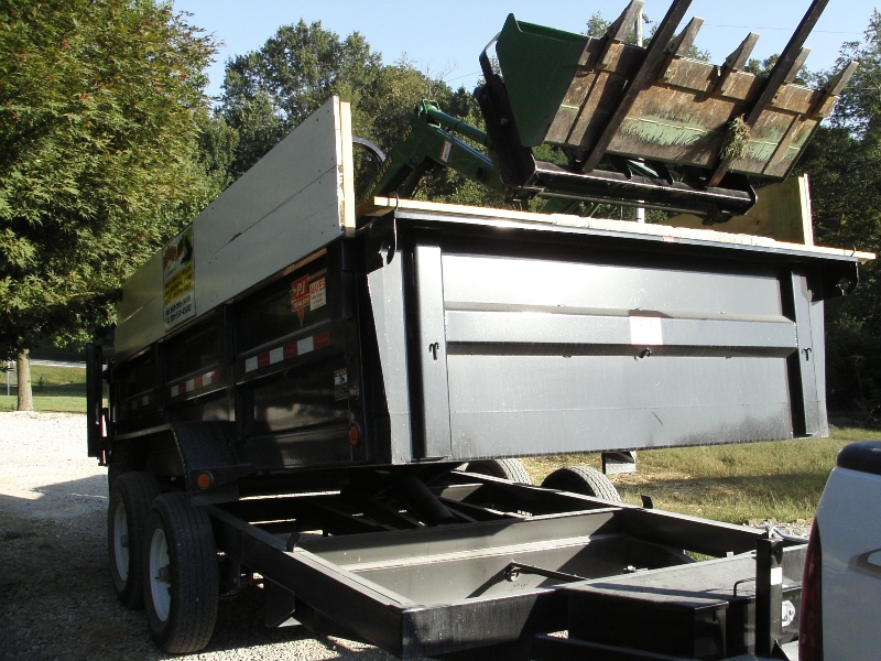

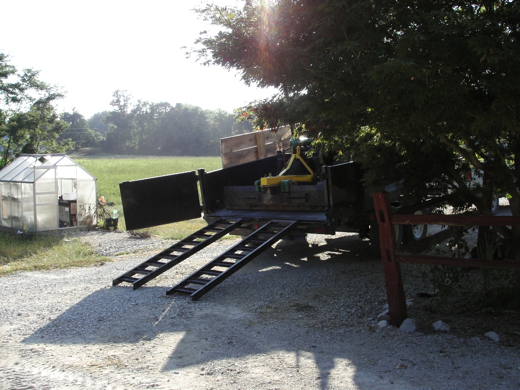

Agree. Best bang for the buck if you only want to tag and maintain one trailer.
If I were buying today I'd go gooseneck so you have a nice place to rest the bucket like Allen.

Kitchen sink...pretty funny stuff...I relooked at Marty's pic. That took some doing to get the bush hog loaded, everything looks pretty level. On my trailer, with a heavy load I use a weight distribution hitch. And the stock hitch was puny. I did as Q Saw did and put a Putman XDR class 5 receiver on.
