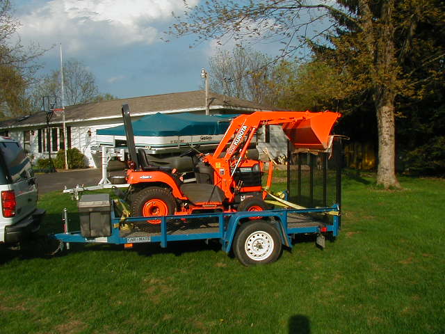

I have a BX1800 that I do haul on my 6x10' trailer, but have to rest the loader on the back gate to get balance correct, and even then it doesn't leave a good angle for the tie down straps. You also have to consider the mower deck if you have one. Mine is 60" and fits on my 76" wide trailer with the shoot up.
Here is a pick of how tight mine is without a backhoe.
You don't want to take a chance with a $16K + piece of equipment and your life.
