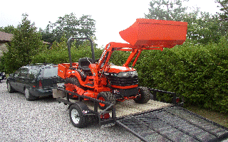

I would definitely NOT haul a BX22/23 with a 4x8 utility trailer. I use a 16ft tandem axle car hauler (attachment). Sure, you might be OK as some have offered, then again, with a 4x8 rig you are risking the pulling vehicle, trailer, and load if sudden stop/swerve is necessary. Pulling at steady speed on level road is usually no big deal. Stopping, hills, and idiots on the road are big deals (especially here in SOCAL). Be safe, use WAY more trailer than you need.
/ Hauling A BX23 #24
Rich, I'm looking at buying a Big Tex trailer like the one in your attachment. How is the clearance when loading the tractor? I am concerned that there would be clearance problems when loading the BX22 with the MMM attached due to lack of beavertail. Have you had any problems? Advice is more than welcome. Thanks.

Paul, can't help you with the MMM question directly cause I don't have an MMM (though I'd like to find used one for occasional duty). If you see the JD332 in the background on the attachment, the MMM is only a few inches off the ground in fully raised position. I suspect it is much lower than the 22 MMM would be in fully raised position. Don't have the JD anymore or I'd go measure it. It went on and off the Big Tex with no problems, tho clearance was a little tight at the rear of the trailer.

PaulZ, I have a 16' tandem trailer almost identical to RichT's. I have no problems with my BX22 + MMM. I do have to be careful with the backhoe and my Boxscraper (especially the latter). I usually back the trailer up to a bank in my front yard to get the ramps closer to horizontal. A dovetail trailer would be an asset with the BX22/23, but so far I've managed to work around the problem. I did look at a single axle 14' tilt trailer but went bigger for just a few more bucks. Hope it works out for you. I love my BX22!
