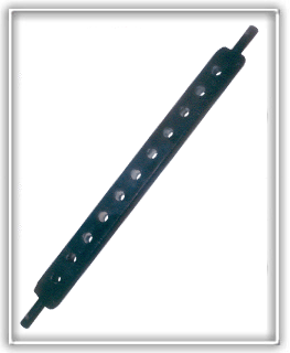

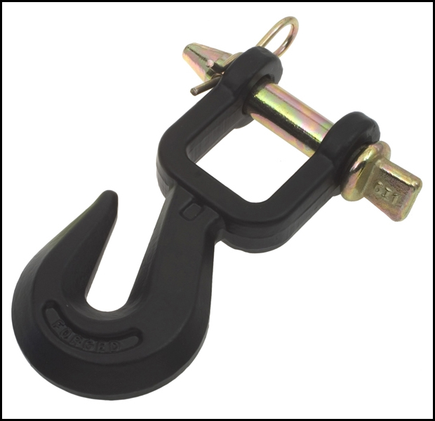

I'd go with options #5 or #6 they are the most appealing. However if you want the logs this winter you can buy the following items at Union Farm and be out of there after plucking down about $50. It works just fine. Draw bar goes into the lower links of your 3ph and the hook attaches to that. Buy a length of 5/16 or 3/8 chain with a slip hook at the end. Your total investment may be around $70 if you don't have the chain yet.
ps: with the box blade attached you may not be able to raise the end of the log off the ground.

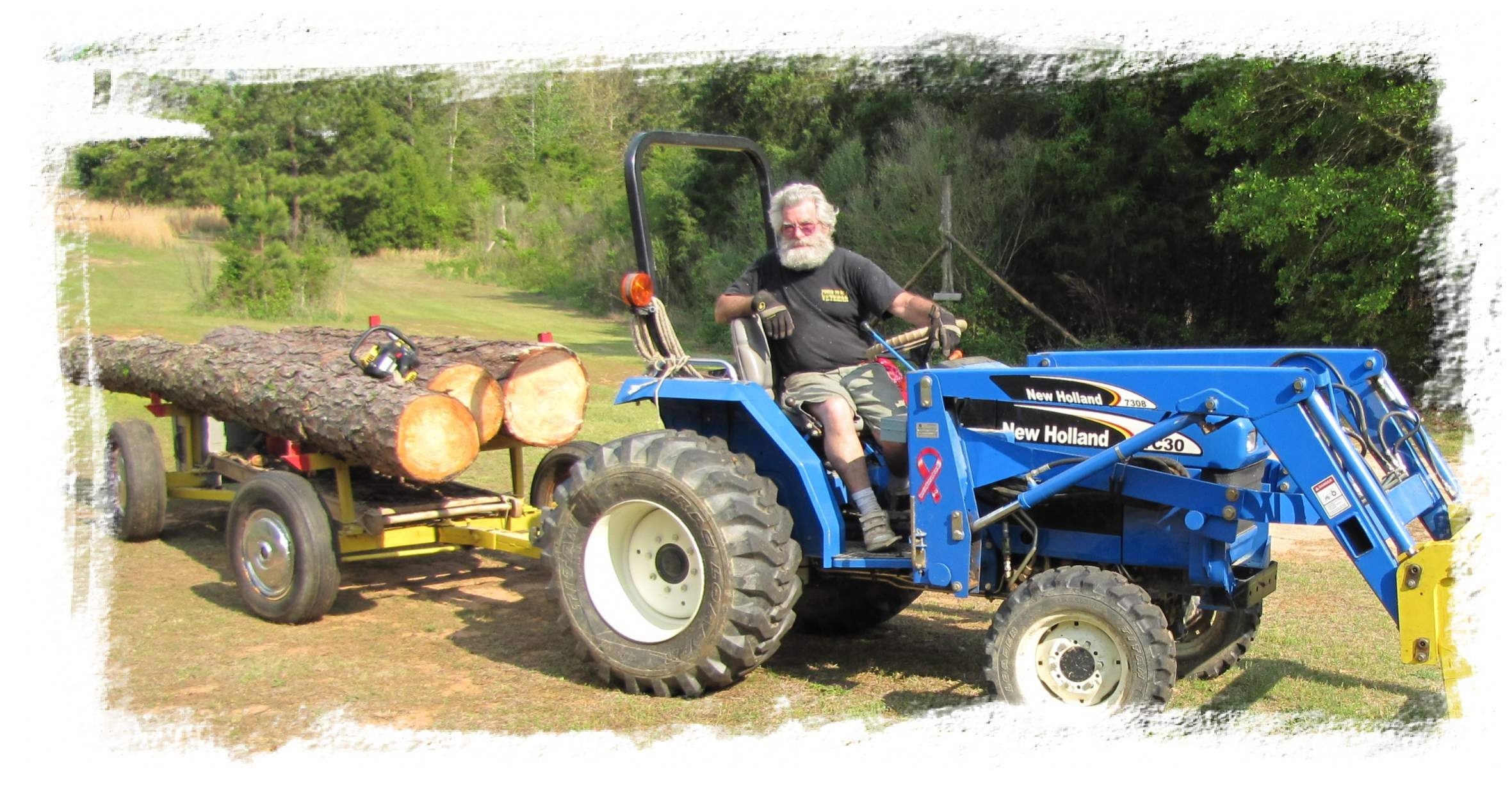

If you lived closer I would let you use my log trailer. I would Chane it tight to the box ,If needed put weight in the bucket.The first few feet will tell you how it will go. KEEP YOUR HAND ON THE 3PT. LEVER! AT FIRST SIGN OF problems DROP IT! Go slow youll do fine. Skidding tears up the place also gets dirt in the bark . So your saw will suffer.

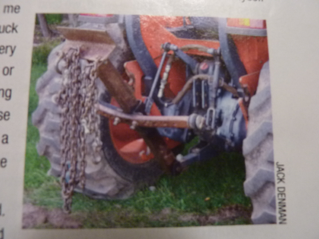

I would go with option #3 as shown by easygo. The pic below is a way to get more height if you need it using the cross draw bar but it reduces your lift. This is on a L3300 taking out big logs.
Your success is going to depend alot on the terrain you have to negotiate in as 20 20 alluded to. Your tractor is very small and light for those big logs. You will have to be smart and very careful to get it done safely.
It is dangerous work. Be careful and think.
