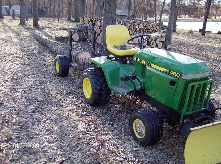

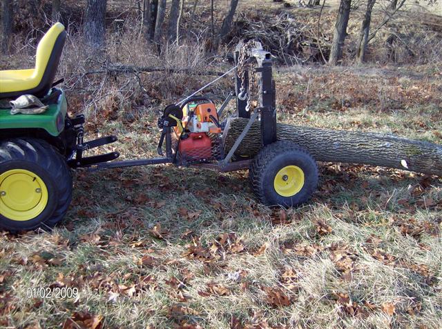

Make yourself a log arch! You'll want it a little bigger than mine, but they work great. ~~ grnspot
Didn't know what a log arch was but now that I see one it is along the lines of what I was thinking.

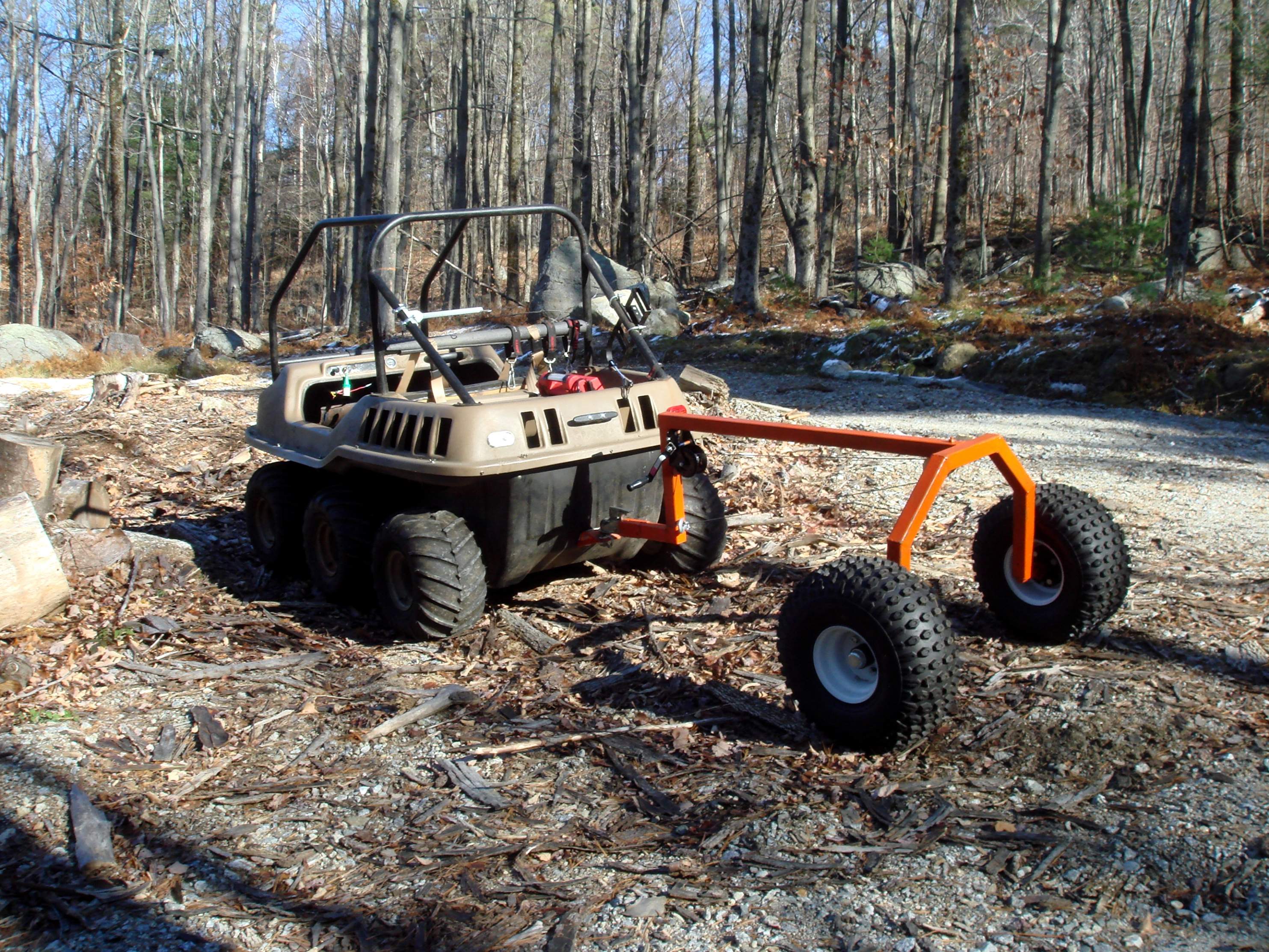

Ever seen a grasshopper? Used for moving lengths of pipe. Difference is it has a long arm on it about 12' and its placed near the center of the pipe (or log in this case) so its got all the load.
Grasshopper
you can clobber one together for cheap. go to a junk yard and get a couple front spindles from a car with wheels. one 20' length of 2"x4"x1/4" tube steel and some scraps of other steel plus some chain and you are in business. If you don't have a welder you should be able to find someone who does and could put it all together for you.

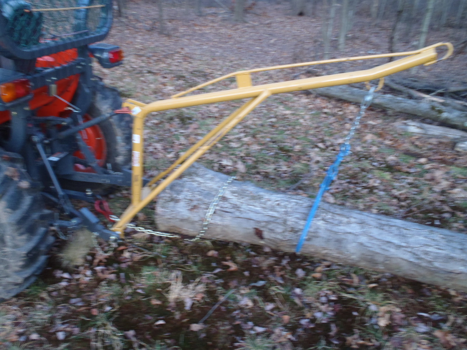

Here's my hitch ala Wyobuckaroo & 300UGUY (sorry for the blurry image):
I'm working on modifying a $69 Harbor Freight quick hitch into a skidder. The boom pole works, but has it's limitations. It really needs an attachment point about where the two stays are welded for better lift strength and to get the weight closer to the rear axle to reduce front axle lifting. The stays interfere with the log and the bottom cross between the 3PH pins always seems to interfere with the chain to the drawbar.
Working in the woods yesterday I made a real mess dragging this one log. I've been waiting for a good, hard freeze, but it's not here yet. I really need to make a log arch - or grasshopper - thanks for that link, sparc.
