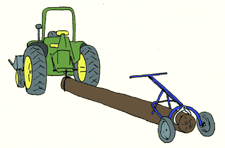

"A quick hitch could be used to lift, secure and control the butt end of a log. Cat 1 QH is 27" wide so your logs would fit nicely.
Then place a two or four wheeled fat tire dolly toward the middle of the log. Probably would have to be secured with chain and binder. Then tow away."
I came across this image on a logging website... and Logrite has a variation in a video with a larger arch up front and a smaller arch at the rear of the log.
My guess is that this approach might work fine but I would be careful to chain up the log so it does not roll.
