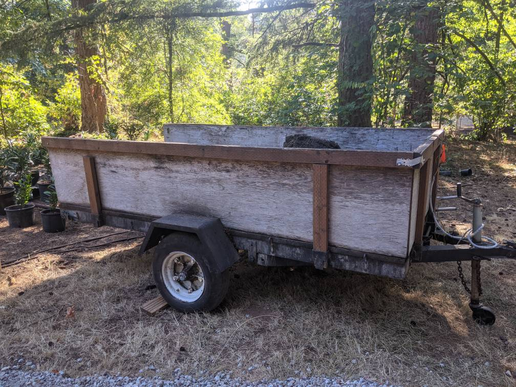

Here is the trailer that I hauled a yard of gravel in.

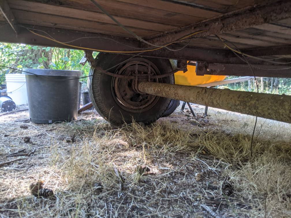

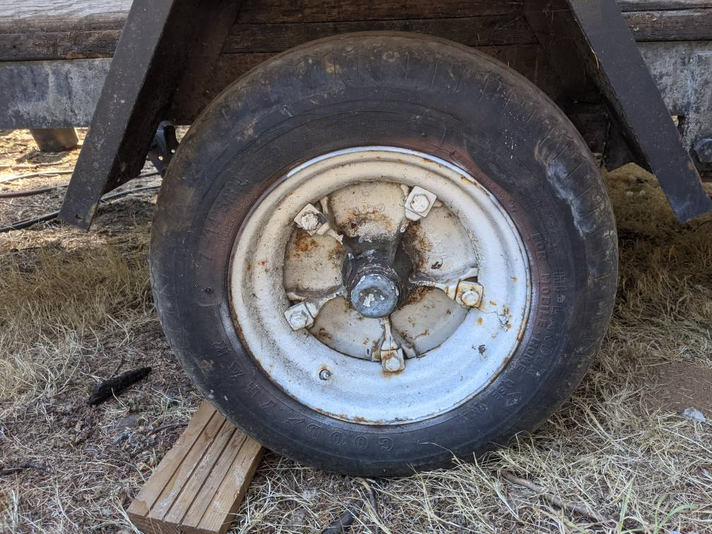

Here is the trailer that I hauled a yard of gravel in.View attachment 712158View attachment 712159View attachment 712160
That looks like quite a few homebuilt trailers I've encountered. The axle looks to be mounted at the midpoint of the cargo box, which balances the gravel load all on the axle (mobile home axle, too). Slipper springs, and light ones at that. A properly built box trailer should have closer to 60% of the box in front of the axle, so that tongue weight increases as the load does. Proper tongue weight is important - too light will cause the trailer to whip at speed, and that's pucker time! Quite often results in a very bad day.
I've got a 5x8' box trailer with 2' sides, commercially built, that's rated for 2990lbs - because 3000lbs requires brakes. My wife filled it full of broken roof tiles once, over 5400lbs of them! Just because the load fits in the trailer doesn't mean it's safe.
I travel a mountain highway nearly daily for the last seven years, and have seen many accidents related to improper use of trailers. I own five trailers currently, and use them all. Each has it's purpose, and I choose accordingly.
