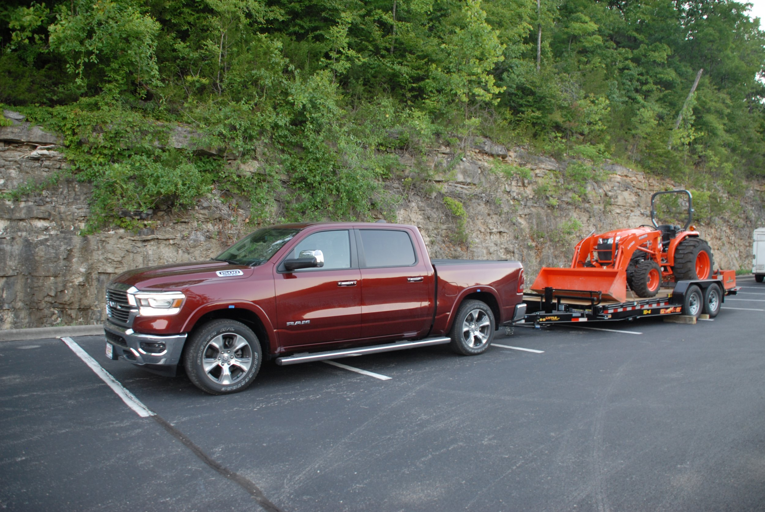

All you need is good trailer brakes and weight balance. If your underpowered, then gearing and patience. For instance, this set up here requires all of the above plus an additional abundance prayer. :)
That may be a smart car, but not smart driver. Ha

I tried hauling my BX on a 16" equipment trailer with a Dakota pickup. I rapidly determined I had the tail wagging the dog.
Well there's your problem. I hope you meant 16' trailer, not 16". :)

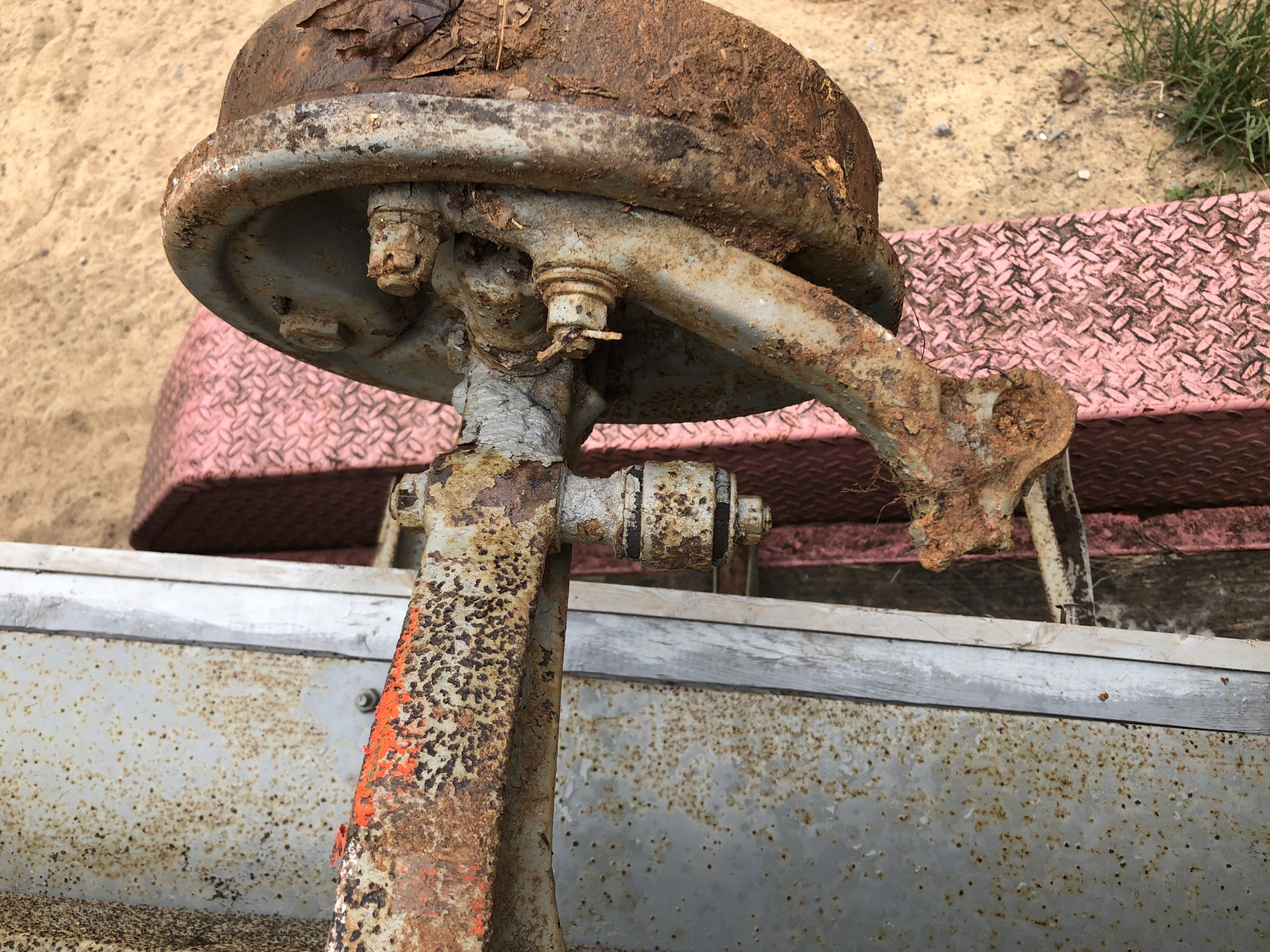

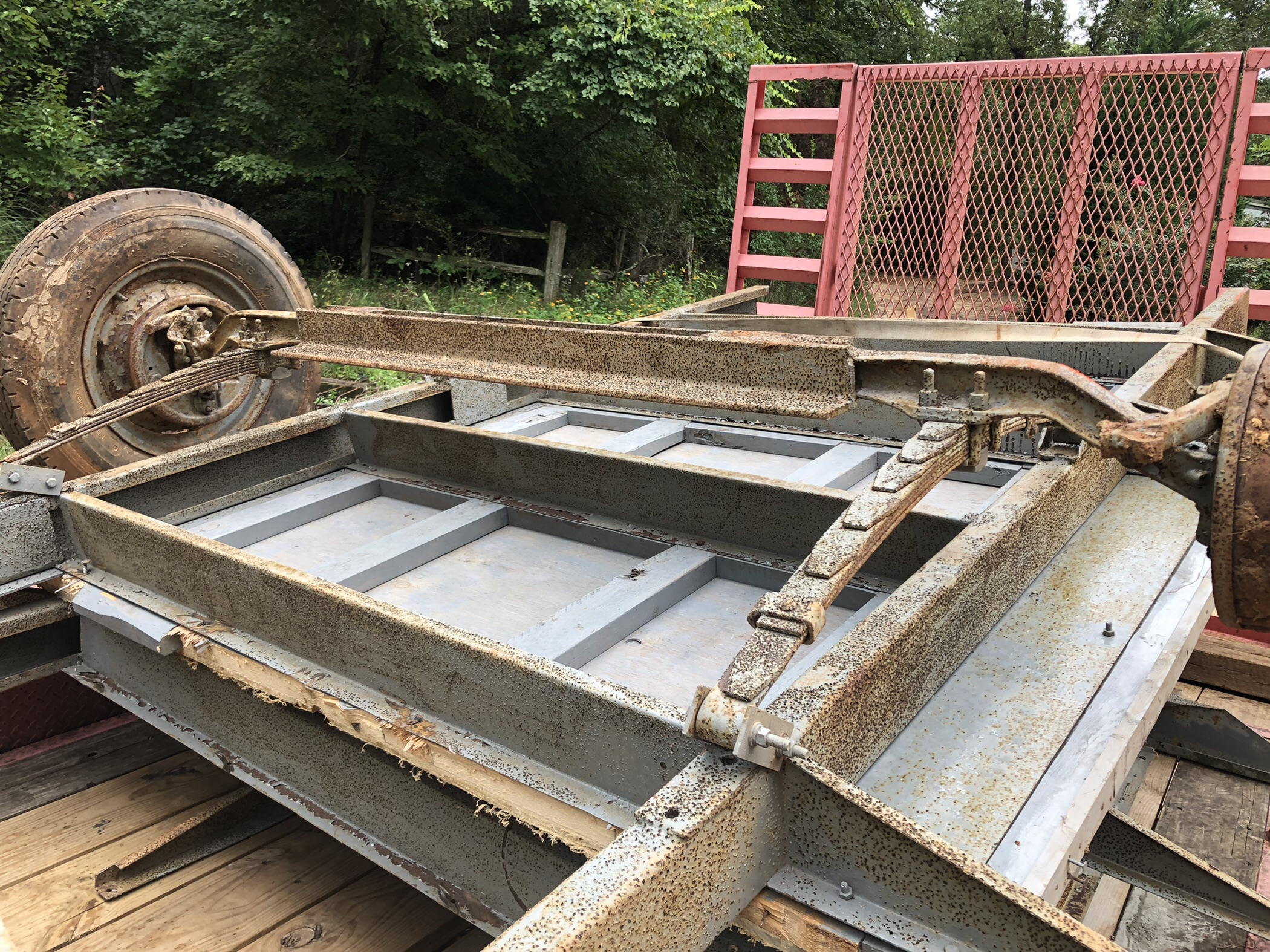

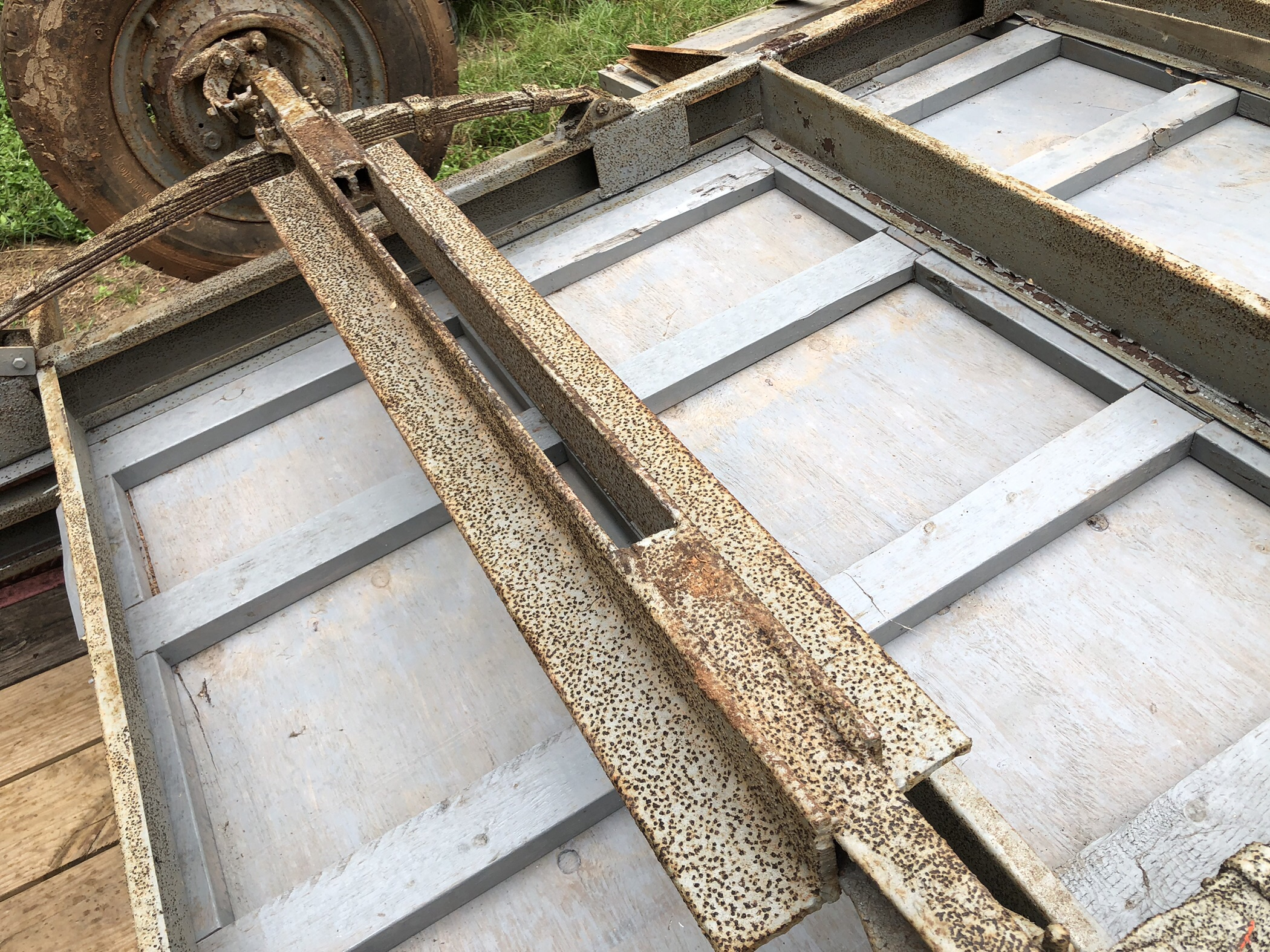

I just scrapped a 24’ homebuilt travel trailer I found on CL to get some steel to weld with. He told me if I brought fresh tires I could tow it home…glad I didn’t even attempt that method. Pretty scary that this was holding a 24’ travel trailer, he had torn it down to the deck before I got to it but the floor was 2x6, 2x4, and 3/4 ply construction and weighed a crap ton so can’t imagine what it wheighed as a complete travel trailer.
View attachment 712206View attachment 712207
NOT a mobile home axle. This is a older pickup front axle that has had the spindles welded to the axle and the axle itself cut in two and had some angle iron pieces scabbed on to make it wider. Even the springs and perches are from a truck. This is a recipe for disaster.
