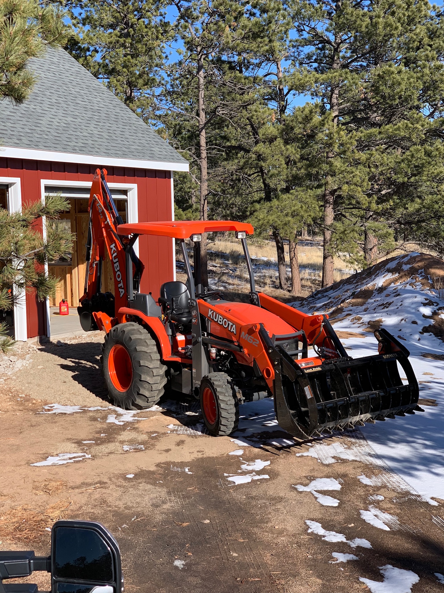

Well I dont have a work shot...ground is frozen in my area... But I did remove the grapple and put the bucket on yesterday! Hey I know you guys are experts but that took me a bit to get down :)
You got to find reference points on the loader and the bucket and sometimes that still doesnt help. Best advice is to be on level ground when you take it off and it will go on better. Sometimes I set it down on uneven ground and when I pick it up I can see its not right so I go find a level spot to set it back down on. Now if it only half catches I stop right there and do it again. Sometimes I can push it around a hair and get it on uneven ground. Other times I think it is spot on and it is a hair off. Usually when this happens I can set the brake, stand on the right / passenger side of the machine, set it down moving the loader stick and turn the steering wheel one way or the other to get that hair worked out.

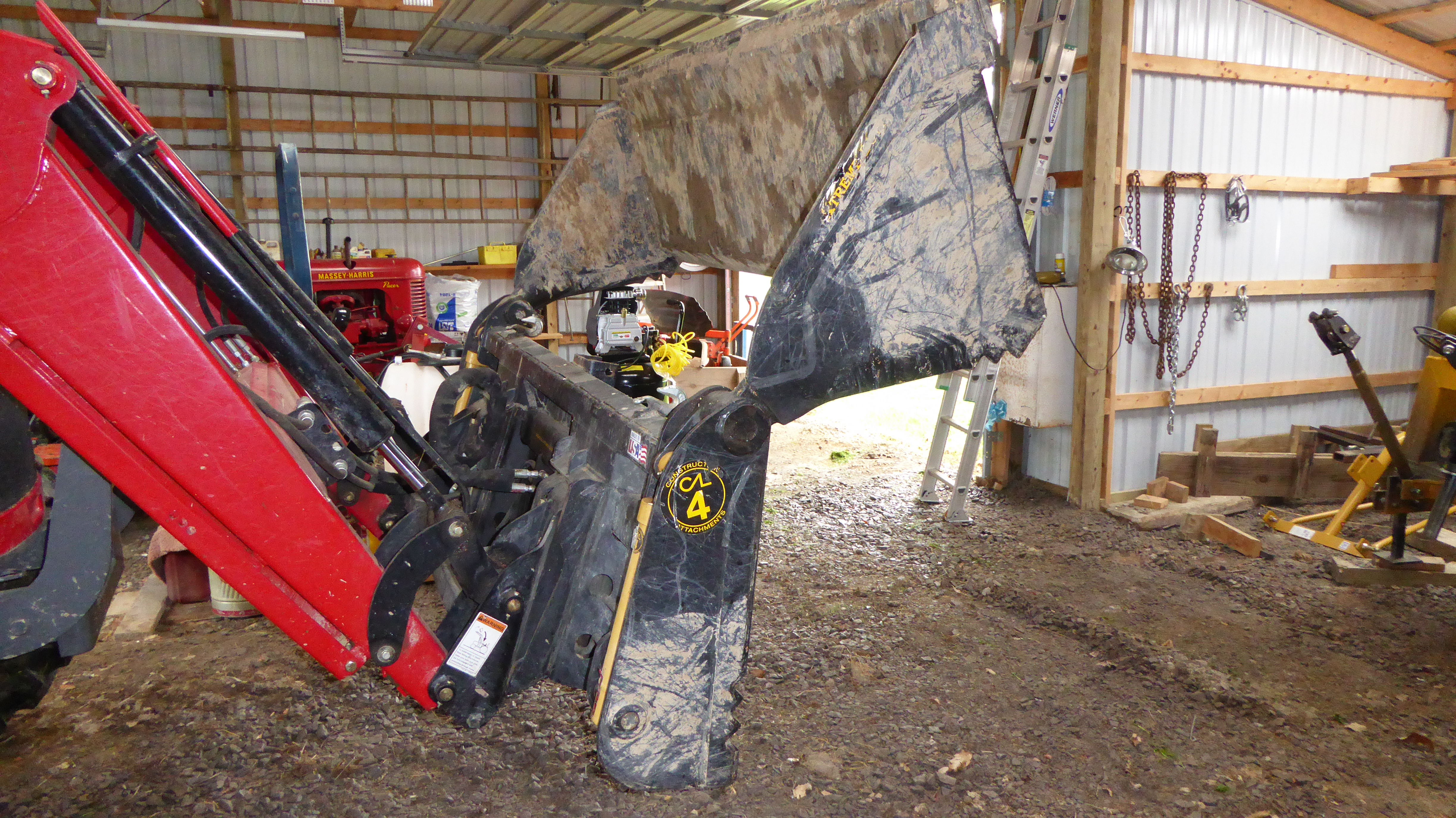

Scotty your first para above is exactly right on for what I go through my MF2660 loader and the SSQA attachments. First year I had it (2011) I bent the crap outta the cross bar on the SSQA adapter on the loader because I picked up an 1100 lb bucket and did not know it was only hooked on one side. A couple hundred dollars later and wiser, like you, I stand up and peer around the side to get a view of the connection points.
1,100 lb bucket is a monster. I think the M62 is about 700 +/- pounds. I know now when I take it off I have to raise it up and hit the bottom of the pins to get them to come out. Only on the bucket. Not the grapple, hay spear, forks, etc.
I suppose an 1100lb bucket is somewhat heavy but for a tractor that weighs 5 tons fully equipped and has plenty of hydraulic lift, that weight has never seemed like a problem. I will say when filled with mud cleaning out springs it is a worst-case loading. I have no experience with a lighter "stock" bucket.

My grapple is 920#. No issues throwing it around either!
