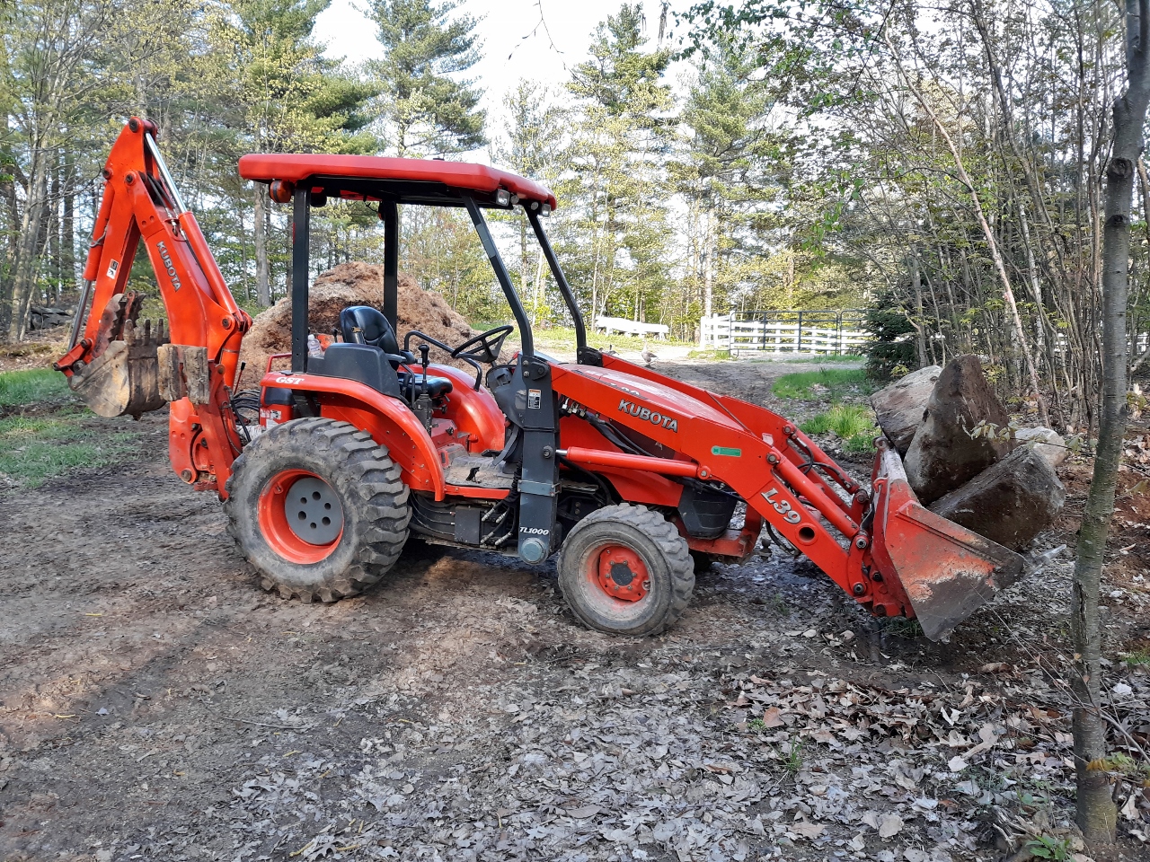

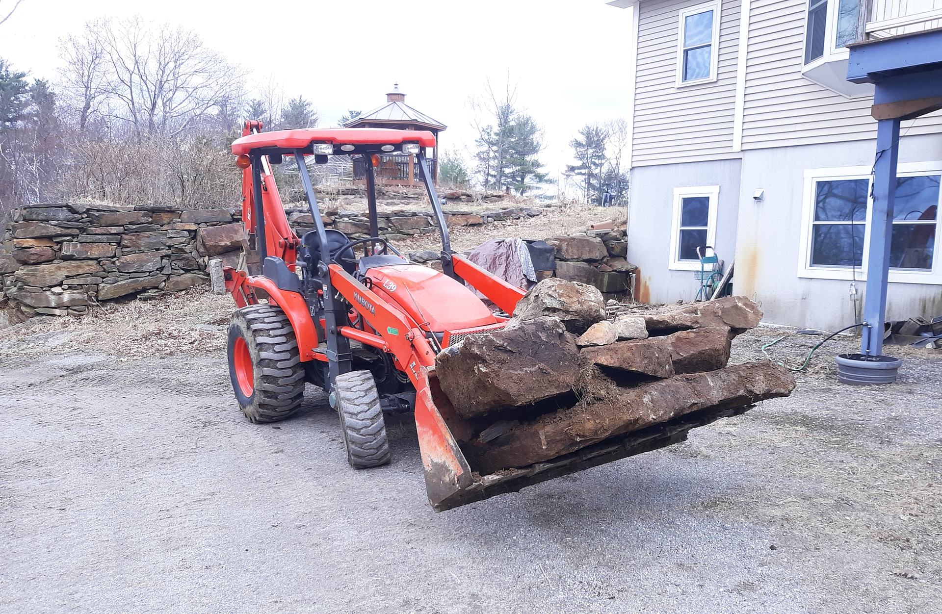

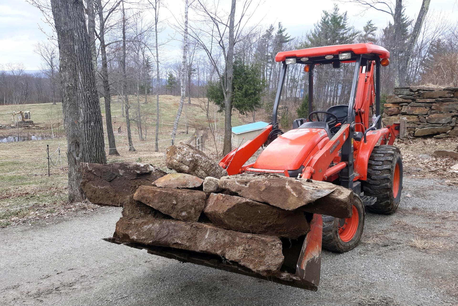

I was kind of questioning a front axle failure on a M62, as the M62 has a lot more front axle than my humble +2200 hour L39 that I incidentally never ever overload?
   / Having a blast with our new M62 #180
The real surprise is that the tires on the front of that L39 didn't go flat ...Besides that you were able to pick up those rocks...
