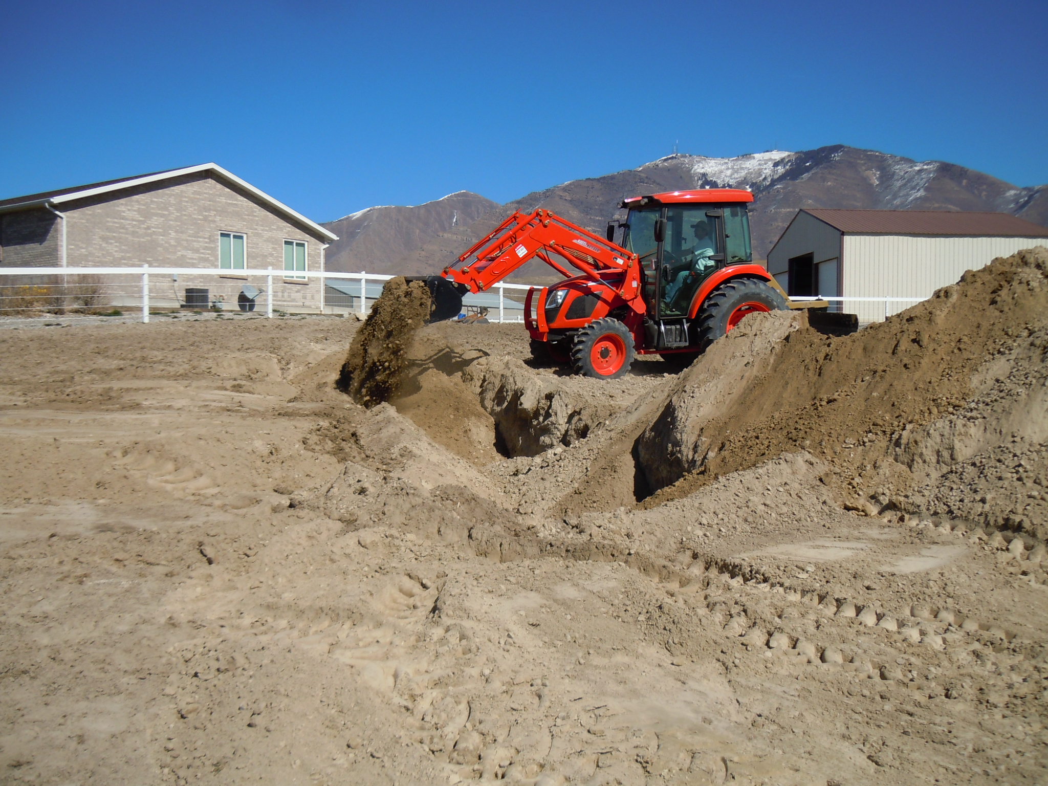

Being one who's intent was to buy a non cab model, I am very happy my wife insisted i get the cab. With all other things being equal (give or take) I would get a cab model. I only wish I had the money to have both.:)
I will add, I have not had one problem to date with my Kioti.
Here's the token picture.
