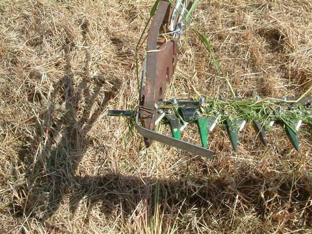

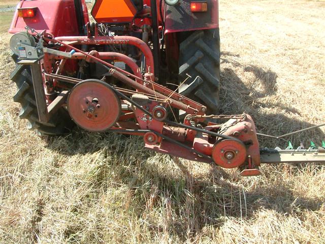

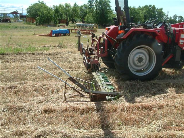

I assume you're talking about a sicklebar mower.
I have metal parts installed on my old 7-ft MF31 sicklebar to handle "end effects" like the one you described.
I've rebuilt that MF31 three times this year and it still needs more work to get it working the way it should. Such are cheap, old sicklebars--lotsa headaches.

I wondered if the sicklebar mower was the cutter in the OP's ??
In your second pic, what is the bent flat bar that curves toward the sickle bar at the tip? Seems that would fold grass (hay or straw) over leaving it long after the cutter bar passes by.
Or does it help move straw out of the way when cutting stubble after the combine leaves the field? Just curious.

These old sicklebars sometimes have worn parts on the outboard end that are difficult to get back into alignment. The result is clogging at that end of the mower. So I just added that piece of metal to keep the hay away from that part of the mower. It seems to work OK--that clogging problem went away.
