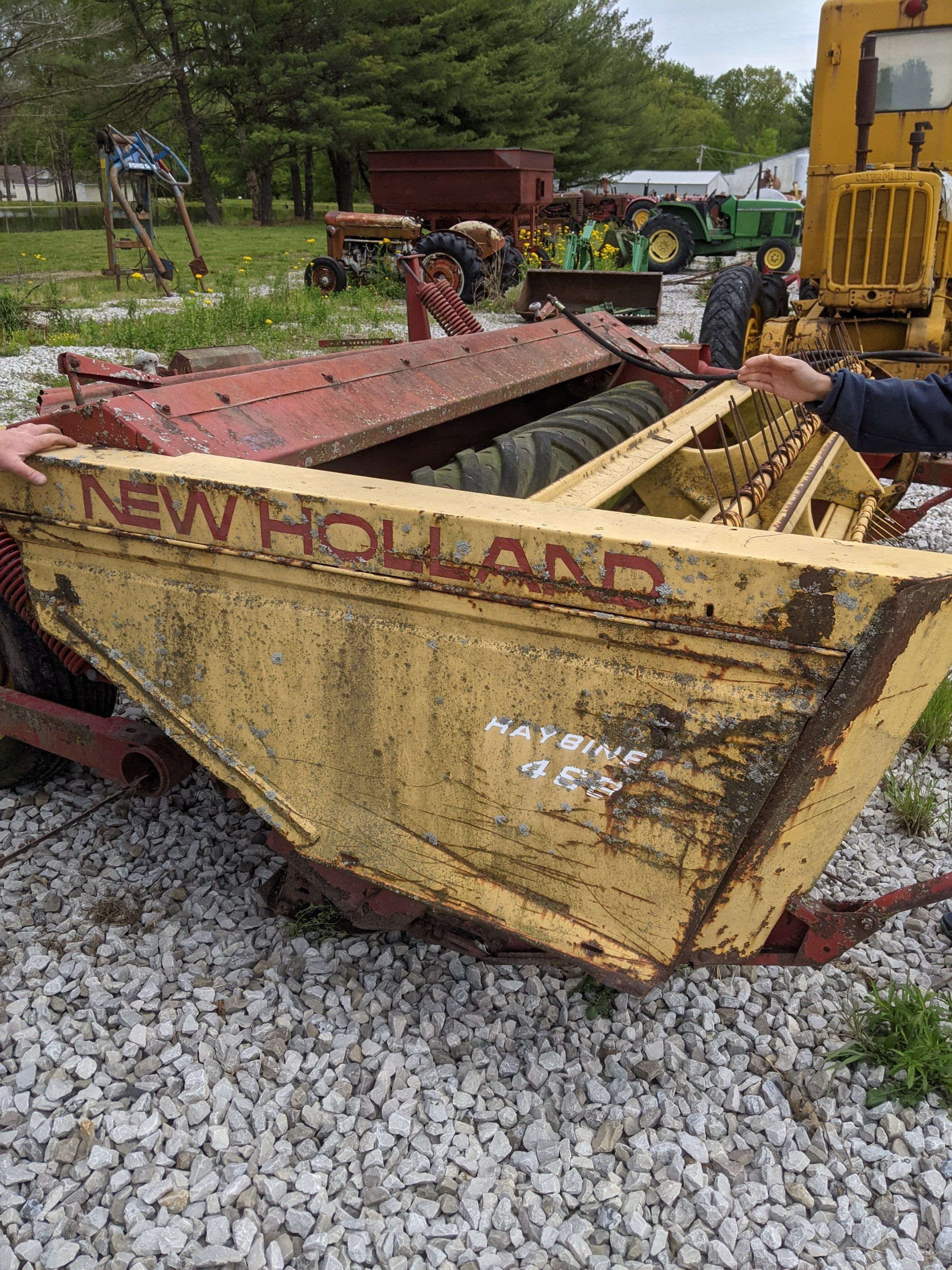

Saw this haybine when I was looking at used equipment. $1500, supposed used last year.
Located in central Indiana. Wasn't planning on tedding. So not sure if haybine would be better seems to dry faster with it. I was really drawn to the drum mower for it's simplicity and reliability.

Haybines are slow as molasses and plug if hay is heavy, but they do have the conditioning. Conditioning decreases dry time.
I am making 1500+ tons of hay a year, so I am always thinking about speed. Maybe speed is of little importance to you, so haybine would be ok, but they still plug.

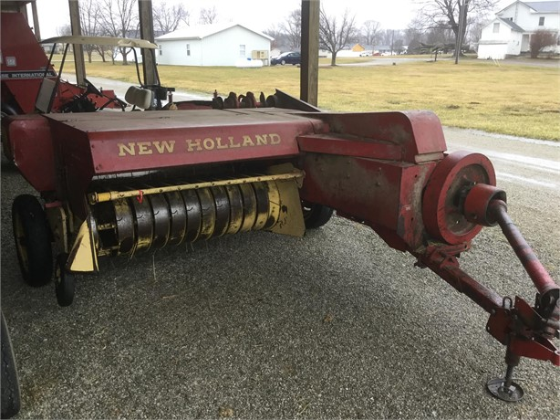

New Holland 268 Baler $2400View attachment 696581

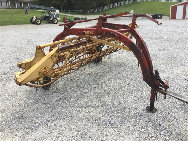

New Holland 256 Rake $1650

I think for small squares, the absolute oldest balers to consider are the JD336 and the NH273. Those are 40 - 50 years old. There's just no savings in going older. Balers are like boats or old cars -- there's no book price. Everything depends on condition.
For rakes, a wheel rake is, in my opinion, the best overall. Simple, no PTO or ground-driven mechanism. Rakes a wider windrow and an 8-wheel rake is perfect for small fields. Easy to control windrow size by just adjusting your overlap. No adjustment, just lower the wheels and drive forward. Don't get a 3-point wheel rake. I'm talking about a pull behind v-rake.
A haybine does great on small acreage, but haybines and their cutting bars and guards really get beat up over time. I had a NH 479 that would break knives on the sickle bar every day and I was always replacing guards and various parts. I still use a haybine. But, I can see the argument for getting something newer like a disc or drum mower and not having yet another 40 year old bucket-of-slinging-bolts to try to keep patched up.
