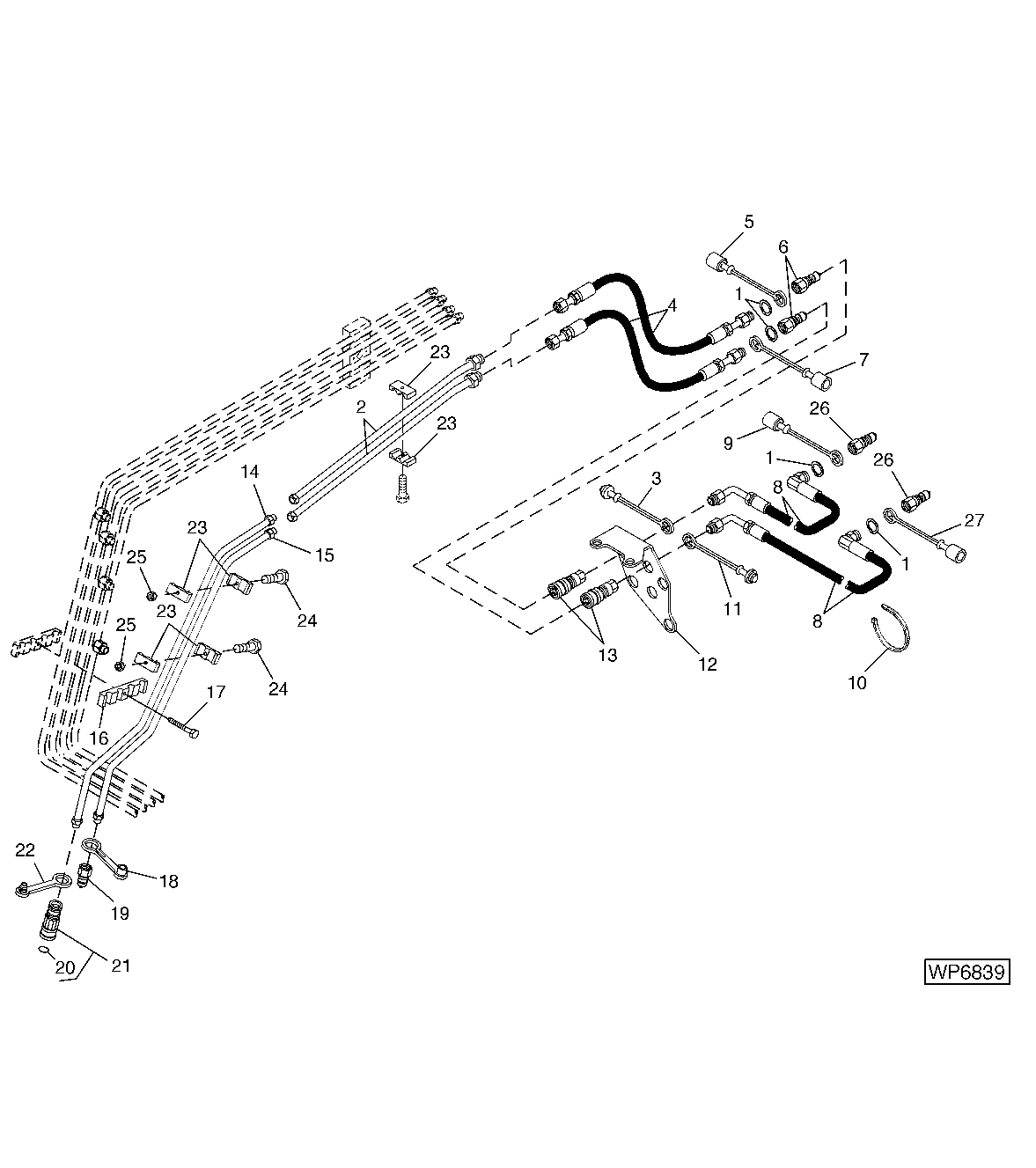

I have a 3320 that I would like to put a hay grapple on this spring, but I dont have hydro lines on the loader. I do have rear srv, can I hook onto that with lines and just run them to the loader? also has anyone used a hay grapple on that small of a machine? I know most guys use larger machines for hay so I havnt seen anyone online using one. Am I far off on thinking I can do this?

JD has a "kit" to do exactly what you want. It includes hose that run from the rear to the mid point where there is a new bracket installed, then hoses and steel lines that run up the loader mast to the front.

Yea. i saw that, but its a bit pricy, I just want it done right too tho. The attachments weigh like 500lbs I plus the bales. I dont think it will have any trouble lifting it. I picked up the back end of my truck before.:D
/ Hay Grappel #6
Call your local hydraulics store and price 40' of 1/4" hose, and 2 set's of QD's, then add in your time and a BUNCH of zip ties...
I think after you compare the prices for the homemade kit versus the JD kit that includes all the fittings, brackets, hardware, hoses and lines you'll find the price really isn't bad.

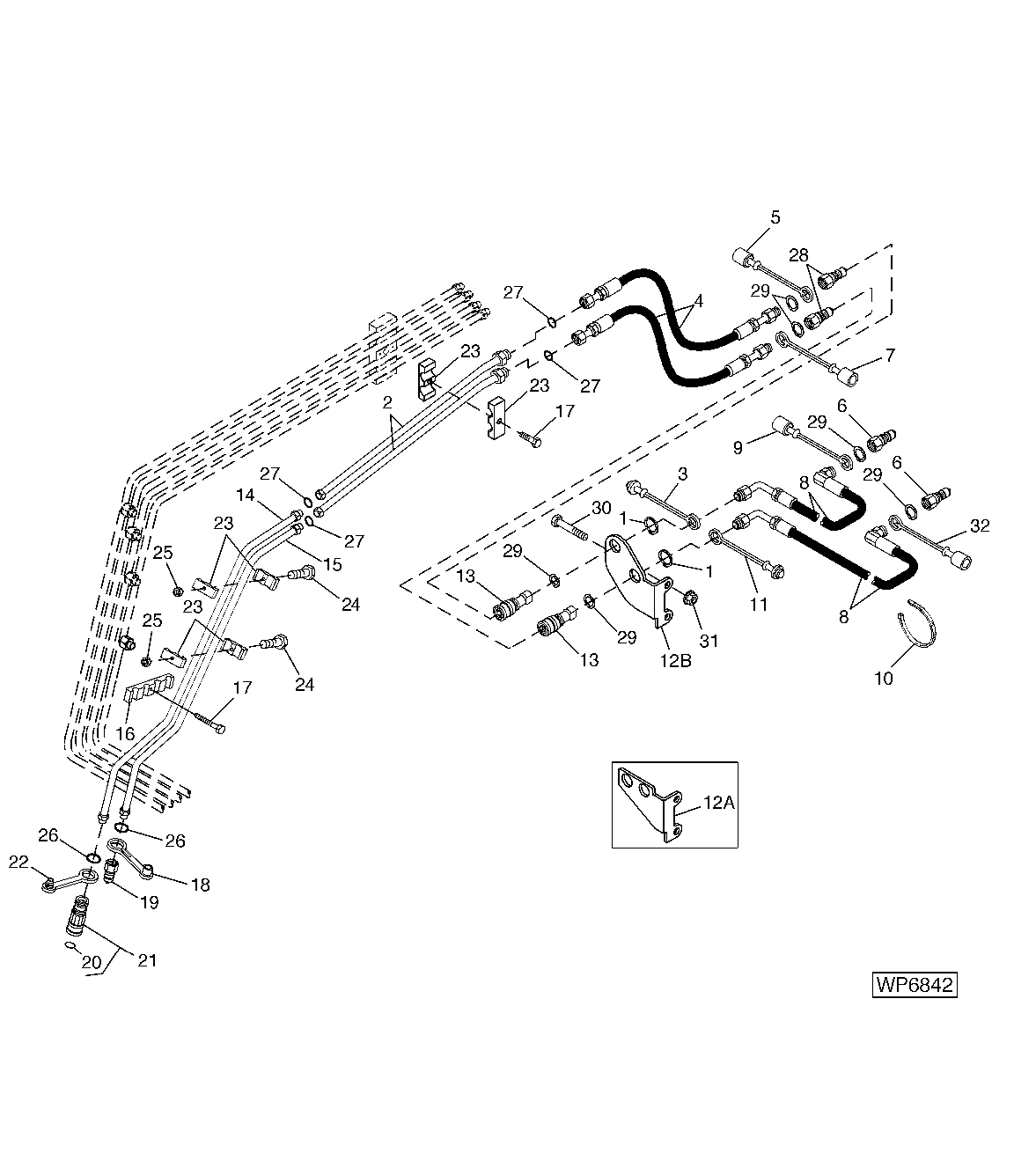

Hey Kenny,
Do you know if there's a kit like that for the 400x loader??
-Jer.
/ Hay Grappel #9
Hey Kenny,
-Jer.
Yes, there is, see picture below...There is one also for the 300CX (see picture), but at least one member made it fit his 300X with little trouble.

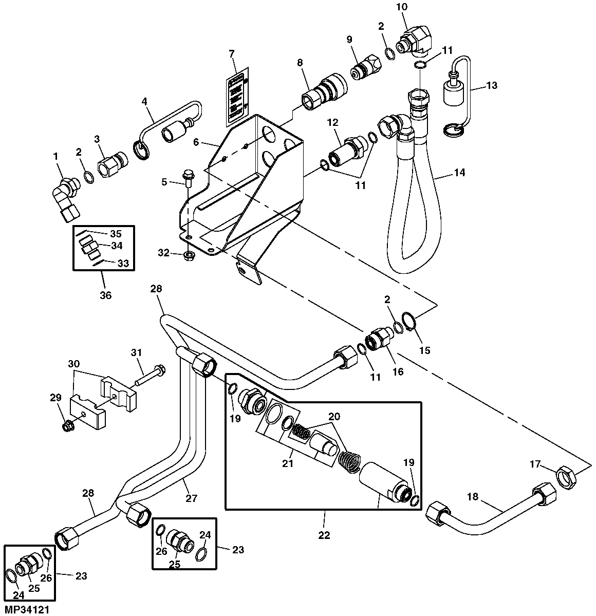

Do you know if the PB port is under the right fender on the 4x20's, as they are on the 2x20's???
-Jer.
/ Hay Grappel #11
-Jer.
I am pretty sure that where it taps into...You need to learn JDParts:D
