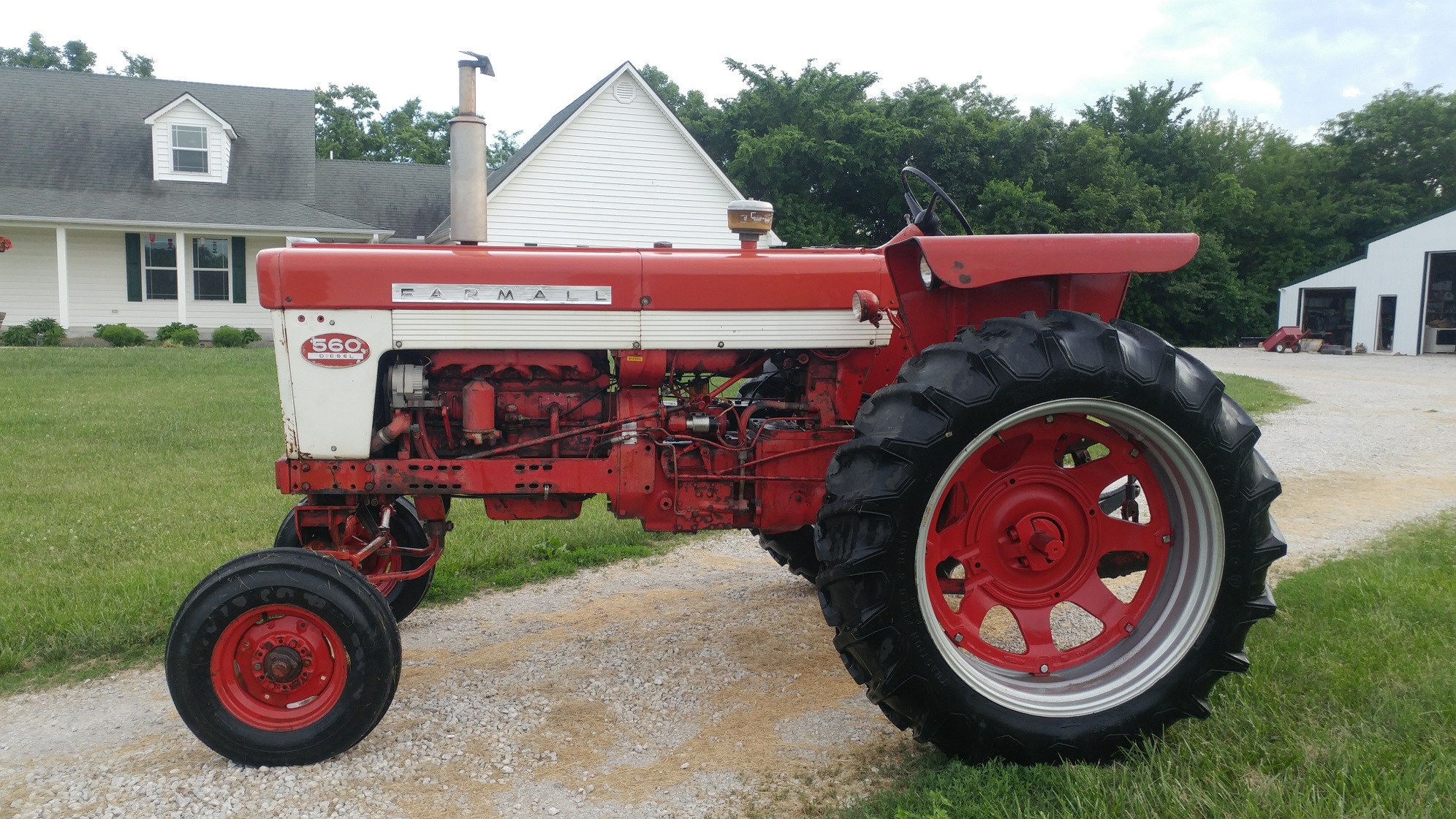

I like my 560 farmall and it would make a dandy haying machine..........its got plenty of power for such work as well as weight and GREAT brakes - I have stopped some very heavy load of logs on my 18foot flatbed and lugged them up some very large hills, I do have near new tires on it though.
Its a diesel and sips fuel..........I grew up on a 400 farmall and it was a great tractor as well, it would have plenty of power and be in that same price range, they are easy to fix as well. I did all of our mowing with an old JD sickle mower - I know most have moved on from those but they were great and never gave much trouble for me even as a rambunctious kid who didn't know what he was doing.
too bad you aren't closer, we have a ford sickle mower and I am going to sell my 560 as I just traded up to a 706 - and my 560 is well under your price range - 6500 for it and it needs NOTHING.....so good deals are out there just keep your eyes peeled.

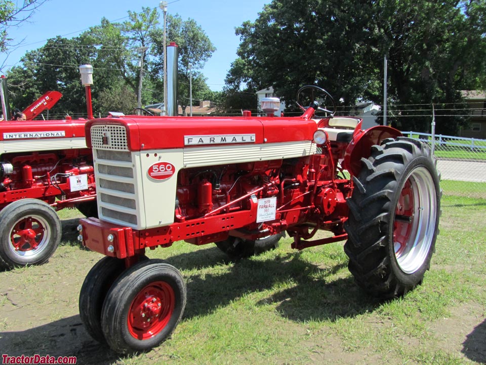

You're going to get very different advice from people who are experienced with heavy tractors on mostly flat land vs folks newer to the rural life, and especially those with hilly property. I think a lot of flatlanders have no idea what it's like in our kind of terrain. For example, if your WV land is hilly, an older Farmall may be risky:

A newbie city slicker might need 4wd that is heavy however if a person has common sense they would do fine with any 2wd 560 or 20 series deere or any wide front in that weight range - the one you have pictured is a narrow front tractor - there is no way I would recommend a narrow front tractor for any kind of ground and work that is NOT level - that spells trouble - I grew up with a narrow front JD model B and a Farmall 400 with a narrow front, the 400 even had a koyker Super K loader on it. I have traversed all kinds of hills and loaded hay and hauled manure with that loader and narrow front and if a person is careful and uses their noggin you will do fine on uneven ground/hills - HOWEVER - I didn't try things that were questionable that's where people make their mistakes - it only takes once - there were no such things as 4wd tractors back in the day and the ones today are light weight so to recommend a 4wd tractor would be overkill and would likely be out of their price range that is affordable in that hp tractor. Weight is important - Example...............a 2wd truck/tractor at a tractor pull can out pull a 4wd pickup due to weight and tire size, your 2wd tractor in that age/weight range is going to have a larger foot print and the weight distribution is different on a rwd tractor - for their price range they are going to have to go smaller/lighter/less hp to go 4wd. I would not recommend that for them. 560 left side reduced 50 percent.jpg560 front lights on.jpg
