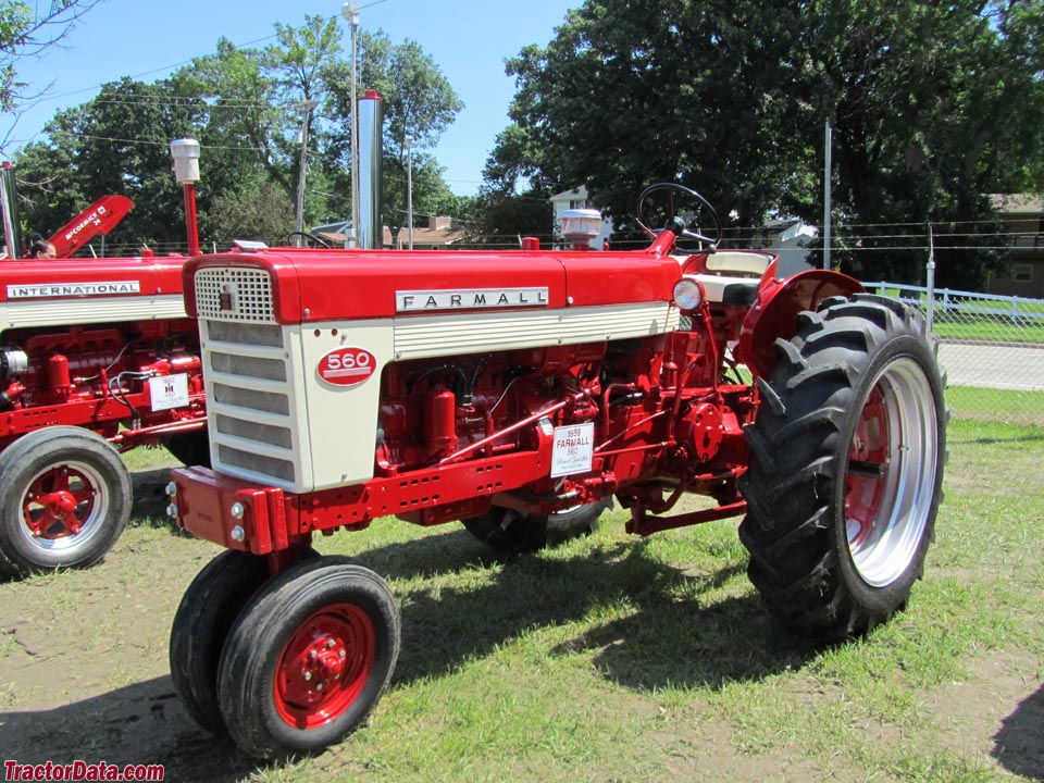

Nope, not enough weight to that tractor. Can you give us an idea of what you want to spend on just the tractor?
Thanks for the helpful feedback. We were thinking 10K, but the feedback on this site is not encouraging that price point. Hmmmm. Well, I’d rather know now than be surprised later, or spin wheels, or buy a machine that’s not up to the job.
/ Hay Making Equipment: What Size Tractor? #22
10 grand will certainly buy you a decent heavy tractor with 50 hp. Keep your eyes open for a John Deere 2010,2020,2030, Ford 5000 series, a lot of times you can find one of these gems for 6 or 8 grand is good shape, there heavy, strong and easy to fix, if you find something post it here and we will be happy to help. I hate to see people buy the wrong equipment for the task at hand.
/ Hay Making Equipment: What Size Tractor? #23
I like my 560 farmall and it would make a dandy haying machine..........its got plenty of power for such work as well as weight and GREAT brakes - I have stopped some very heavy load of logs on my 18foot flatbed and lugged them up some very large hills, I do have near new tires on it though.
Its a diesel and sips fuel..........I grew up on a 400 farmall and it was a great tractor as well, it would have plenty of power and be in that same price range, they are easy to fix as well. I did all of our mowing with an old JD sickle mower - I know most have moved on from those but they were great and never gave much trouble for me even as a rambunctious kid who didn't know what he was doing.
too bad you aren't closer, we have a ford sickle mower and I am going to sell my 560 as I just traded up to a 706 - and my 560 is well under your price range - 6500 for it and it needs NOTHING.....so good deals are out there just keep your eyes peeled.
I totally agree with all that atsah had to say and have survived wagon spills, wet hay, hot days, barns so thick with dust u could hardly breathe, burning hot belts, tying that was not right, bales that weighed WAY too much, falling bales from elevators, horses with an attitude, and the frustrating day of breakdown after breakdown after rain shower after rotting hay after people that don't show up after checks bouncing after etc................
but when the snow is flying and you are flaking hay and feeding like he said, its a great feeling to know you did it and provided for your animals and family

A newbie city slicker might need 4wd that is heavy however if a person has common sense they would do fine with any 2wd 560 or 20 series deere or any wide front in that weight range - the one you have pictured is a narrow front tractor - there is no way I would recommend a narrow front tractor for any kind of ground and work that is NOT level - that spells trouble - I grew up with a narrow front JD model B and a Farmall 400 with a narrow front, the 400 even had a koyker Super K loader on it. I have traversed all kinds of hills and loaded hay and hauled manure with that loader and narrow front and if a person is careful and uses their noggin you will do fine on uneven ground/hills - HOWEVER - I didn't try things that were questionable that's where people make their mistakes - it only takes once - there were no such things as 4wd tractors back in the day and the ones today are light weight so to recommend a 4wd tractor would be overkill and would likely be out of their price range that is affordable in that hp tractor. Weight is important - Example...............a 2wd truck/tractor at a tractor pull can out pull a 4wd pickup due to weight and tire size, your 2wd tractor in that age/weight range is going to have a larger foot print and the weight distribution is different on a rwd tractor - for their price range they are going to have to go smaller/lighter/less hp to go 4wd. I would not recommend that for them. 560 left side reduced 50 percent.jpg560 front lights on.jpg
/ Hay Making Equipment: What Size Tractor? #26
Yup a big ole International would do the trick as well, I like them also..

but to stay on track and their desires of squares, I would stick with a heavy 2wd tractor vs a light 4wd every time -
/ Hay Making Equipment: What Size Tractor? #31
OP lives in the mountains of WV. I was told here on TBN in no uncertain terms to get 4WD for my hilly/steep property.

I am not familiar with the hills of WV, I am familiar with the hills of upstate NY, the eastern side of the upstate area next to Vt., while most of our newer tractors are 4wd the tractors of the 50, 60 and early 70's where almost all 2wd and on top of that, most of them where narrow front ends. We baled an unknown number of bales in that time about 5-6000 bales a year to start and over 10,000 bales a year by 1970. Untill 1968 they were baled with a Farmall 400, then a Farmall 560 both with narrow front ends, a person had to pay attention to what they where doing especially when towing a wagon behind the baler, you would swing up empty and bale some of the worst the drop down to the less steep areas and finish the loads, there were some places you'd bale on the ground and then pick them up by hand but not many.
So simply put a 2wd narrow front end tractor is one heck of a lot better then none and when used with care is quite capable of working hills and hill sides, especially for hay as you are not working wet ground.
You people with your scare tactics about narrow front end row crop tractors are just creating paranoia among people considering them. And repeating heresy that you have heard.
