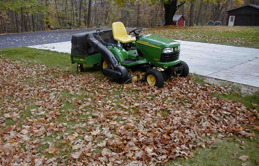

I've often thought that a leaf rake designed like a hay rake would work well for moving leaves, but figured the windrow of leaves would get large rather quickly. That would mean doing something with them either mechanically or by hand-carrying. Neither thought excited me.
Yesterday and today's wind of 50-55 mph has done a pretty good job moving my leaves away. There won't be much to do other than move into the areas where they have piled up.
I use a vac system of JD powerflo and MC519 cart.
Have used this cart now for 15 years and pick up leaves on about 6 acres of wooded lawn.
