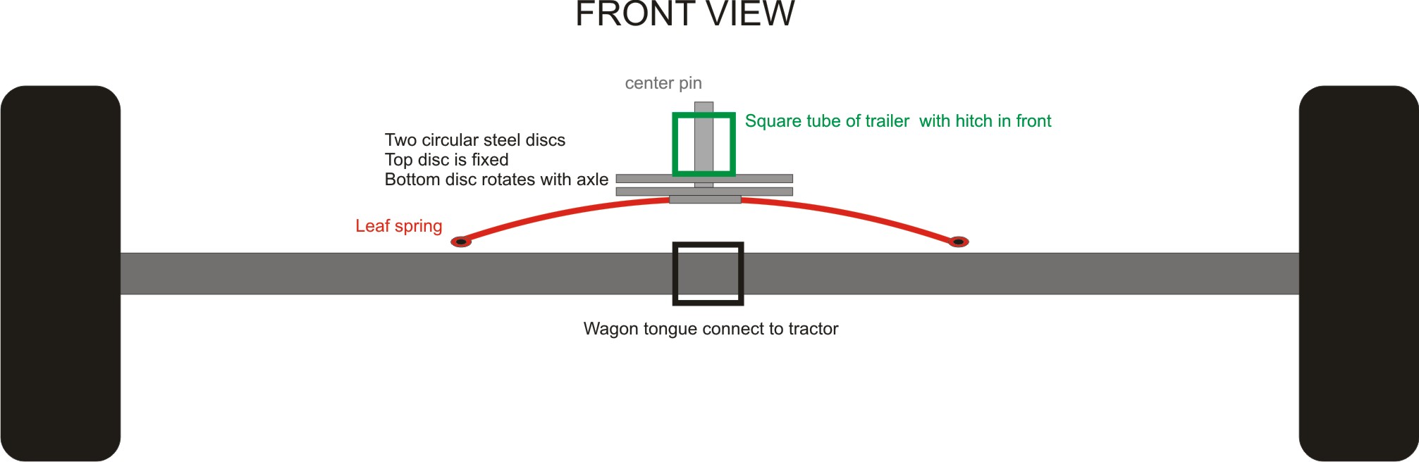

I was considering buying a used hay wagon for transporting people at a Halloween Festival.
Then I started thinking about the trailer I have and maybe converting it to a wagon.
It's a single axle trailer and measures 6' x 10'. I thought I could mount the front axle at the hitch.
This would give me another 3 feet in length. I wanted to do all this so it could be converted back to
the original configuration.Does anyone have any suggestions other than having my head examined?

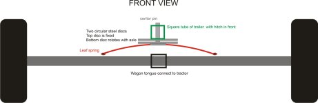

How about this if I decide to make the conversion?
/ Hay ride wagon #6
i think ya making mistake... if you have to go down ANY hills. and need to stop for any reason, the wagon/trailer with the tongue going to want to steer off to the right or left un uncontrollably.
major reason why hay wagons have the setup like you have drawn, is because farmers can pull multi wagons behind each other. and they need the extra turn in the wagons. to get them around corners. what you are trying to do... is for looks and extra danger IMHO (in my humble opinion)
