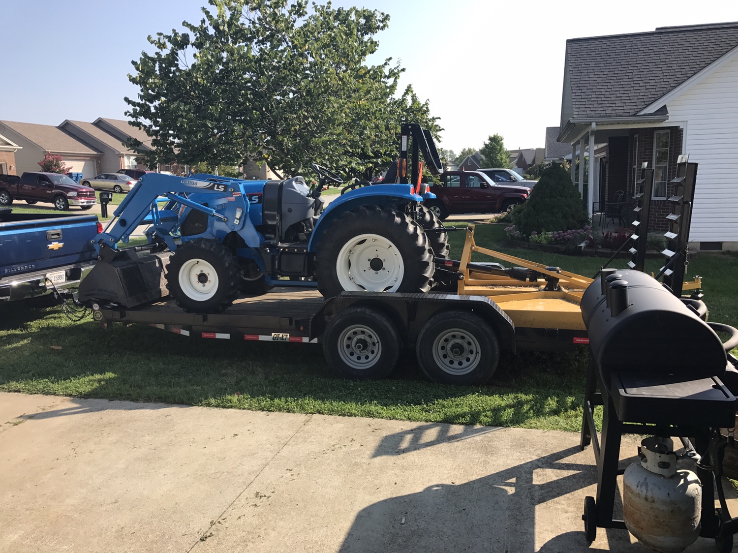

This weekend I decided I would haul my 55hp tractor and bush hog on my bumper pull. Weight is around 9k counting trailer. Truck did fine but I can tell you there's no way I would want to pull it on a bumper pull very often.

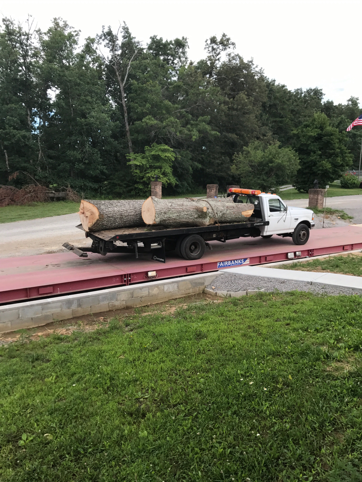

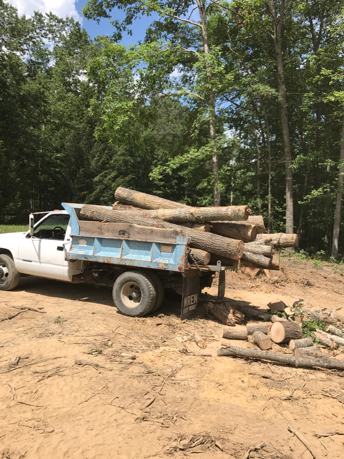

I'd say yes. This is an F-superduty ( 450 ). It weighed 22 k with that load. IMG_0077.JPG . My 3500 hauls 4 ton. IMG_9981.JPG. As far as towing I don't have any heavy bumper pull trailers, and use a 22k goose neck for that.
