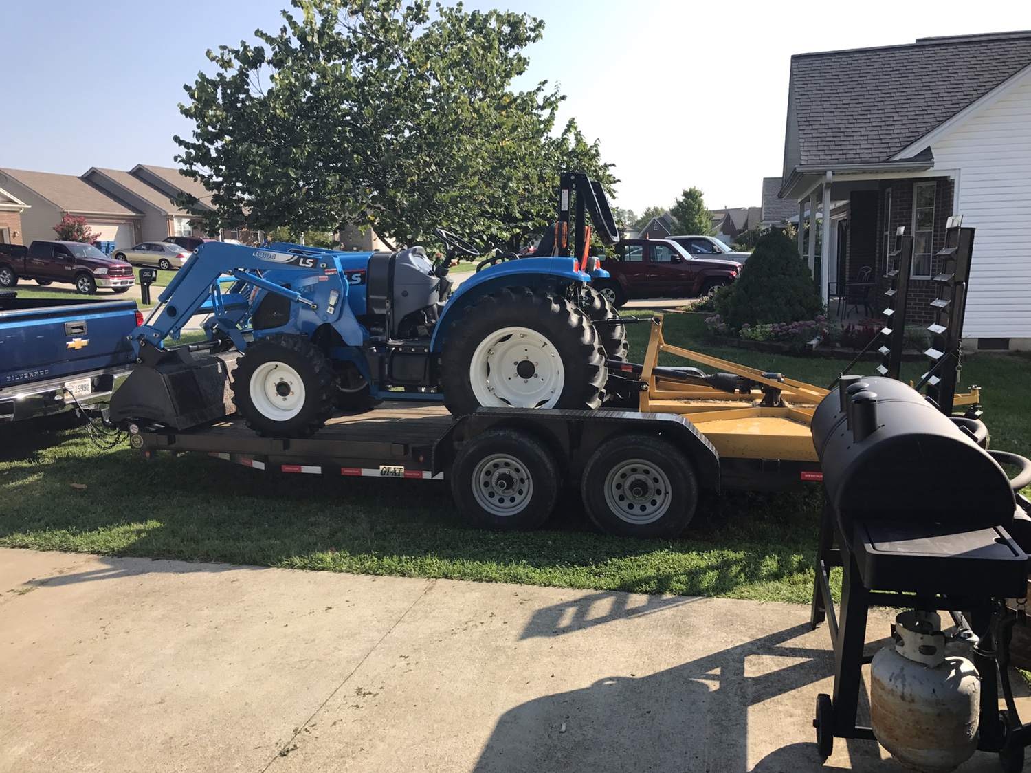

This weekend I decided I would haul my 55hp tractor and bush hog on my bumper pull. Weight is around 9k counting trailer. Truck did fine but I can tell you there's no way I would want to pull it on a bumper pull very often.
Just for the record I'm not bashing 1/2 ton trucks and I agree they are far more capable then in years past. I just think manufacturers are over rating them just to say ours has a higher towing rating.
