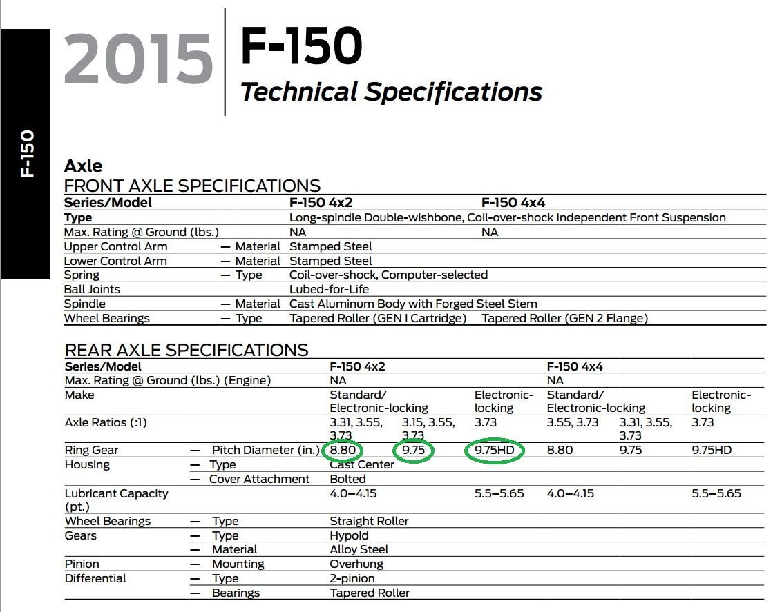

Some F-150's and the Lincoln trucks came with a 10-1/4 ring gear rear axle I believe. At least in years past.
The std HD towing big engine option (3.5 and 5.8L) ones are 9-3/4 and the regular F-150 come with an 8.8
Not sure what axle comes with a 2.7L with tow package.
I think ther is more than one style 9-3/4" axle.
   / HD F-150 or 3/4 ton truck?
#257
I found these in another forum (attached). Apparently there are two 9 3/4" axles - standard and HD. The fluid capacity is different. But even the HD is still a c-clip axle - not full floating. Axle capacity (4,800 pounds) is only a few hundred pounds more than the standard 9-3/4". This is all from 2015 documents. Don't know if anything changed for 2018. I'm guessing not.
