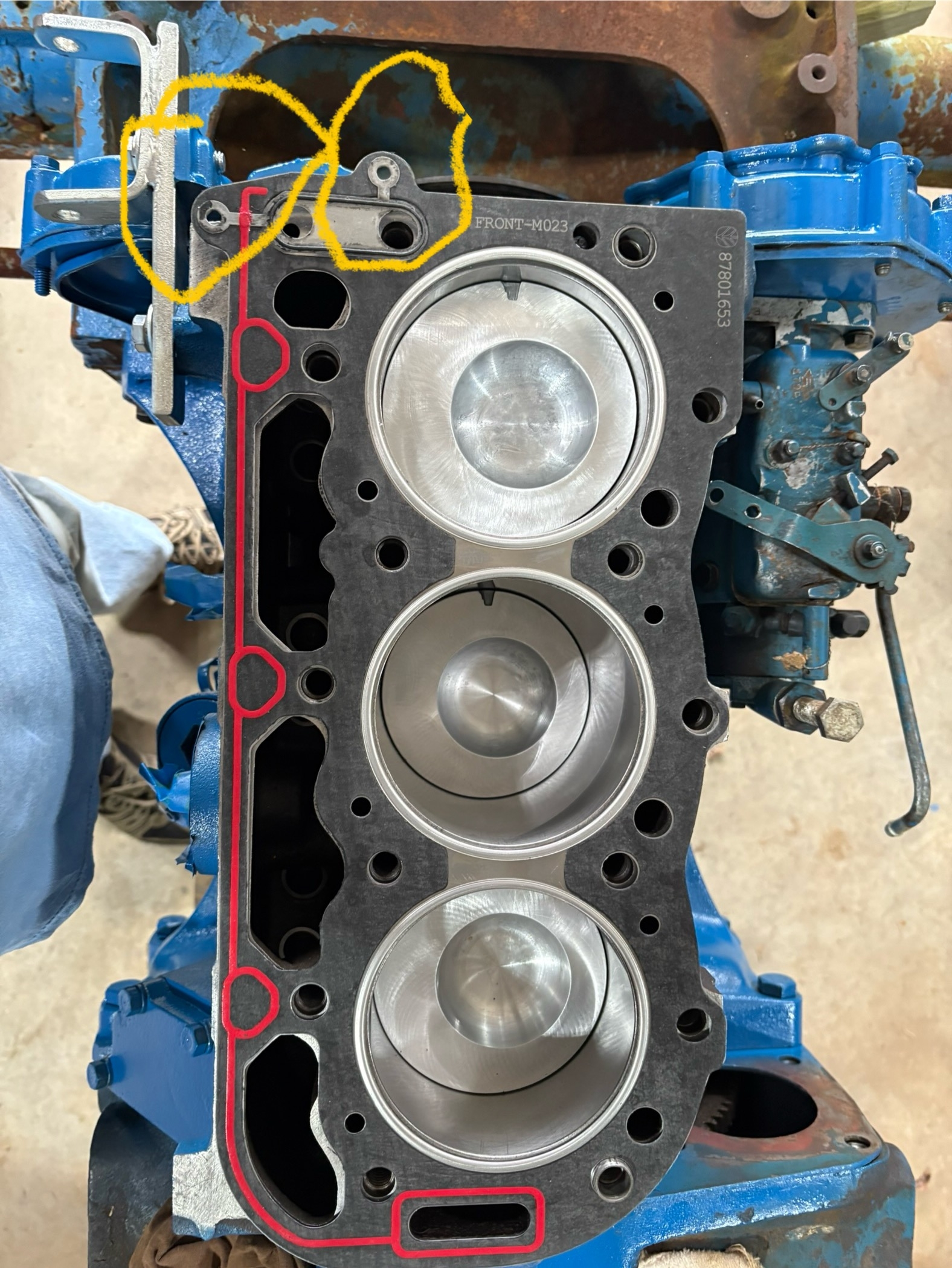

Nov 7, 2025 / Head Gasket #1 J Jbrandon New member Joined Feb 8, 2019 Messages 10 Location Southeast Alabama Tractor Massey ferguson 35 deluxe, Ford 4000 I have a 1970 Ford 4000 diesel. Ordered head gasket pt# 87801653 from New Holland dealer. This gasket has tabs that stick out past the head and block, see circles on picture. Will this be okay? Attachments IMG_5714.jpeg 1.5 MB · Views: 80
Nov 8, 2025 / Head Gasket #2 Roadworthy Elite Member Joined Aug 24, 2019 Messages 4,016 Location Southeast Washington Tractor Kubota L2501 HST, If it's the correct gasket and all the holes line up as they should you should be fine.
Nov 9, 2025 / Head Gasket #3 T TractorTech Elite Member Joined Jan 26, 2012 Messages 3,109 Location California Tractor Ford 7710, Ford 550, Ford 1910, Ford 4430, KD Forklift, Ford LGT17H, New Holland L255 Skidsteer I've installed several. Not sure what they're for, but it's fine
