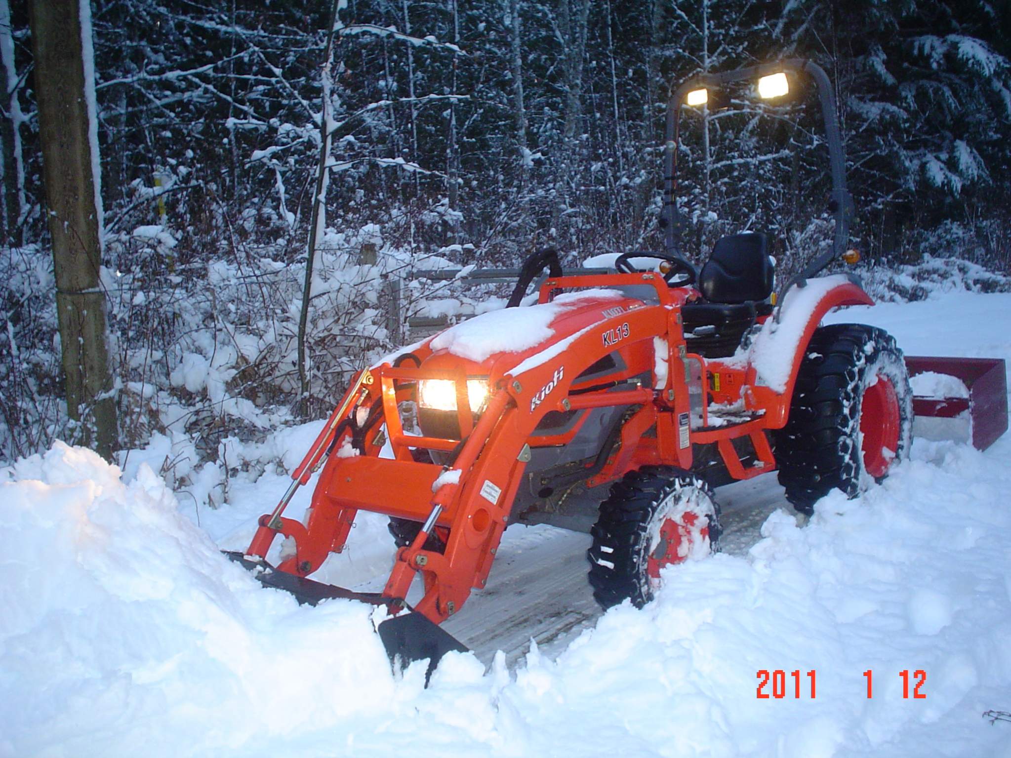

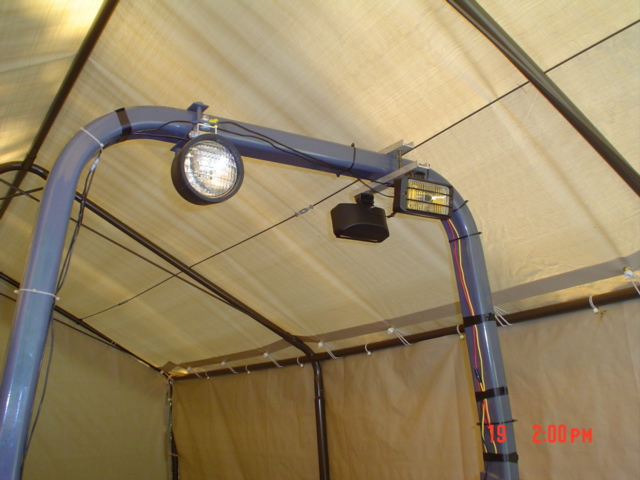

TractorCabDepot.com - Cabs, Enclosures, and Accessories for all your Tractor Needs has light mounting brackets for mounting lights, no drilling required. priced right too.
I simply used a piece of uninstructed I had lying around and two u-bolts inside of roll bar (no sun shade). Lights are up high and clear everything. Mounted a marine switch (no relay neededed if switch is properly rated and fused) in the plastic cowling behind the 3ph height lever. Two front one back. They work great.
There are several threads on roll bar mounted lights, with a lot of good photos. Just search for them. Here again is my "light bar". Don't have photo of switch mount, but another member actually gave me the idea and used a similar switch. He did post photos.
Nice job!!!
I think you meant "unistrut" rather then "uninstructed"...looks like a SpellCheck gotcha!

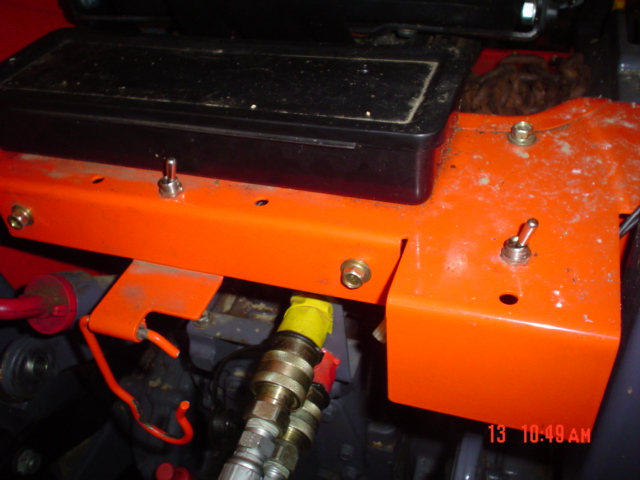

Part of the deal when I bought my tractor was that the dealer had to install front and back lights. This was mostly for snow removal, but it's nice this time of the year with the backhoe. He added a nice switch under the throttle, very clean and professional looking.
