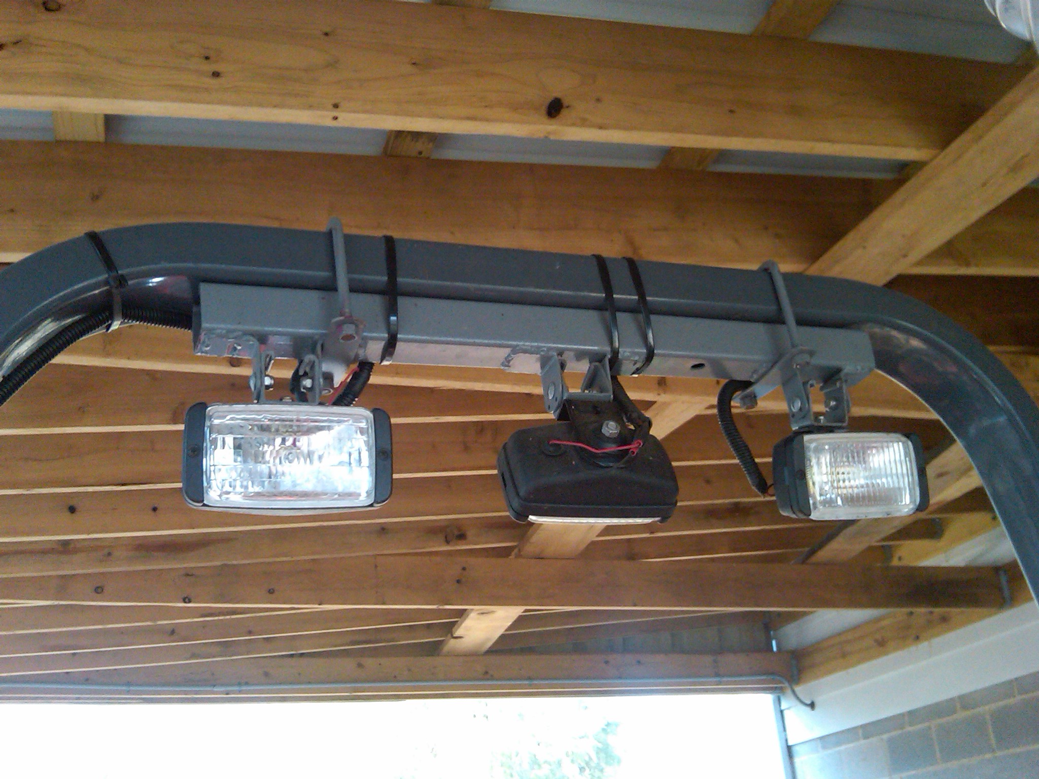

I discussed the pros and cons on the first page of this thread from 20 years of experience and DKVance showed you pictures of his lights mounted on the front of the canopy.
This is the best place to put them as they are somewhat protected, are high enough that your loader bucket and side frames don't block the light, and if you get ones with swivel mounts they are easily adjusted for the operation you are doing at the time. I turn one of mine a little further to the outside when mowing after dark, for example, to see the previous cut line better on my 8" finish mower.
You can see pictures of the installation and why to use a relay to protect the switch on my thread called " where are the Relays hidden"
http://www.tractorbynet.com/forums/...s/210716-where-relays-hidden-new-holland.html
