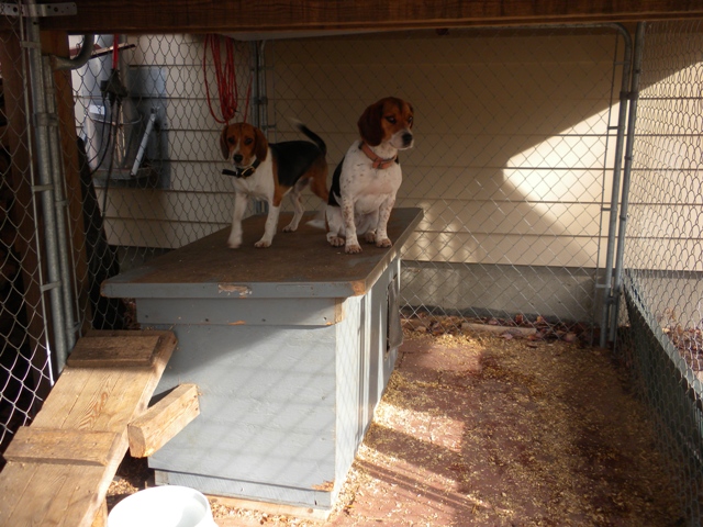

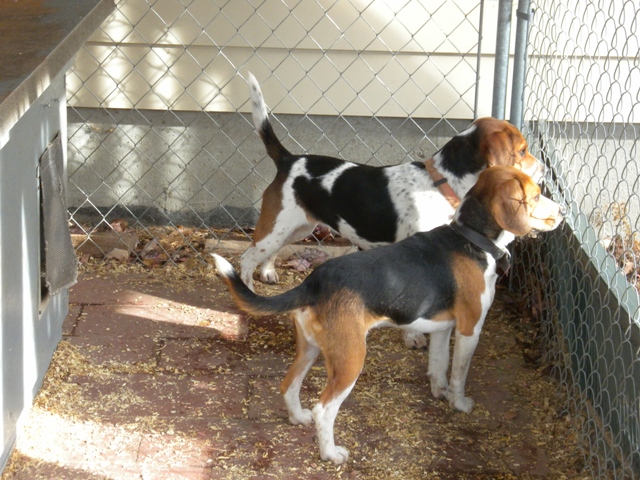

I don't know what part of NE you are in but I have a great situation with my hounds (short hair also)....Going on three years now...
I have an insulated heated doghouse with a hinged commercial door used as a roof/cover......2' x 4'.....
This heater makes it work great....... http://www.gundogsupply.com/hound-heater-dog-house-furnace.html ....with a remote thermometer installed inside the doghouse (the type with a battery that you can read inside the house up to a few hundred feet away) and a heated water bowl (110 vac) purchased from Cabela's.....Cabela's: Heated Water Bowl
Any time of day (or night) I can monitor the temp inside the doghouse without waking them up just by using this system ......
I did change the bedding from hay/straw to pine/cedar chips just because of the potential for fire with a strand of hay or straw getting in the heater mechanism.......Also I added a rubber flap door for ease of entry/exit for the dogs...
Between the heater/thermostat/water bowl and a clean, dry, secure place this pen works great for my two hounds......even in the worst case of cold & snow my furbuddies are safe and sound......
Many times I've checked on them in the middle of the night for peace of mind that they are not freezing in the doghouse......the thermostat is set for 50-55 degrees and it never gets any colder than that.....Even in subzero temps...
Some times I show off the dog pen and some people say "Wow, that's a nice setup ".......
I probably bring them in the house overnight a couple of times a month usually during rainy/raw times to dry out and get spoiled......:D

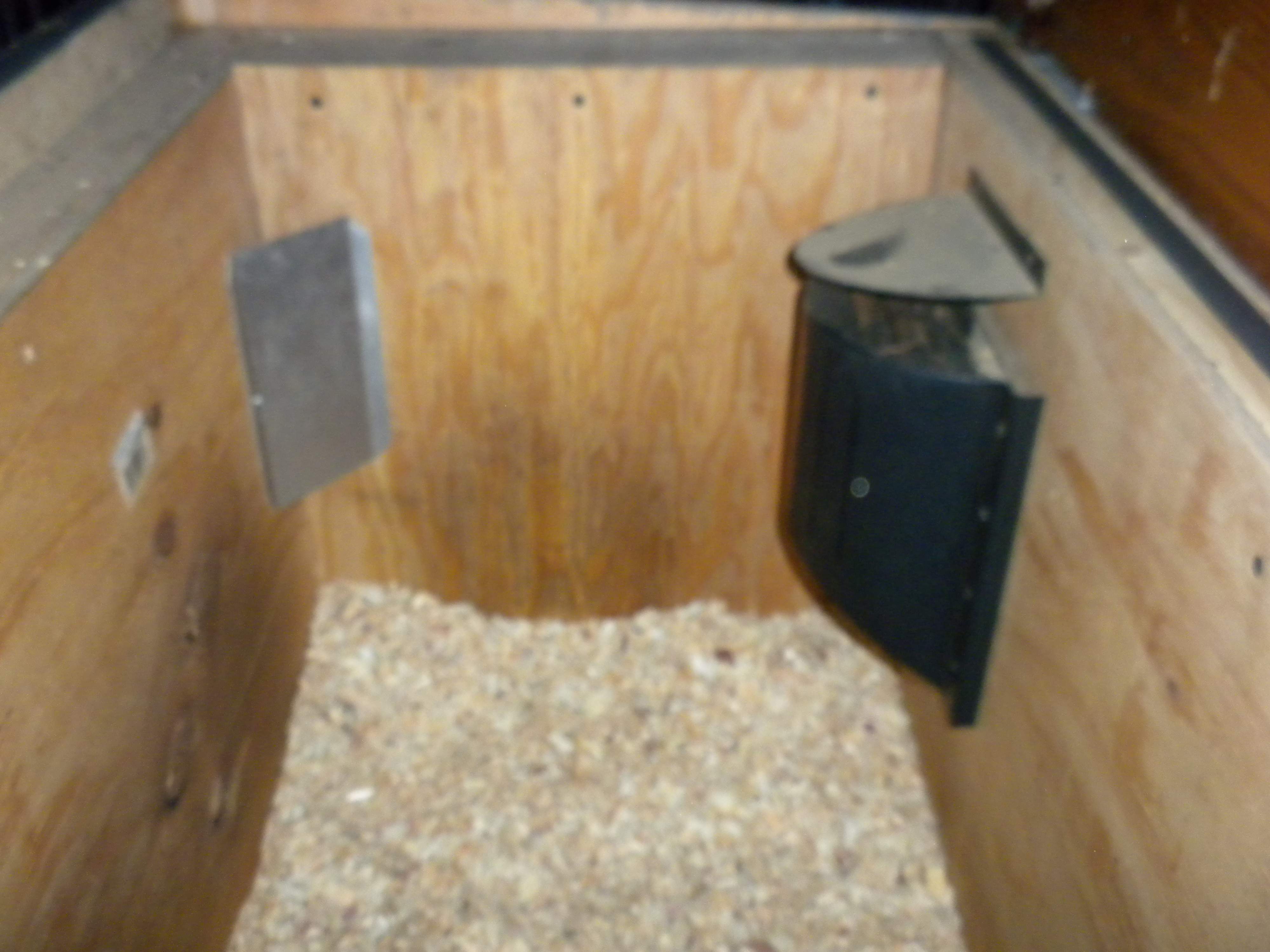

Chopped,
Here's a pic of the inside of the heated doggy condo........the hound heater is on the right and the thermometer is just inside the sheet metal cover on the left....
The wood shavings are about 4-5 inches thick.......
